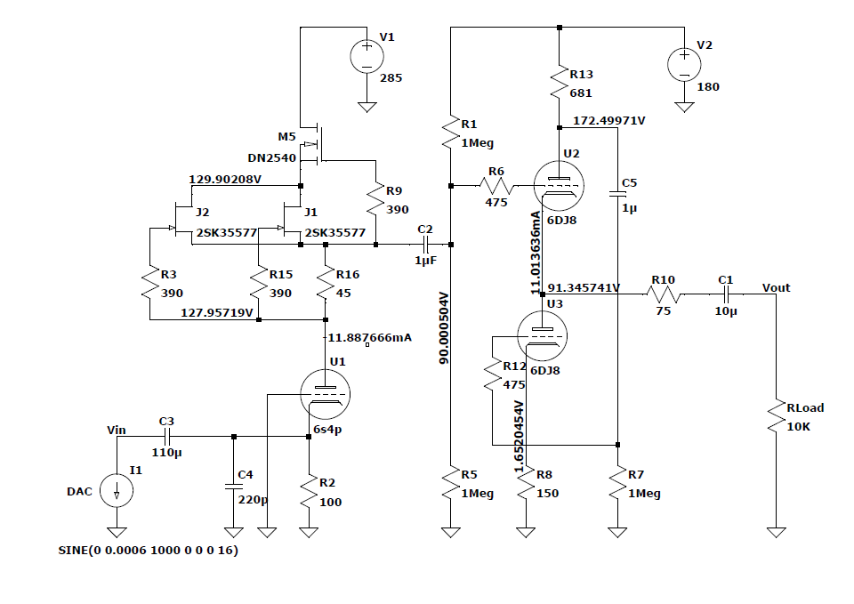

For current DAC I use this scheme, the first tube is I / V conversion with gain of 40, the next stage is white cathode folower.
The output voltage is around 6Vpp with an input current of +/- 1.2mA (PCM1702), for the TDA1541 it will be slightly higher, 18Vpp, which is quite enough to drive any amplifier.
An ordinary cathode folower can be used instead of a WCF.

This is a output stage for TDA1541A with ECC83 as amplifying tube and 5687 tube as buffer.
Amplifing tube as most sensitive part is set to most linear region. And high anode voltage because tube is voltage device not current... Operating points are chosen not to exceed maximal values given by datas. It is posibile to use battery in kathode bias for ECC83 tube.
Citcuit showing extremly low distortion, and have excellent phase at the ends of the bandwidth. I will check sleave rate and other parameters.
For the buffer I will check some mere configurations and afordable tubes
I avoided ECC88 tube as low voltage (max 130V anode voltage) and open anode internala construction.
This circuit does not have additional filtering or compensation circuits. That could be optionally added.
I will post Zanden style passive notch filter network later for optional?
