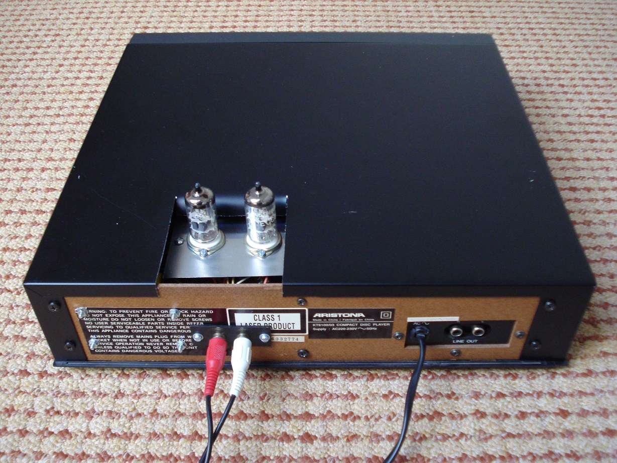

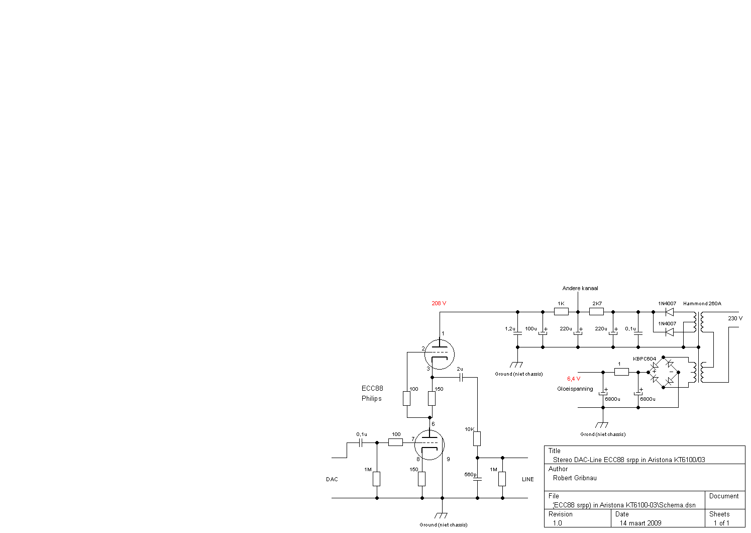

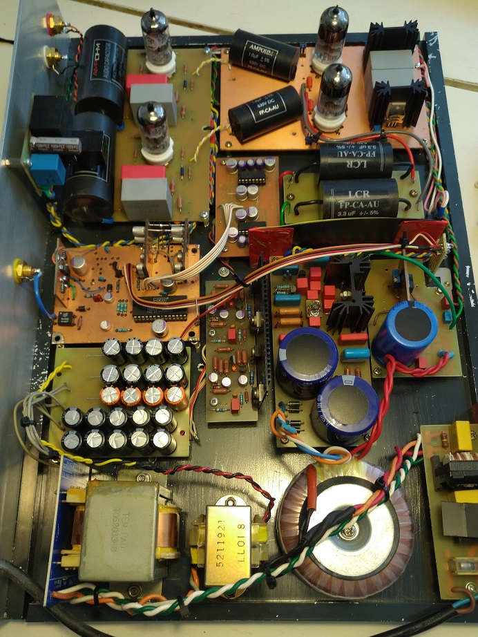

I have been working on DACs for almost 15 years, I used various schemes with tubes, I rejected the OP-amp at the beginning, although I inserted the AD811 into the old player as an I / V stage.
A couple of years ago I tried a grounded grid with 6S4P and that’s when I realized I had lived in delusion all the years before.https://www.diyaudio.com/forums/tubes-valves/360960-help-tube-iv-3.html#post6363513
The sound has changed drastically, it has gained that liveliness and reality that is hard to hear from a digital source.
The disadvantage of this scheme is that it needs a capacitor between the output from the DAC chip and the tube.
I haven't tried the transformer as an output stage, but I can say that the tubes are great for the I / V stage, but only if they are applied well.
There are a lot of schemes on the internet that are a complete failure so one should carefully choose and calculate for a particular DAC chip.
