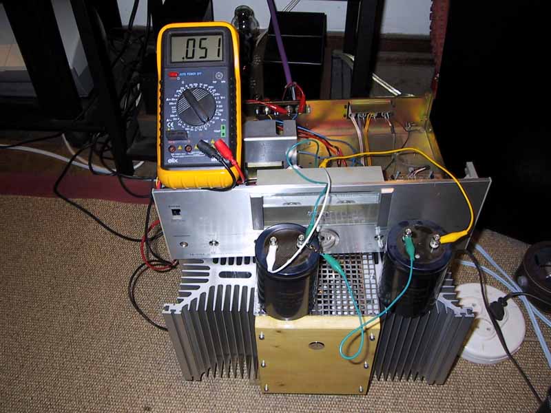

the initial hum is about 400mV on the right side and 60mv on the left side.
after 5 mins the right hum stabilizes to 50mV on the right ch and 30mV on the other ch.
even with the big cans the hum doesnt disapear,
and when you blow air to the board the hum rises up to 200mV!

So I believe that psu caps might be ok. I'll try to blow directly into each cap to see the hum risin' up

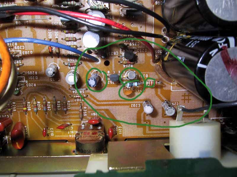

Mrfeedback
I allready replaced the grey medium cap near R302, but the glue might be it.
Just let me tell you what I found out.
In the next picture I marked with a circle the spot where when I blow my own air with a tube, the hum increases. I suspect that is related with moisture also.
I replaced meanwhile the marked components and no big effect on the hum.
My next step will be to remove the big caps, remove the glue and clean the board.
I'll try then to see if anything changes.
(I think that with the help of you guys I might do it 😉)

The good new is that I manage to remove the hum totally with the gule removal and couple of small caps substitution.
The BAD news is that when I was ready to close the box, I acidentaly shorted something, a flare apeared, and...
...I blew out the left channel 🙁
The hole amp makes a terrible hum on both channel, but if I disconnect the juice from the left channel, I get good quality sound with a minor hum. I Feel so stupid!!!
