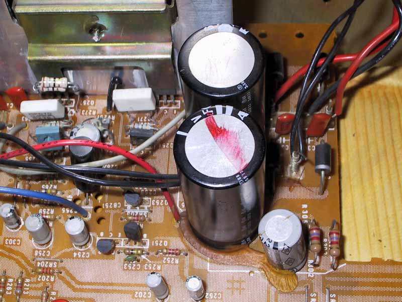

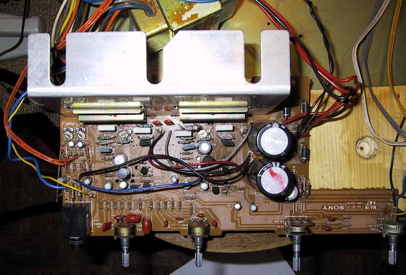

I measured the current at the power resistor and it was 100mA.
I lowered it to 30mA and now the sink don't burn anymore.(thanks, Jan 😉)
But the hum didn't totaly disapeared and still is larger on one channel that the other.
I also noticed that on turn on, when heating up, the noise was much bigger, and then lowered.
Could it be possible to be a potenciometer problem? (just guessing)

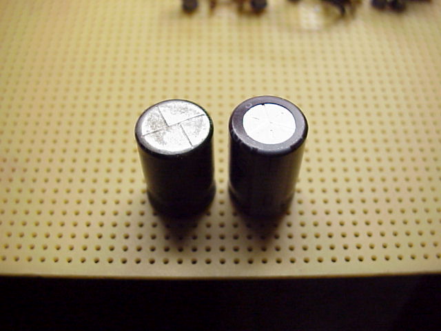

As you tell us that the hum is louder at startup, i'm almost sure it's one or more caps (electrolytic). Usually, when worn-out caps are cold they have almost no capacity anymore. When they warm up the capacity comes back a little and the hum disappears a bit.
Here a pic (left) from a bad cap(heat) and (right) a new one😱

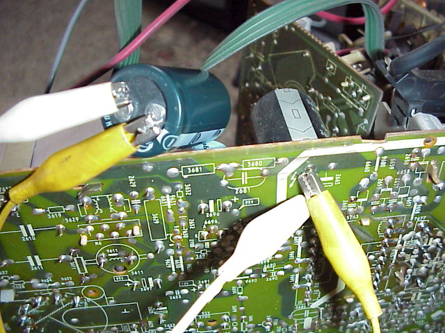

On the PSU caps, if you have similar caps lying around, you can always try to parallel one and listen to the difference. See pic. But be careful, these are the main rails. As i recall, look for worn-out caps like the one on the picture in previous post. They can be tricky. If you have a cap-meter, things are easier, take them out and measure them. (discharge them big ones before measuring!)If you have a scope you can measure the ripple, but i wouldn’t by a scope just for that😉

A bit higher in value is ok, but don't replace the 220µF with 150.000µF. You woudnt have the place for it anyway
By the way, you have some pics?🙂
