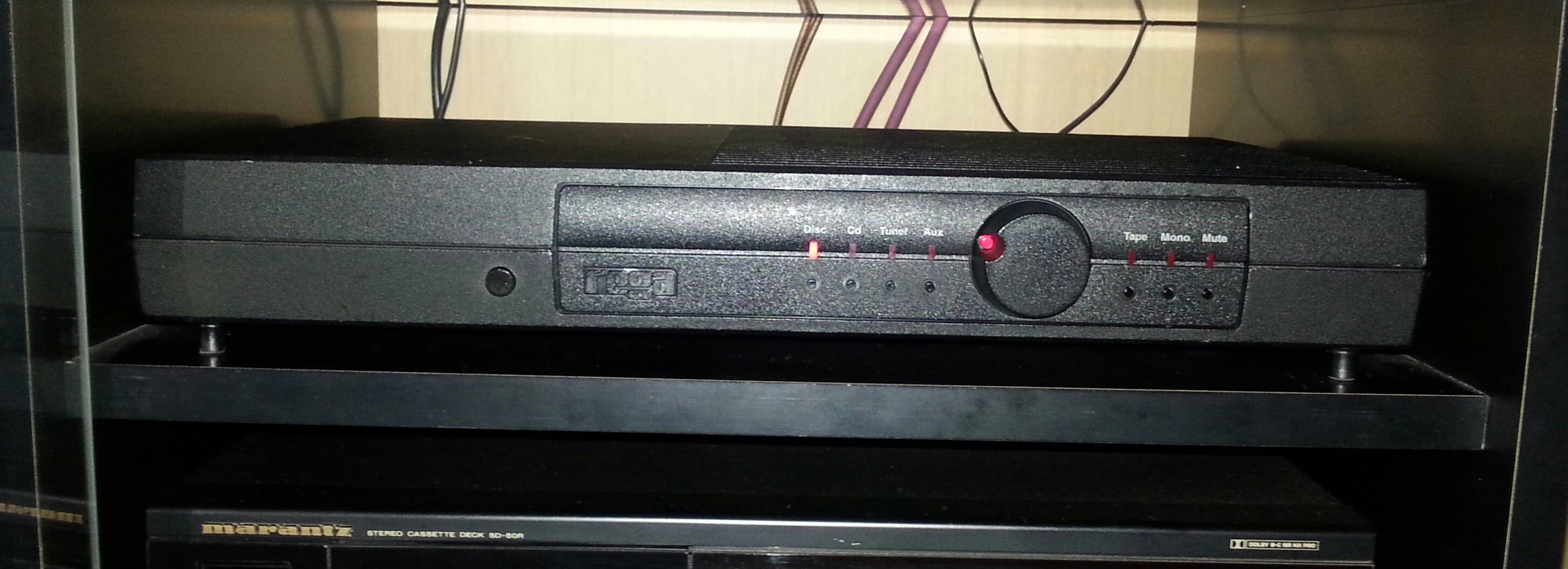

Help on Rega Elicit MKI

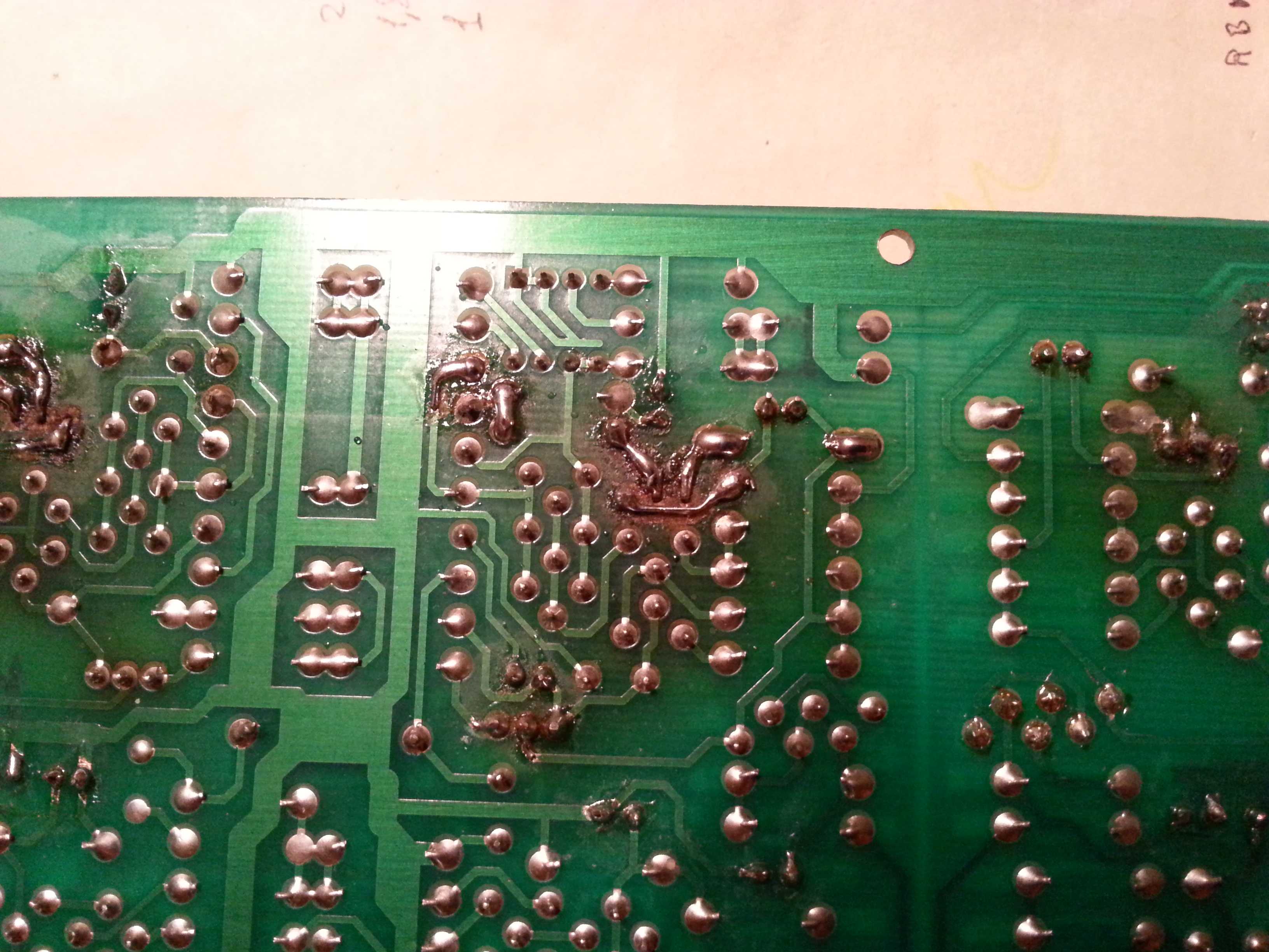

Olé !!!
Solved !!! 😉 🙂 😀

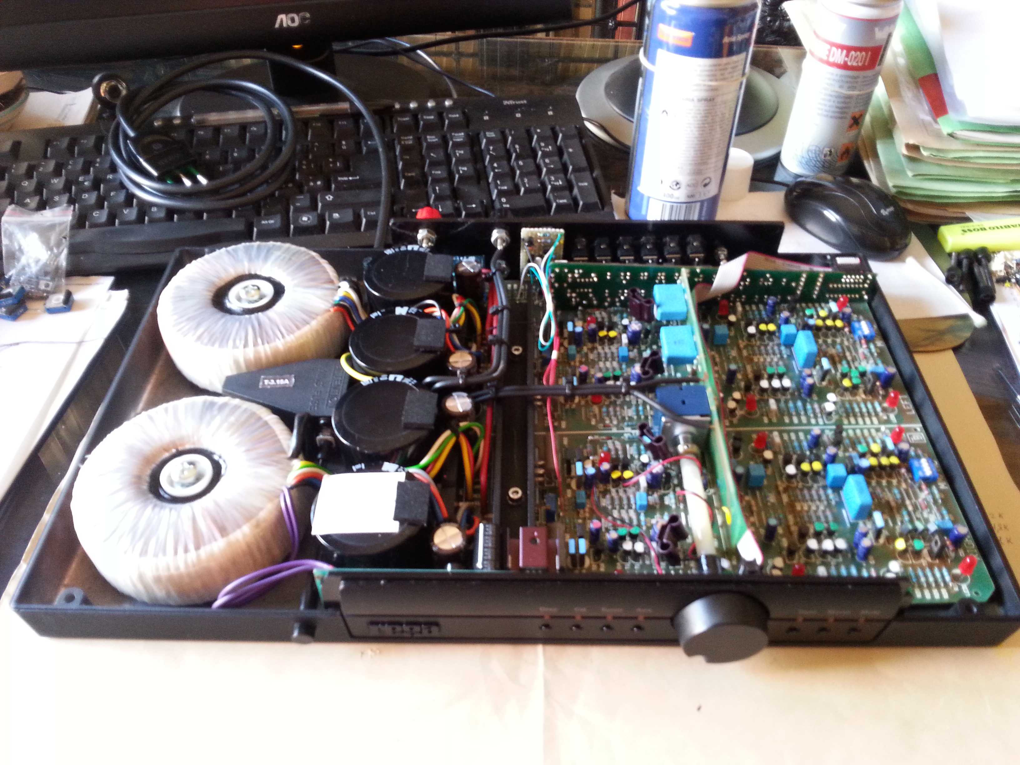

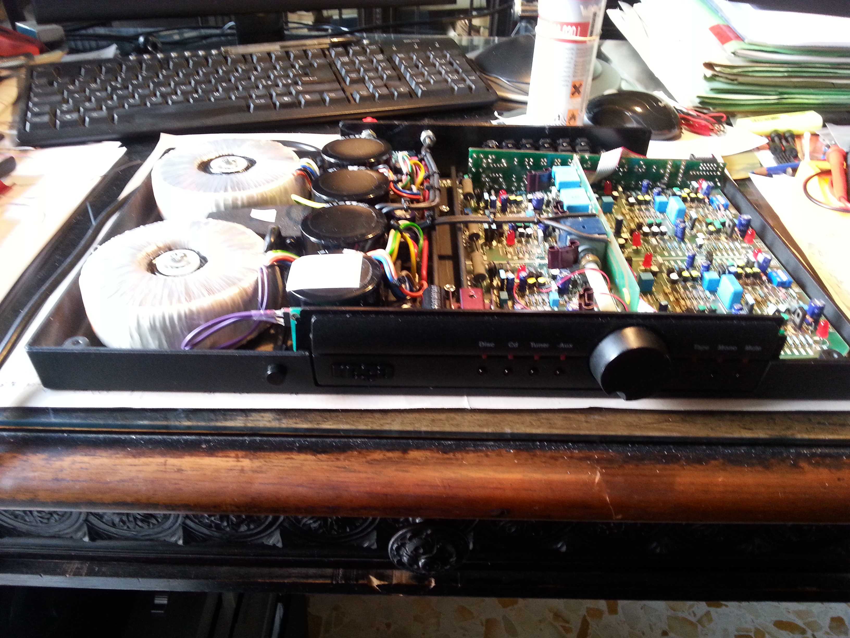

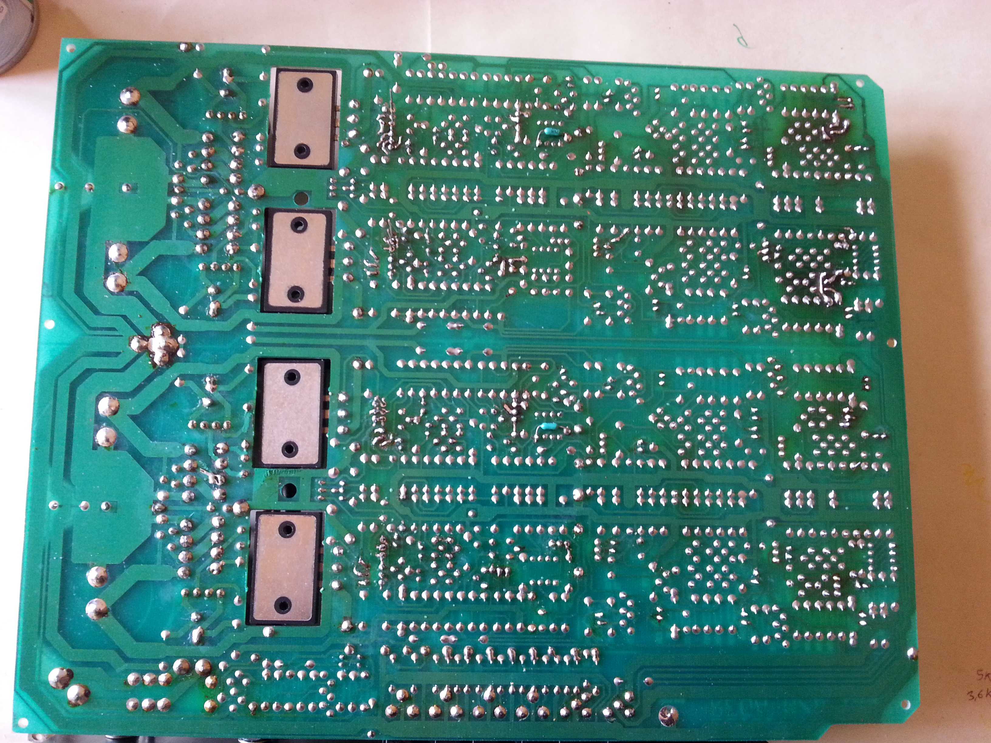

It was a bad soldering under a BD139 on right phono stage.
Now it work great. I love Rega amps; I hate Rega Mainboards !!! 😡
Now the bias current in on 18mv set (for each emitter resistor); later I will set it, step by step, until 35mv.

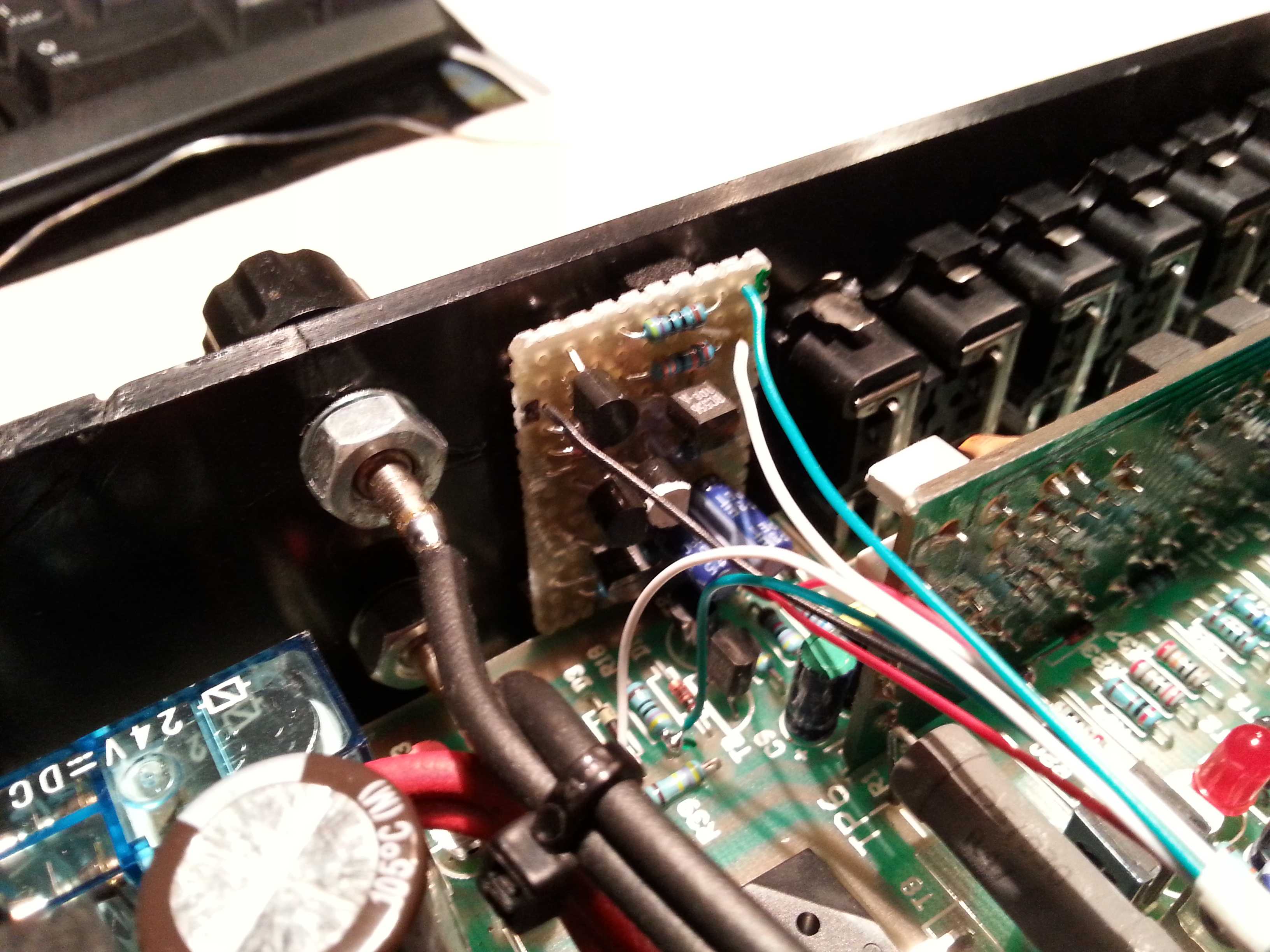

I add also a DC protection circuit.
I post some photo.
Thank You for the support !!!

Great 🙂 If you haven't already done this, don't forget to clean your PCB of the flux and debris with isopropyl alcohol, rubbing alcohol or similar. Then inspect again, when you can see better, whether the repair soldering was good or maybe still suspect, even if the amplifier is now working perfectly. You won't like having to pull it apart again in a week, a month or a year to fix another breakdown, so make sure now and also prevent corrosion by removing excess flux.
Ja, this is a great satisfaction !!!
Another little tip: the speakers relay is very dirty after 20 years. Sometimes the one or the other channel come and go !!!
Replace or clean the speakers relay.
For cleaning: make an hole with bit drill of 1mm, spray compressed air first, then a good contacts cleaner. Finally close the hole with some adhesive.
That's.
Goodbye to everyone. Thank You very much for the precious help.

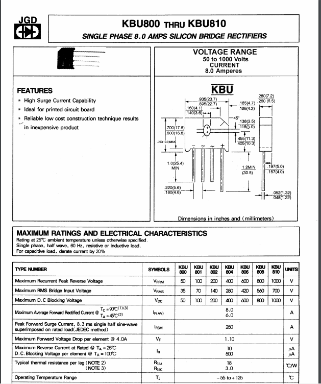

Thank you for the reply.
Oh, yes, it's very impotant for me.
I replaced it with a similar MIC (...and TAIWAN SEMICONDUCTOR also), but I can hear the difference (sound less detailed but warmer and more realistic whit that).
That kbu804, whit that LOGO, is mounted on all old clamshell Rega models (Brio mk1, Elex mk1, Elicit mk1), but I really can not find it !!!
