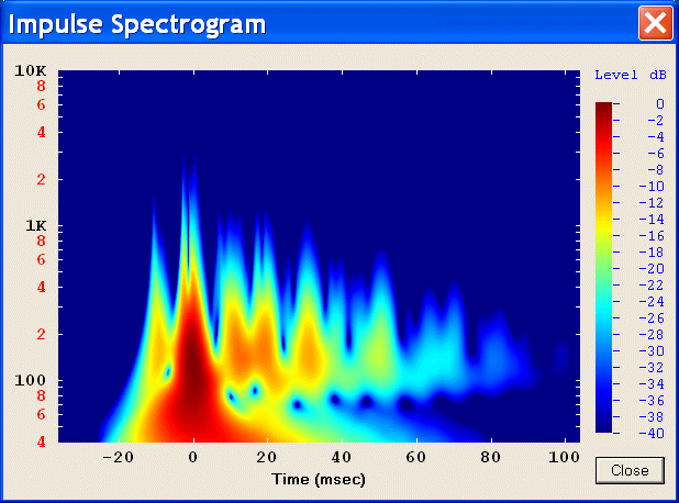

Hello,
The spectrogram in Hornresp has been improved.
The new calculation runs faster and the quality of the spectrogram is much better due to the use of a new Fourier window equivalent to a gaussian window.
See David McBean's message:
http://www.diyaudio.com/forums/subwoofers/119854-hornresp-128.html#post2223790
A test spectrogram is attached to this message
Best regards from Paris, France

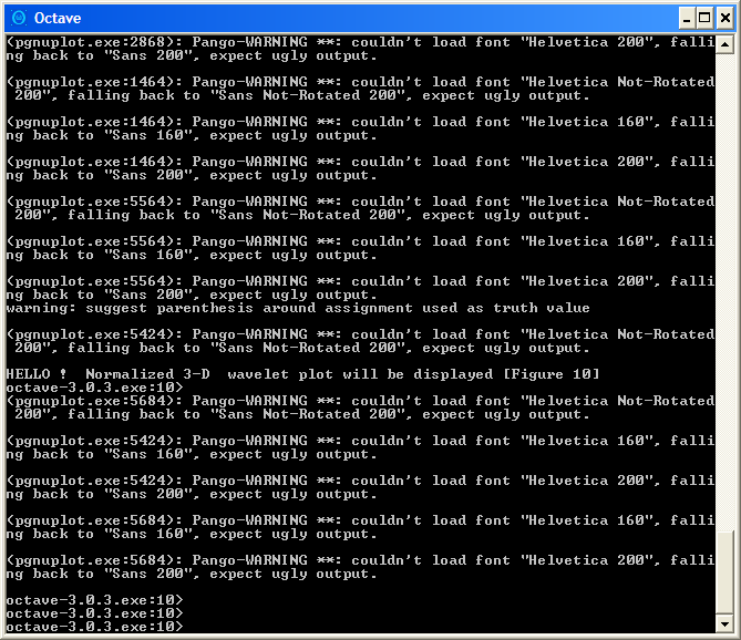

Hello Michael,
I ran 1.7 packet. Good news and bad news :D
First, I use Octave 3.0.3. And I don't have Xoctave, just the command line interface :D
Here is some observations I came across:
1) start_wavelet.m encounters error. This is due to clf() function, as it assumes zero input arguments, but in code there is number argument given. There is no need to enter a argument, as clf() is used after the figure() and it points to that specific figure alone. This is a backwards compatibility issue. After I removed the argument from clf() I had succesful run :)
2) Default fonts. My system cannot find the correct font (this problem I've allways had with various Windows machines). I overcome this by entering the command set(0, 'defaulttextfontname', '*'); Whitout this output looks messy (see pic).
3) Suggestion: We really need to improve the UI. NO manual writing of the IR file name, please :). Maybe we can work over this one, I have some ideas.
4) IR file names. It is possible to have any type of file name with white spaces and special characters. Any file name good for Windows is good for Octave. Use '' or "" around the filename.
5) 3D plotting. In my multiresolution wavelet I use downsampling along the time axis (parameter Nds) and it works well with that particular wavelet type. But it does not work for constant Q type of wavelets (JMLC, LeWalle). In my experiments with constant Q wavelet I need to upsample time axis to get meaningfull 3D plot. This is because at the top end of the freq scale time amplitude variations happen in a very fine time grid. Upsampling can be done by interpolation, but overall I would investigate more how to present constant Q types of plots in 3D, or not at all.
6) Suggestion: Better to close all figures in the start of a new run, otherwise they can be confusing if a different wavelet type is chosen. Also it seems to speed up the run a bit. Function close all;
7) Titles in the figures. If title of the figure has special characters it did not display properly. For example ir_file.wav displays letter f in lower case font. Use title('your title of the plot', 'interpreter', 'none'); to overcome this.
8) In LeWalle constant Q wavelet top octave above 10kHz seems to have some sort of artefacts. Antialiasing problems or something? Is there any solutions?
Other than that it works very well, and produces beautiful wavelet plots one can let his eyes to rest and dream about the marvels of the world :D
- Elias
1.) fixed
2.) fixed
3.) graphic UI would be „nice to have“ - sure - but how to to ? Didn't have great luck with commands to bring up the file system GUI. (I checked it out some time back - maybe it improved meantime?)
and on the other hand QtOctave and Xoctave are „quasi-GUI“ for win / Linux users
4.) fixed
5.) I'm awaiting your suggestions :D
6.) fixed
7.) fixed
8.) have to have a closer look into that, eventually...
Maybe better to rename this type of plot to wavelet CSD or something.
9.) fixed

Hi!
Tested 1.8.
Issue 2) remains.
Correction: moved command set(0, 'defaulttextfontname', '*'); to the beginning of the start_wavelet.m file (after command clear; ). This command must be before any text/numbers are printed to a figure.
After that No Problem! Runs smooth :)
- Elias
1.) fixed
2.) fixed
4.) fixed
6.) fixed
7.) fixed
9.) fixed
