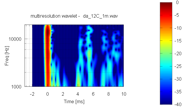

When working towards multi-resolution feature I found a "bug" that is not so obvious when only using the normalized plots of the DIY WTF package (hence I have seen it so late).
A closer inspection of the *un-normalized* plots did show however that the Lewalle code performs different.
My guess is that Jaques Lewalle was aiming for a certain look of the wavelet that is not necessarily a liner representation of the time frequency behaviour we are after.
Anyway – I already found part of what's the roots, but certainly could need some input / help to make it perfect.
Elias, your artificial IR file containing subsequent impulses is ideal to check out the package behaviour. Again thanks for that !
Below is what we get from version 1.0 (non - normalized) :
And here is what we get form latest version 1.1 (non - normalized) :
We see in the plot above, that the non-linear frequency response is now corrected in version 1.1, but there is still an issue in that the time versus frequency resolution isn't constant over the frequency range.
Meaning – for a certain wavelet scaling I get different resolution depending on frequency.
It is easily seen that around 1kHz there is mainly frequency preference resolution where as higher up there is time preference resolution.
IMO this is written somewhere in the "lewa_mymorlet" code here – but I didn't got around it yet:

The part that looks interesting for me is this one where the wavlet variable comes into play:
Code:
z0 = wtf_scale;												% variable for time / frequency trade off
    for is=1:ns
  	for ii=1:n
  		z=ff(ii)/kf(is);
  		morh(ii)= z0/kf(is)/sq2pi * (exp(-(z0^2*(1-z)^2)/2) - exp(-z0^2*(1+z^2)/2) );
											      				% morh(ii) = morh(ii) * kf(is)/sqrt(cps) ;% my scaling
    	endfor
    	for ii=1:n ;
    		yh(ii) = xh(ii)*morh(ii);
    	endfor
    	ycmor(is,:) = ifft(yh); 										% the complex inverse transform
  end
My half educated guess is that the wavelet isn't shifted / adapted with frequency or something the like ???
Full package in version 1.1 with multi-resolution feature available for download under :
http://www.kinotechnik.edis.at/pages/diyaudio/wavelet/mige0_start_wavelet_ver_1_1.zip
Any help highly welcome !
Michael
I suspect this is to do with the purpose Lewalle wrote his wavelet as it may not be for analysing impulse response in the first place. That is, if you analyse impulse response you like to generate wavelets with constant amplitude. However, if you like to analyse time-frequency distribution of a 'physics' signal, then you like to normalise the energy of the wavelet transform and your frequency domain amplitude of the wavelet is no longer constant. This is because a long wavelet in time domain has more energy than a short one. Without knowing his purposes, this is what I think. And I have come accross this in my own analyses (other than impulse responses) as well.
The time-frequency resolution is not a bug. It's a property of the selected wavelet :) As the frequency get's lower (wavelength getting longer), wavelets start to overlap the reflections. Let's say if you use a wavelet having length of one wavelength, then at 1kHz the wavelets starts to overlap with 1ms reflections.
Then of course, one can ask a question if it's feasible to analyse signals with time duration shorter than a wavelength at a particular frequency? :)
Reassignment can help here and increase the virtual temporal resolution, but doesn't remove this property :)
- Elias

Mickael, your IR file works fine
Below is what I got with your IR file:
– could you please select "DEBUG MODE" in the first menu and then post a screenshot of the console here, so that we can see at which point you got stuck ?
Also you can try the Lewalle analysis and tell us if those work or crash as well.
Most probably its simply because of what I outlined here:

Elias, could you please post the code of the "pcolor.m" version you got the tics on y-axis with or - even better - from which GNU plot version it actually is?
Michael
GNU Plot version is 4.3. It came with the Octave 3.0.3 installation package. It's old and I've been using it more than a year and never find any reason to update since no bugs :)
This is the direct link to the 3.0.3 package
ftp://ftp.gnu.org/pub/gnu/octave/octave-3.0.3.tar.gz
- Elias
Michael
You can also try different grid commands.
For example for my version if I use grid ('on'); I get this:
168991d1272446831-help-making-multiresolution-wavelet-analysis-available-wavelet_grid-.png
and if I use grid ('minor'); I get this:
168992d1272446831-help-making-multiresolution-wavelet-analysis-available-wavelet_grid-minor.png
- Elias
