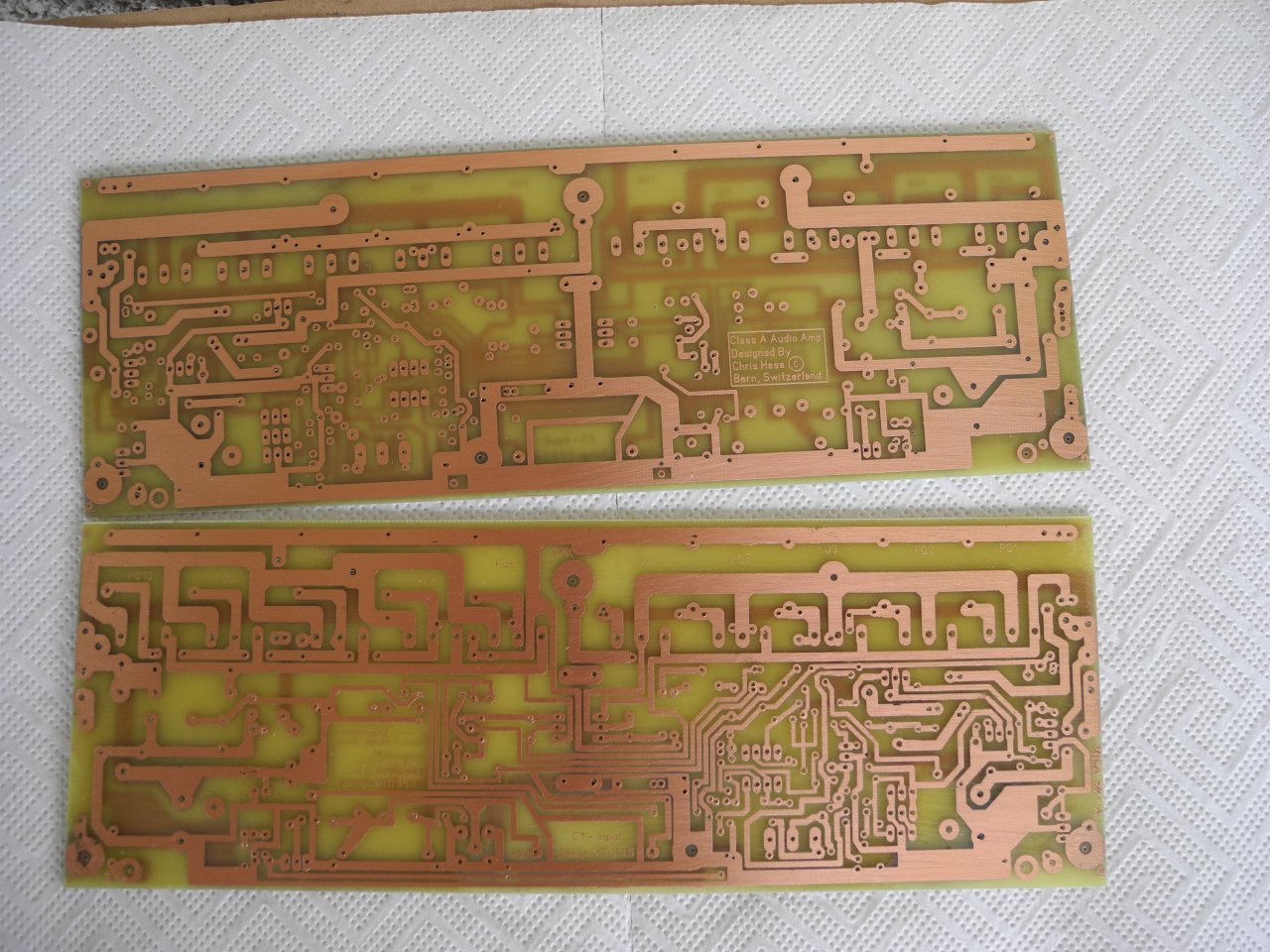

it's ridicoulous that after 40 years of manufacturing PCB's I don't get the point what is going wrong with my manufacturing PCB..
I use Bunggard 35um PCB. Fotopositive.
Later days I use Tracing paper as Film as well as Laser Film. Both were working good. but lately problems occured I never thought of it..
I get bad results when etching the PCB with Ferro Chlorid 3.
Instead of edging the exposed sequences of the PCB it eats up the Laqeur of the portion which should be the tracks,,
I ordered about 20 Plates PCB with size of 10cm * 16cm. The half of it I had to throw away because at edging all of them were useless..
I use the same Printer, The same Glasses, the same Ultraviolet lamps, exactly the correct exposure timing. and and and and
I always use new devloper, same Edging solution measured by weight. mixed by weight to a 10th of a gramm exact.
And still got to many failures..
and it doesn't matter if I use Film or Tracing Paper.. Finally I think that I got old PCB material from that Store I buy these.
I always measure developer Temp very exaclty 20degrees Celsious.
14 Days ago I again got failing PCB,s so I changend the Edging ACID to Natriumpersulfat. I almost died because the Air vent Failed and to this day I'm feeling sick, lost my short time memory to a big degree, sometims walking around like drunk. and if I sit down or lay down everything is turning like o a carusel. And I do not drink or smoke nor smoinkg pot.. nor taking drugs.. just 5 minutes of this poisoned air of this NATRIUMPERSULFAT almost make me to a usless Person.
And I can't take off from work, because there is nobody to do my work.. But this aint a problem.. but the bad PCB's is a big problem I can not finish my testing with such boards.
Show you a good one and the ones with very strange structure..
What makes it more strange, it kill the BIG TRACKS not the small ones.. LOL
Check out the pics please..
May some of you have seen something like that before..
Let me know if you think you know the reason..
Thanks MANY Thanks..

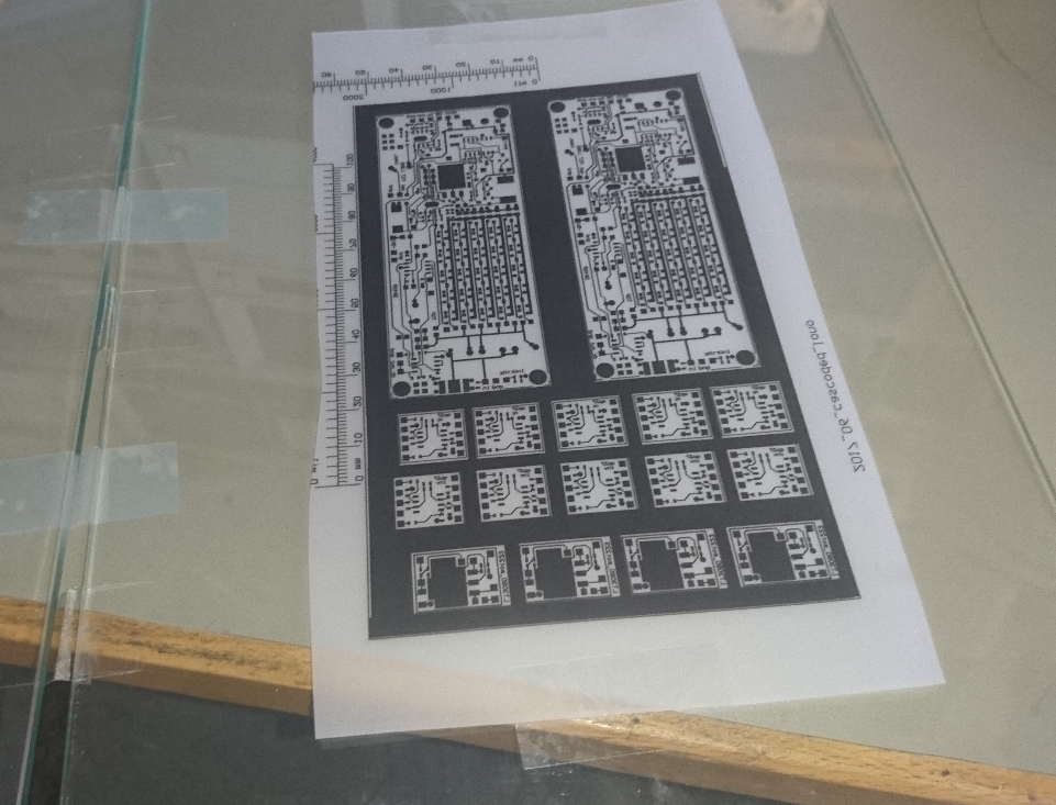

I see various problems.
In no particular order:
1) you have *contact* problems.
The artwork sheet is not firmly pressed against the photoemulsion and light enters through the borders into areas which "should" be covered, this is specially noticeable at the edges because it´s always hard to keep uniform pressure there.
On top and bottom edges and partly onnthe left one, you not only lost fine tracks and text but even chunks of large flat areas.
2) your toner is not black enough.
The very same laser printer which worked fine months ago either is near the end of its toner cartridge (which can be solved by getting a new original one, no refills or recycled ones for PCB artwork, sorry) or the photosensitive image drum inside the printer is getting old.
I recently replaced my faithful workhorse Lexmark Optra + which had been used *exclusively* for PCB and silkscreen (front panels and PCBs) for over 10 years (It was still in "as new" condition) because of that.
I bought a new cheap Samsung printer, it prints carbon black thick toner, I suggest you get one too.
3) even so, toner being a "dust" type "ink" by definition can and will have micropores and pinholes here and there, your old printer simply has thousands of them all over the place, because although black plastic (toner) particles partly melt so as to stick to paper, they never become a real liquid, so one molten grain may not fully join its neighbour, leaving a micro hole in between.
4) there is a "toner blackener" spray can, ask about it at Graphics supply shops, Printers have the same problem as us and use it to improve quality, it contains a little solvent which partially melts toner, en result is blacker because it covers better.
Don´t use too much because it can make a mess.
5) IF you use Vellum (tracing paper) put toner side in direct contact with photoemulsion, I do that when burning silkscreens.
PRO exposure machines use vacuum to ensure perfect contact.
If you just use a piece of glass and its own weight, good contact is NOT assured.
6) or forget Vellum , print 2 crystal clear transparencies on polyester film, align and tape them,you will be surprised at blackness achieved, and use them instead.
7) if you are using a bed of many UV tubes, that´s diffused light, easy to go where you don´t want it, try to use single UV lamp (point source) some 60cm above the exposed board, you will have much cleaned edges.
8) just in case, show a picture of your exposure setup.
9) you *might* have a batch of older PCB material , try etching *unexposed* - half exposed and fully exposed material so as to put artwork out of the way.
Even better, use guaranteed opaque material (such as a coin) on the partly and fully exposed bits and see what happens.

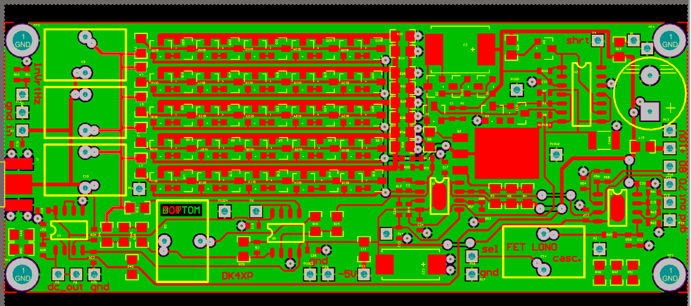

I print the circuit on "Avery-Zweckform-Folie zu Erstellung von Photoformat-
Vorlagen" on a Kyocera color laser printer. The OKI I had before was better.
The foil is somewhat milky with a non glaring surface. That's no drawback
because the toner is in direct contact to the photo layer.
If it really counts, like for microwave filters, I go to the next print shop
and have them make me an offset film on their Agfatronik or Linotype with
true 2400 dpi. Then black is absolutely black, and translucent really translucent.
It usually costs 5-10€ into their coffee box for DIN/ISO A4 oversize.
They accept normal .pdf 1:1. You can make a check plot on your printer.
I must print it 4% larger on the Kyocera, so an Euro card is really 100*160mm.
Board material is Bungard, I buy it at Segor.de because I know them from
my time in Berlin.

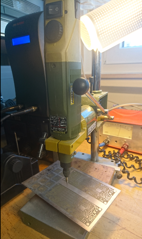

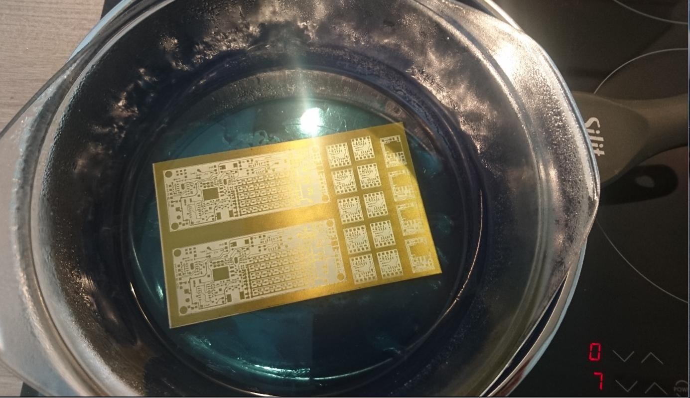

Etching is in persulfate, I now have an induction stove which
complicates things. I use an enameled Silit pan with some
water in it to get some energy from the field and a Pyrex
glass pot in it that contains the persulfate solution.
Drilling is on a Proxxon drill with hard metal bits at elevated RPM.
Please do wear goggles. Having the tip of a wolfram drill bit
in the eye is probably no fun.

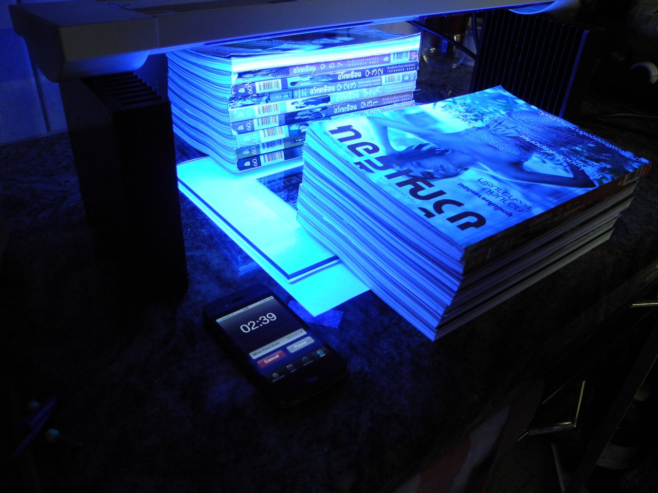

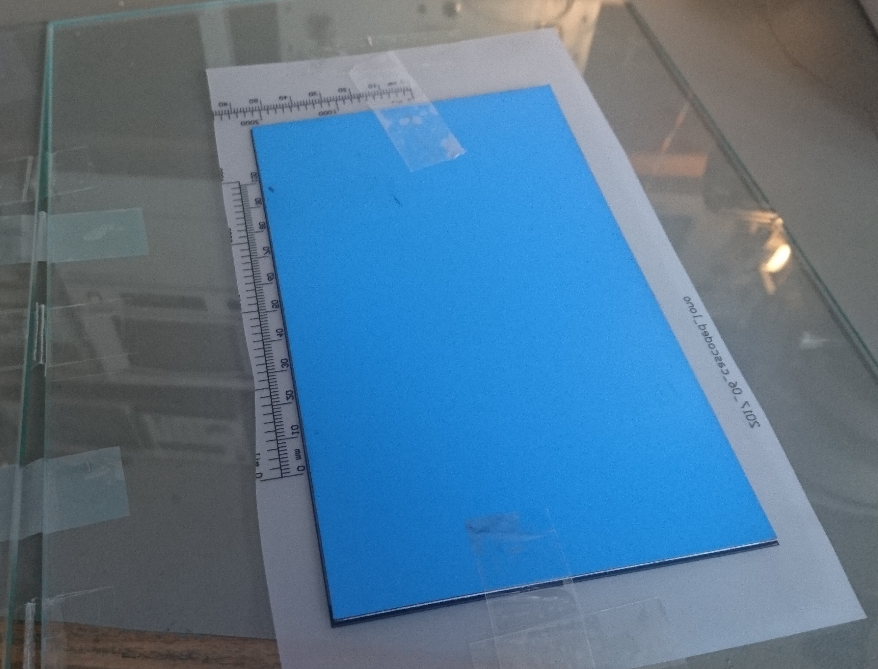

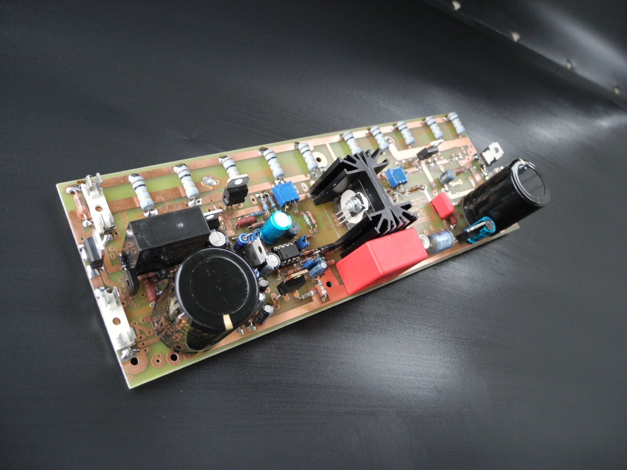

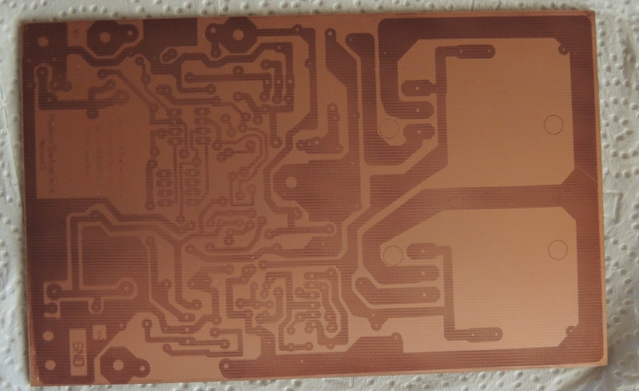

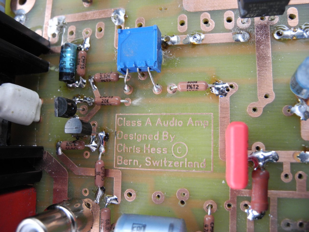

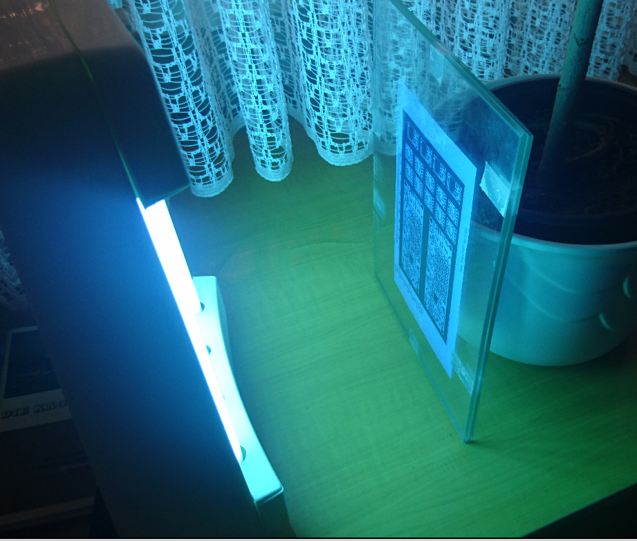

Here Exposure and more
1. Floor of the under Glass is a even Granit Stone Table 100% even and not bend.
PCB to get image is glued against it on a 5mm thick Glas Plate. Size A3
Cover Glas plate is 1mm thick and Pressure is 5KG per side. on the long sides.. Artwork lays with the Printed side agains the PCB--
2.Yes for The Toner.. It might be that one.. Its a OKI Printer, and the Printer screams to have the drum replaced-- It's ordered-.. will arrive next week.
3 & 4. OK but I did not use till today
5. I always put that Printed side onto the BOARD SIDE
6. have tried that before edges are not sharp, BTW it's a painstaking Work to align this so that every small piece is set straigt to the other.. and forget about if you make doublesided PCB.. Have Tried it-- Usually I make good boards.
7. I use 2 x18 Watts Philips Ultraviolet lamps laying besides each other in a Frame. Before I use them to expose the boards I let them warm for 10 minutes..
Distance to the Artwork is 15cm, I checked with a light scale that all the suare has the same lumination .. this is given +- 0.5% on the size of A3 Space. This boards are only not even A5.
8. Exposure setup is
a, Granit Table
b. 5mm thick clean and dust, oil and grease fress glass plate A3
c. PCB glued with thin duct tape against it on the back side.
d. Artwork covers the PCB and is fixed one side and then STRECHED to get waves out, and then fixed with duct tape again.
e. Top glass 1mm thick each side has a wheight of about 1.5 kg. this if all 4 sides are pressed equals 6 Kilos pressure on that Glas.
f. on the long side there is two Aluminum BLACK 16CM high HEATSINK which is the holder where the LAMP locks in on top of that. straight over the PCB
g. Exposure time for single side PCB with LASER FILM 90 Seconds with Transfer paper 180 seconds. this I test each time before I use the real one.
9. Good Idea, will do that.

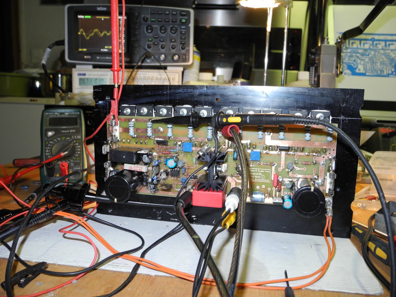

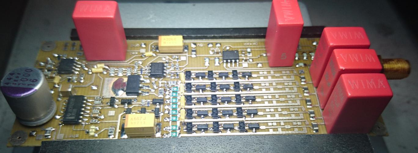

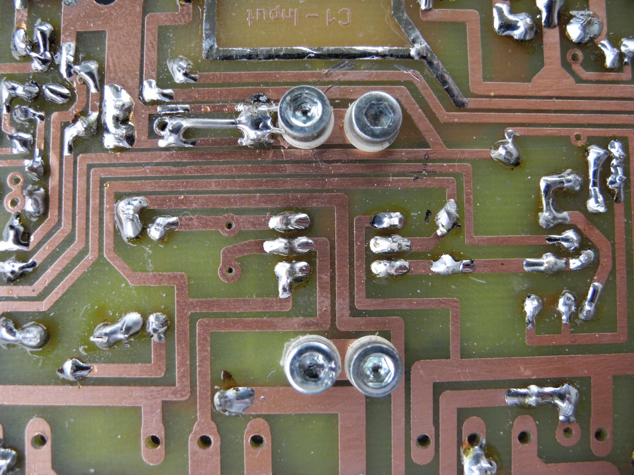

I show you how I made PCB 2013 and all of them came out just beautiful could win a contest. check out the pics and Laugh.
And Many Thanks.. because you give me the solution already with number 2.
Regards
Chris
I use Carbon drills these brake faster than Wolfram but don't fly around..

@JMFahey @Gerhard
I gave it another try. Controlled all I could..
Made that Film REAL BLACK Printed it two times with another LASER I HAVE - Talking about Tracing paper. I can make pictures for you.. but I'm fed up for today.. it's the PCB's which are old. not going to order again from that shop.. Gerhard know them for sure KONRAD..
Cleaned the Glas, Measured Temp on Developer as well as the weight. Extendet the Exposure time by 15 Seconds to 215 Seconds. and used on the long side of the BOARD per Side 6 KG Weights. the Artwork really sticked to it.. and? Just to understand that I don't even EDGED IT YET.. The tracks are a MESH I have never seen before but If I edge them then the same thing will happen.. Going to buy fotopositive spray so I dont need to throw away the pcb. and if it goes bad at that time. then I will take the blame..
Bad Quality and now I pull down the protection sheet of a brand new PCB not Exposed yet.. Forget it. Old Material.. So the rest I send them back ..
Believe me, this is not the first time that I making PCB.. but it's the first time that I had so many Failures.
Every second plate is bad..
Thanks for helping..
Regards Chris

New made PCB with Ultra Dark layout on tracing Paper
Can not resist, not to place these PCB's not etched yet
what you think happens if these boards see Etching ACID..
