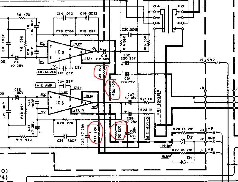

Mooly I noticed that those diodes are no longer available what would be your recommendation on replacements on them if I do find that they are no good? Thanks
An 18 or 19 volt zener of sufficient wattage would be ideal. 19 is an uncommon value. The voltage rating just sets the rail value to those IC's.
Wattage worse case is when no current is drawn from the rail such as when no opamps are fitted to the board.
43 volt input and an 18 volt zener means that 25 volts is to 'lost' across the series 1k resistor. Watts is V squared/R which is (25*25)/1000 giving 0.625 watts.
So you need a zener comfortably over that value.

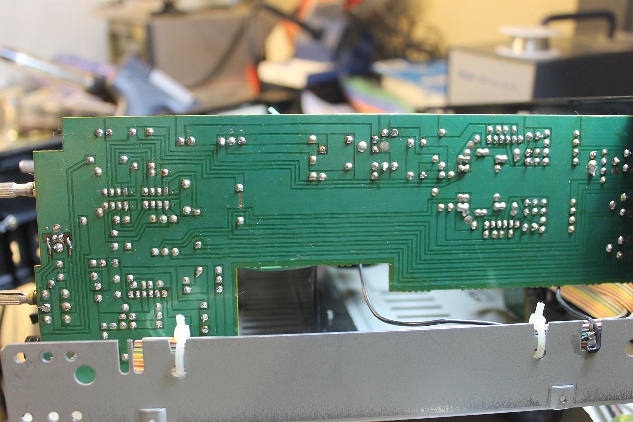

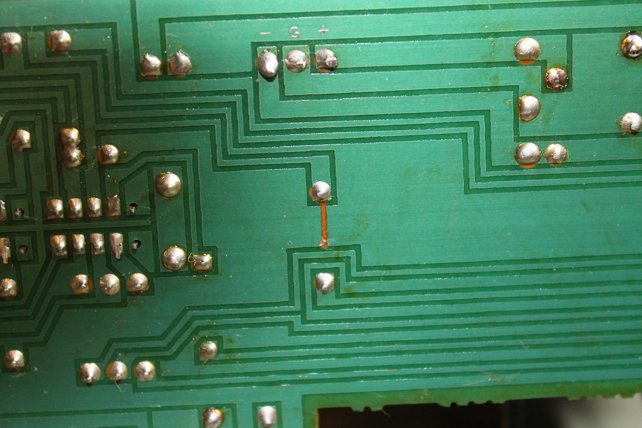

Mooly I am posting the Preamp board for you to look at! I have one spot that concerns me. Perhaps you can shed some light as to rather this is a factory open or some other tech's work on this amp and he cut it open. If so do I need a jumper?
I owe you an Apology Mooly. I wasn't reading the voltage correctly, which I think you kind of figured out anyways. So lets get the voltage correctly and maybe than you can actually make sense of whats going here.
So after realizing when I read the B+/- voltages there was a 42.5 v on both sides I realized that I was moving the decimal point when I read all the other voltages.
So from B+ across R-27 I had 37.5v across the Anode to Cathode I had 4.8v(I had the same voltage reversing my probes) after R-30 I was at +1.3v
rechecking IC-1 at Pin 8 I had +1.3 v at Pin 4 I had -2.3v,
From B- across R-28 I had+37.5v from the Anode to Cathode I had 5.5v(with the same reading reversing my probes) after R-29 I was at -2.3v
Rechecking IC-2 found my values pin 8 +1.3v pin 4 -2.3v
Rechecking IC-3 had me at Pin 8 +4.5v and pin 4 -5.5v. Guess the devils in the details as you had said in your opening details. So hope this helps out in setting me straight with which way to procede now!
Thanks again and sorry for the mistake(guess that why its called learning)

The cut in the print could be factory work, possibly to correct a ground loop issue that showed up in use. Its quite common to see things like that.
Voltages... you are measuring from ground for all these. That is J2 on that board.
If you can not measure +19 and -19 on the zeners then either the zeners are zapped or the IC's are pulling the voltage down.
Assuming you have not got the correct voltage then you can lift one end of R31 and R32 to isolate IC3. Does the voltage now come up on the zeners ?
If it does then IC3 is faulty.
If it doesn't then also isolate R29 and R30. That will remove the supply to IC1 and IC2.
If you now have voltage then one or both of those IC's is faulty. If no voltage then the zeners are faulty.
Look at the circuit... the method will make sense.

Alright Mooly we made some progress today. So I pulled both R-31 and 32 out of circuit and the voltage increased across the zener by a couple of volts. I went ahead and pulled R-29 and 30 out of circuit and bang we had 20v across the zener. Guess my brand new HA1457 were fake(sigh) people are such damn crooks these days. Anyways I pulled out !C-1,2,&3 replaced them back with the originals IC's reconnected all my Resistors back into ciruit and we had the correct voltages all the way accross the board. Pin 8 is reading between +19.1 and pin 4 is reading -19.3v. Now which direction should I procede? Thanks again Mooly.
🙂 that sounds more promising.
So what is the next fault on your list ? What is it not doing that it should ?
