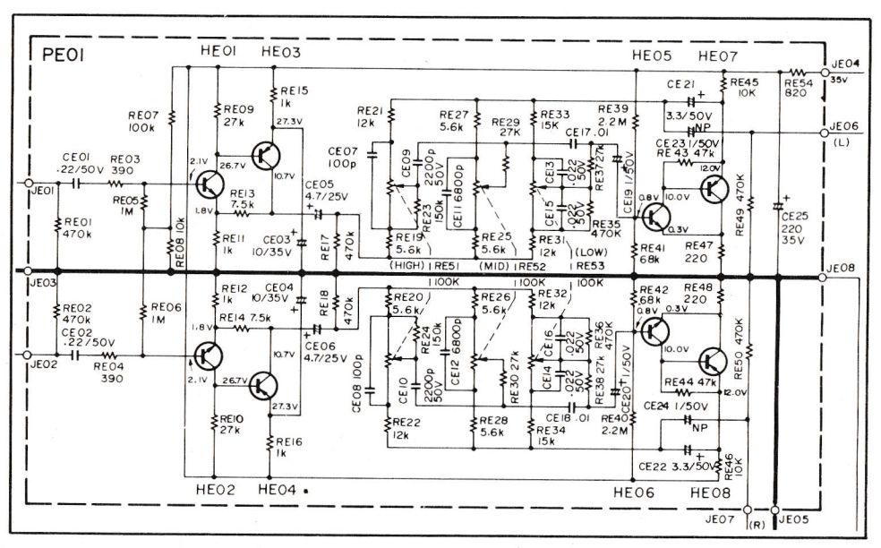

Hello, new member here. I am having trouble figuring out what is going on with this receiver I've been working on for awhile now.
It's not passing signal past the tone board's 1st transistor and voltages are off on the tone caps board, especially that first transistor. I've replaced the first transistors on both channels and no change really.
It has a sort of loud crackley distorted sound when the volume is turned up, but it is almost impossible to tell it's anything music related through the noisiness . It's only a in and out crackling output. I have recapped the power supply board, and everything was at their correct voltages on that board.
What could be the issue?

BEFORE you made any changes, did it work? I assume you have the service manual (available at HiFiengine for free).
What are the voltages on HE01,HE02,HE03 and HE04? Those are on the Tone Amplifier Assembly (PE01). Passive
components CAN change though rarely do but if the Voltages are wrong SOMETHING changed. I don't know your
skill level with a soldering tool so "shotgunning" the resistors and caps might make things worse. It's always better
figure it out from the symptoms as you learn troubleshooting skills and minimal potential damage.

In front of the tone amp: Volume and Balance pots, getting signal from TapeMonitor (& Mono) switch, from source selector switch (= PreOut). Check all of these.
Inputcap of tone circuit is a 0μ22/50 (CE01 & CE02), to replace.

Check all voltages on PE01 in accordance with scheme No. 4 fig2
Okay, so I've tested the voltages on the transistors and this is what they were
HE01: E-0 C-31.5v B-0
HE02: E-0 C-31.5v B-0
HE03: E-31.66v C-0 B-31.58v
HE04: E-31.66v C-0 B-31.58v
HE05: E-0.4v C-11.4v B-0.9v
HE06: E-0.4v C-11.1v B-0.9v
HE07: E-12.5v C-0.4v B-11.8v
HE08: E-11.4 C-0.4v B-11.1v

According to the manual, CE01 and CE02 are 0.22 uF 50V film caps. Do you really think those are a problem?
Over 40 years I've seen countless 'lytics go open, 1 or 2 short out, maybe 6 ceramics short out and not a single
film cap failure. Given we do not know how good he is with a soldering iron, it possibly does more harm than good
considering the film cap failure rate.

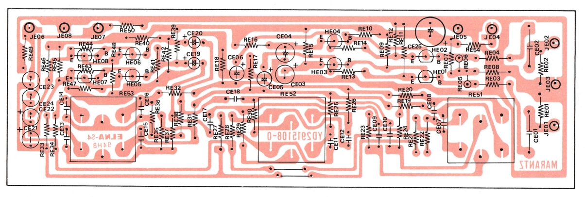

tracks but some of them were open. It would not take very long to "ohm out" all the traces connected to
the first 4 transistors. They are probably fine but when things get as weird as this, it's worth grasping at a
few straws.

I pulled HE03/04 and tested them and they both showed proper hfe and what not. The 01/02 both tested fine, but I had replacements for their type on hand and installed to see if they would work them to no avail.
I've been working on tube equipment for close to ten years so I can solder okay. I really don't like rebuilding traces on boards, but does that sound like the culprit?

PCB failures are very rare but NOT impossible. I was looking at the power levels on the resistors and it is so low
compared to the ratings that unless something acidic spilled on the board I would not expect any failures from
'burn out'. You have something weird going on that might benefit from an"out of the box" approach.

Okay, so good news is RE07 was blown and replacing it brought me back to having bias and now I am getting sound all the way through the reciever.
The sound I am getting through is distorted. Do I need to replace the transistors that ran without bias? Would they have been damaged enough to cause distortion?
