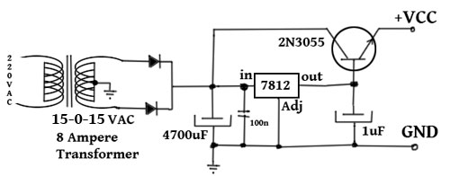

Dear all,
I need to build a 12 volt 7.5 amp regulated DC power supply for a project.
I have some 2N3055 transistors and 7812 regulators and a transformer with me. I want to use those to make a very simple high current regulated PSU.
The output voltage must not exceed 13.5V or so for the project.
Can I use those to make a power supply like this ?
Can a single 2N3055 handle the load when mounted on heatsink? Or do I need to add some of them in parallel to get more output current?
Kindly give your valuable advice.
Eagerly awaiting your inputs,
Thank you.

That is simple and will work in principal.
Add a 1u decoupling cap on the emitter of your 3055 and a reversed bias 1n4003 Collector to Base to protect the components against reversed voltages..
If you can keep it cool, it will work but you may need two in parallel with a 0R22 3Watt resistor each to couple their emitters. That will allow for B-E and gain differences in the transistors.

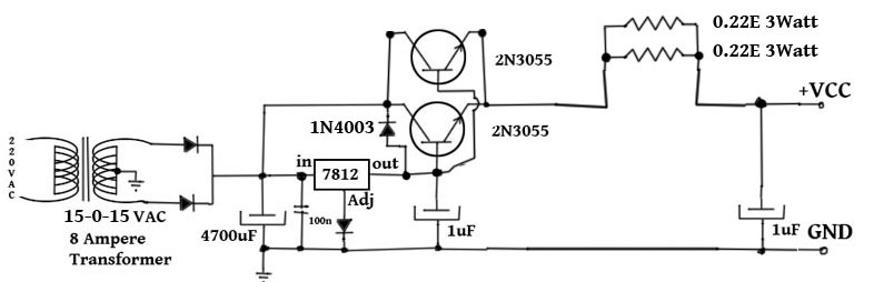

Thank you really so much!
I have tried to draw the schematic as I understood from your valuable words.
Kindly correct the drawing if I am wrong.

The resistors should be in series with the 2N3055 emitters. Keep in mind that at full current, they will drop some voltage. And, since there's one diode drop from B to E, the output voltage will be about 11.4 volts. One problem with this design is that the output is not truly regulated; there's that diode drop (which varies with current and temperature) and the drop across the resistors (varies with current). You can compensate for the diode drop by putting another diode in series with the Adj pin of the 7812 (pointing down).
The National Semiconductor application notes for three-terminal regulators have a lot of useful ideas. I vaguely remember seeing a high current circuit where the transistor(s) were in parallel with the 78xx, so the regulator could still regulate.
And, consider using the LM723, which is better suited to driving external transistors.

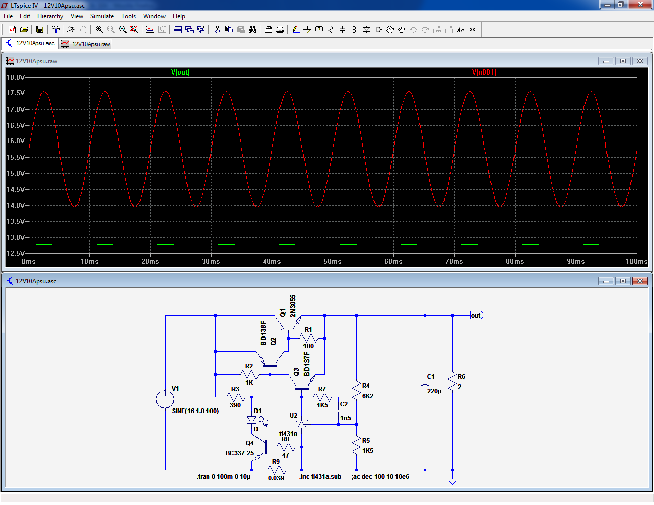

A quasi-discrete regulator like this example is barely more complicated, and doesn't have the drawbacks of 7812+Q's: it truly regulates the output, has a dropout of only 1V and includes a (optional) current protection with an indication.
You can parallel as many 2N3055's as you need, with 0.1 ohm emitter resistors:

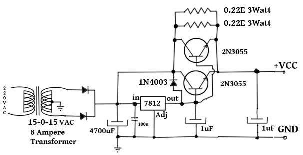

I have redrawn the schematic. Kindly check if it is correct or not at your convenience.

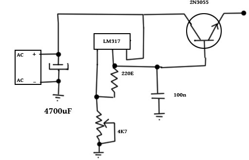

Can I use LM317 instead? I have some unused LM317 regulators in my inventory.

Can I use an LM317 to further simplify the regulator?

An LM317 will complicate matters.
The 0R22 resistors go between each emitter and the output. They are in series with each emitter not after both emitters are connected together. The resistors connect the emitters back together.
The 2N3055 is good for 17Amps. You only require 8Amps.
If you keep the heatsink cool, one transistor is sufficient. You then no longer need the 0R22 balancing resistor.

No, it will not work. There are literally thousands of transistors suitable, the type N°s on the schematic are purely indicative.

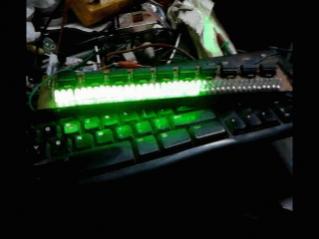

I am making a 10 band audio spectrum analyser with 400 LED or more with at least 40 LEDs per band .
I just measured the first vu meter band comprising 40 LEDs.
and here is the result.
1. quiescent current = 09.9 mA ( All LEDs off)
2. normal average consumption per band = 140.59 mA @ 7.69 volt approx. ( I'm using very high brightness LED so I've used higher values for resistors in series with the LEDs to reduce the amount of current.)
