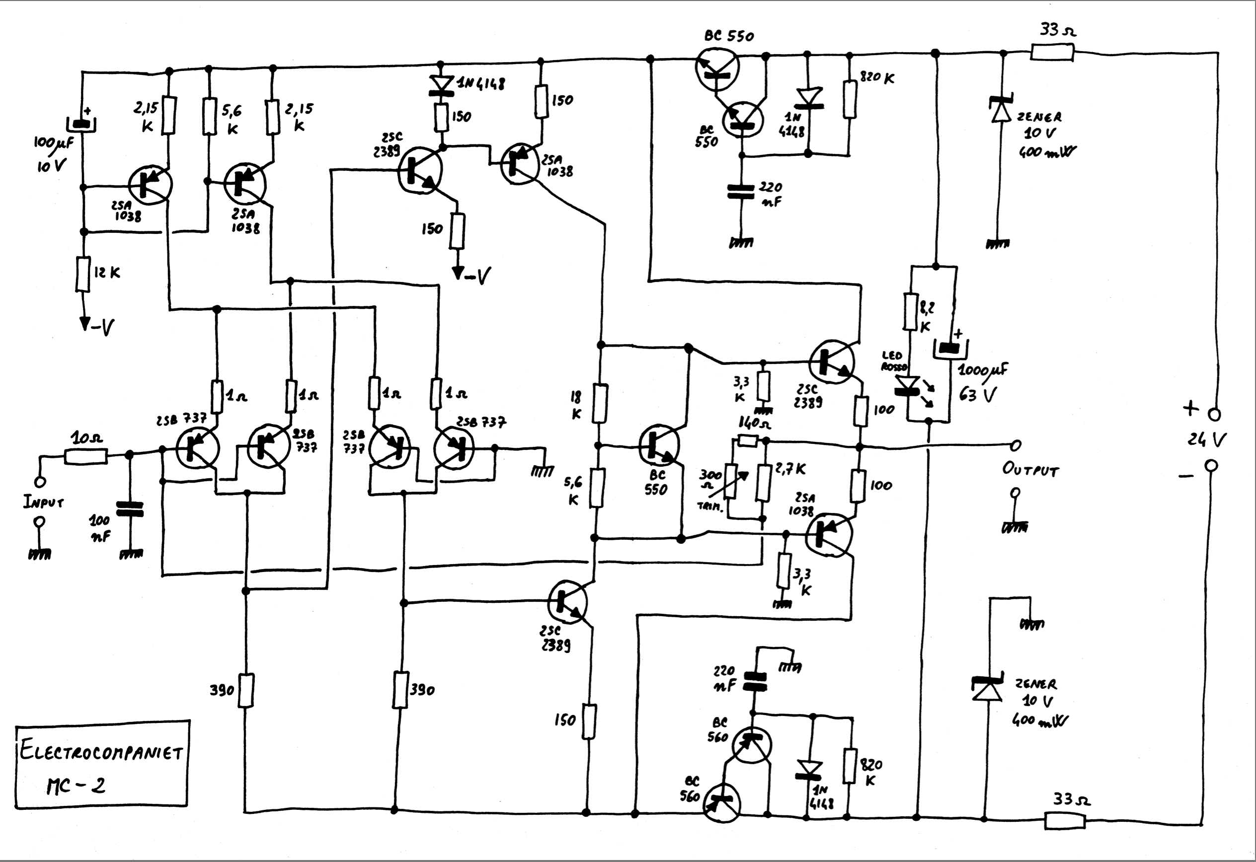

Regarding resistors on input the circuit diagram in my first post showed a fixed 10 Ohm input resistor. I believe this diagram is from the first version of the MC-2, which had dip switches adjustable through a hole in the bottom plate for the the feedback resistor R2. This R2 could be adjusted between 133,1 and 378,3 Ohm.
For the later versions R1 and R2 became adjustable and recommendations were as shown in the manual for the preamplifier with a MC module. Actually - this MC module is exactly the same pcb, which is inside the MC-2. Again we see that R1 is minimum 10 Ohm.
So - the original suggestion was for R1=10 Ohm as Marcel notes.
Hans: If R1= resistance in a very short length of wire, as you suggest, how will this effect gain and what value would you recommend using in R2? Pure maths will show gain being extremely high as R1 approaches zero but in practical terms this cannot be the case....
Your Cart becomes R1.
Depending on the gain you are looking for, choose a value for R2.
Suppose your Cart has an Rcart=47R, then gain becomes R2/47, simple as that.
With the additional 47R you have inserted at this moment, gain will be R2/(Rcart+47R) = R2/(47+47) which is 6dB less as without the additional 47R and with 3dB more noise.
There is no benefit at all to insert an additional resistor.

I did exactly the same experiment as Hans did by using a MC preamp that could be wired as current input or voltage input and current input always sounded superior with all MC carts I used (range was from AT F7 with 10 Ohm Ri up to 40 Ohms from a DL 103).
I could not observe any stability issues.
By the way, the MC2 schematic shown in post #1 already has a 100 nF capacitor directly from the negative input terminal to ground. Therefore omitting the 10 Ohm series resistor and directly connecting the phono cable to the negative input makes no difference at all (except for gain and noise) - the few pF cable capacitance in parallel to a 100 nF cap is nothing.

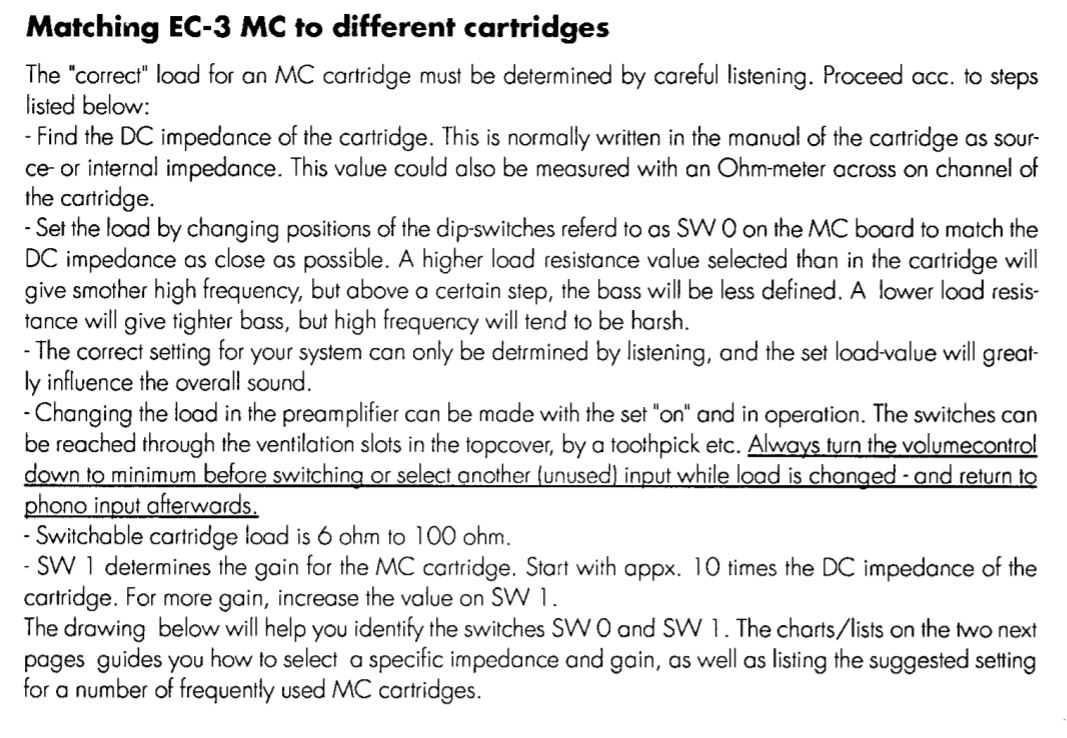

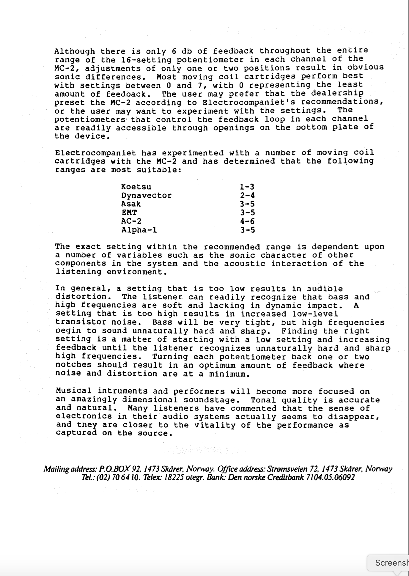

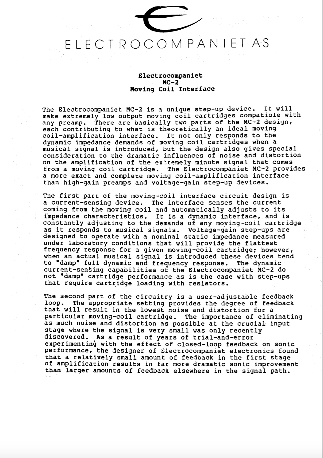

Attached you will find the manual for the original version of MC-2 (the one with dip switches for variable setting of R2).
Is it pure nonsense with all this talk about the circuit being divided into two parts: A "current-sensing" device and a user-adjustable feedback loop? I mean the second part is more or less obvious by now but what do you think about this current sensing device?
Could it be that this current sensing circuitry needs an additional load hence the minimum 10 Ohm in the original version? This 10 Ohm value for R1 has been carried over to the upgraded version as described in manual for the preamplifier.

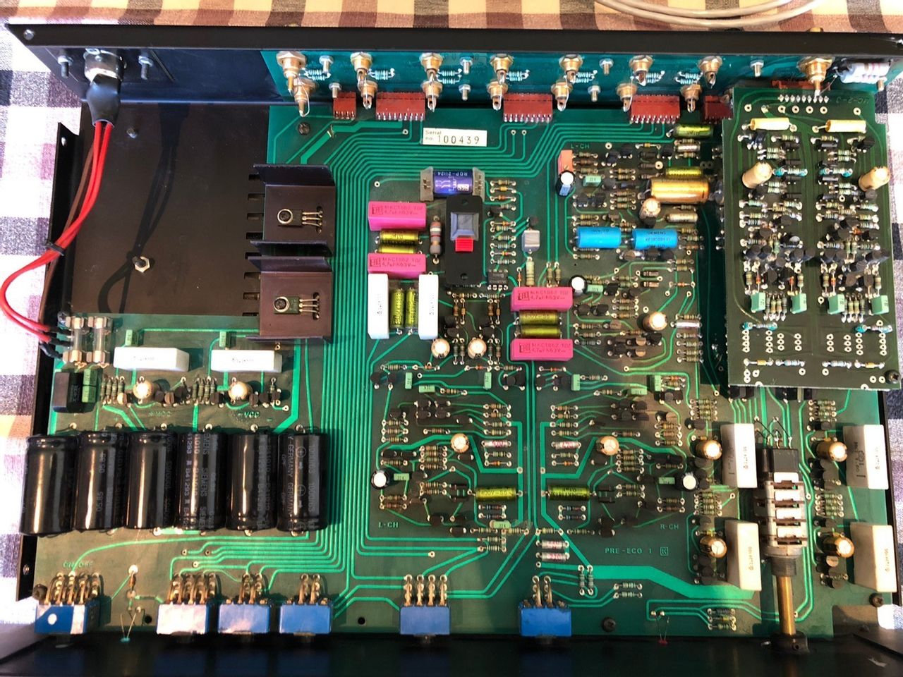

Just for your reference I have also attached a picture of the MC module when build into the preamp. The pc board is in the upper right corner as a separate board.

In my view, that is a lot of marketing blabla to explain that the amp is current input and not voltage input. Even people with some engineering background sometimes have dificulties to understand current drive - the world is mostly voltage centric.
Also the 'self-adjusting' feature is simply the fact that carts with low internal resistance will produce more gain than higher internal resistance carts.
With all respect Marcel, but MC Carts seem to be new territory for you.
True, but I can assure you I have more than enough experience with making all sorts of amplifiers oscillate.
Good point. That should indeed make it quite insensitive to the cable, even without R1, so the potential stability problem is almost certainly a non-issue for this specific design. Great!

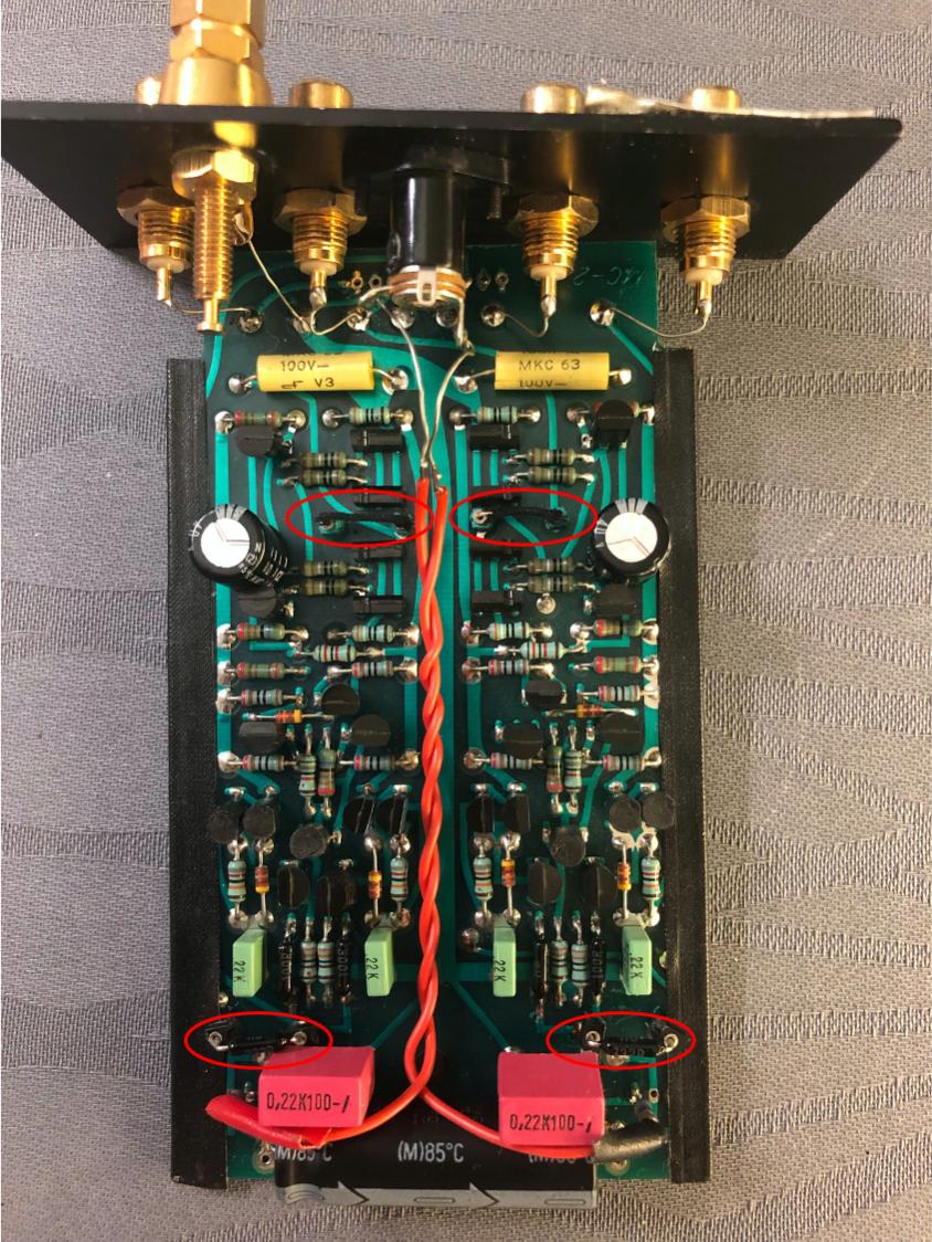

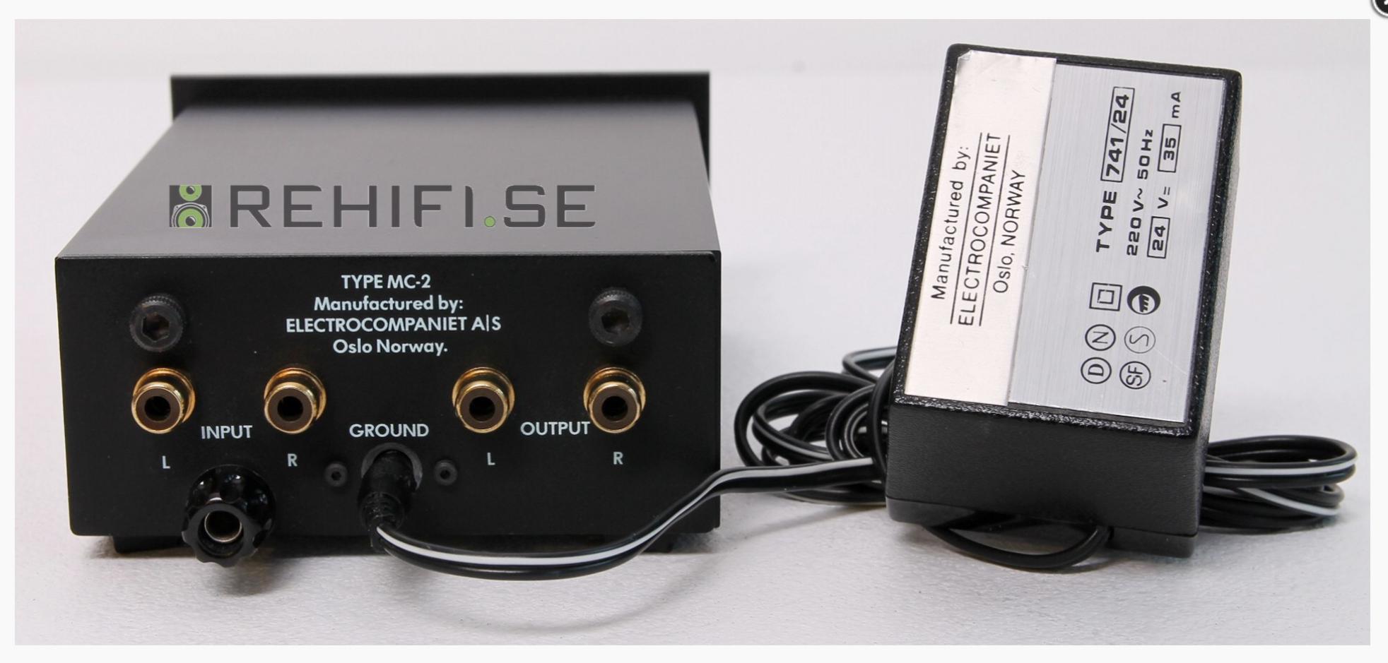

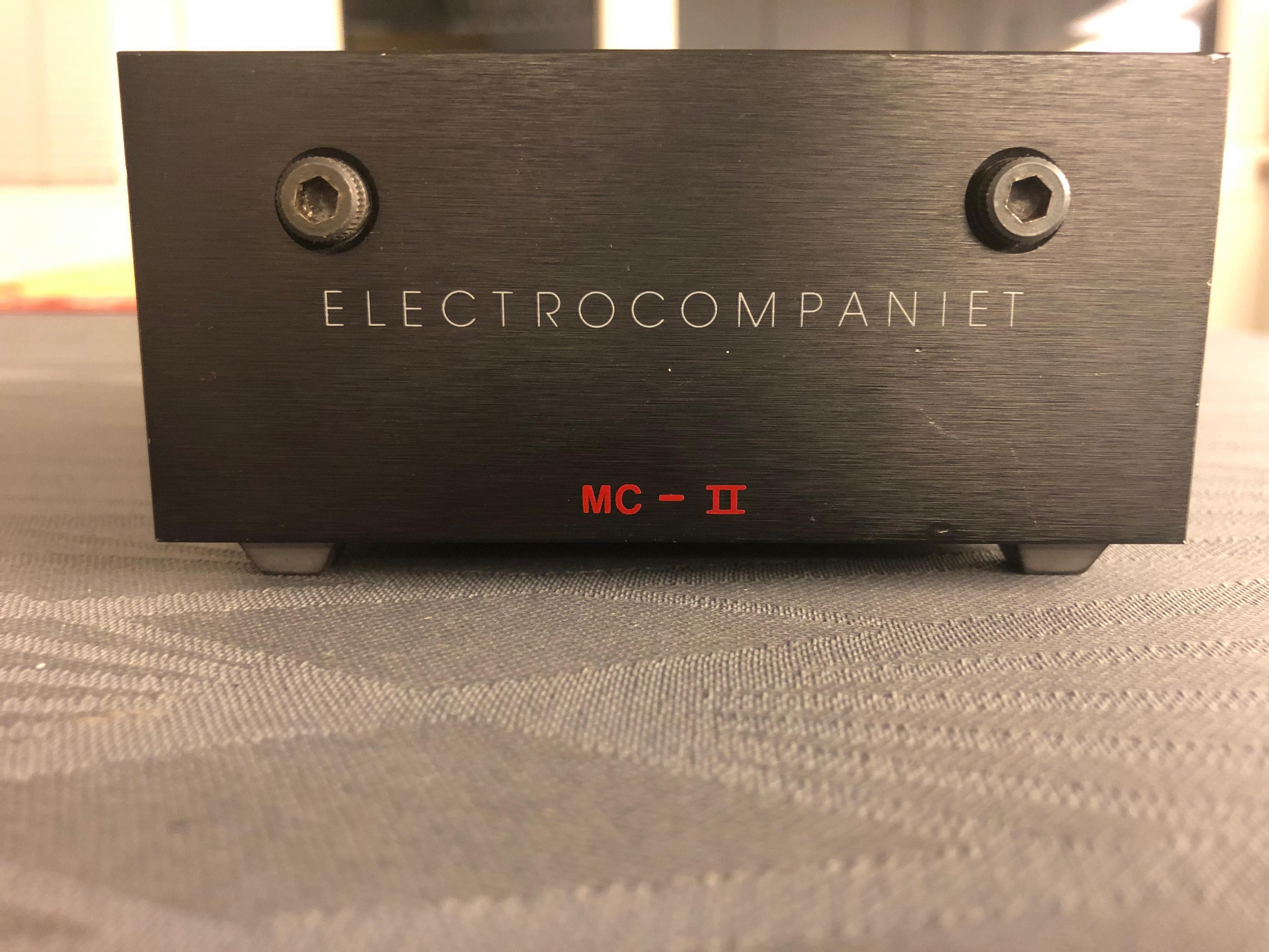

I have attached pictures of the unit as you all have not seen it yet.

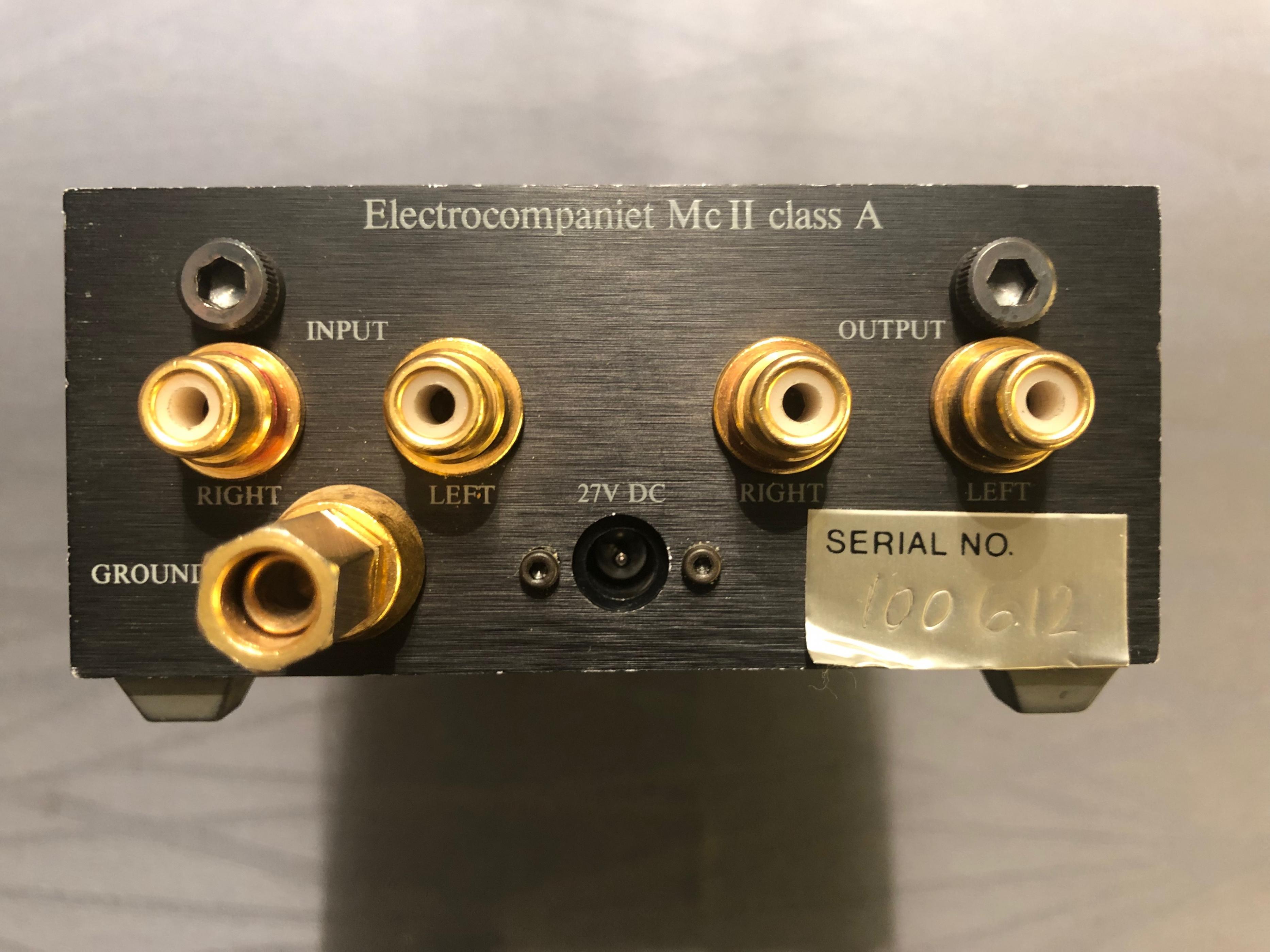

First picture shows the rear. Please note that it says 27 V over the DC power connector. Can this be correct? The diagram for the old/first version says 24 V and I have found specifications also stating 24 V. If correct, will the higher voltage not be converted to heat, as the voltage divider reduces the voltage to 20,8 V ?? The resistors and zener diodes (see attached diagram) will only get hotter, right?
Next up is the circuit and pcb. I have marked the placement of the two resistor sets. The upper set is here made of bare silver wire.
My very good friend is working on Hans Polaks second suggestion: Creating a power supply from batteries. It will be either two battery packs made up of smaller rechargeable batteries or to large 12 V batteries (although not those larger ones made for cars 😀). Update will follow on this subject whenever they are ready for test.

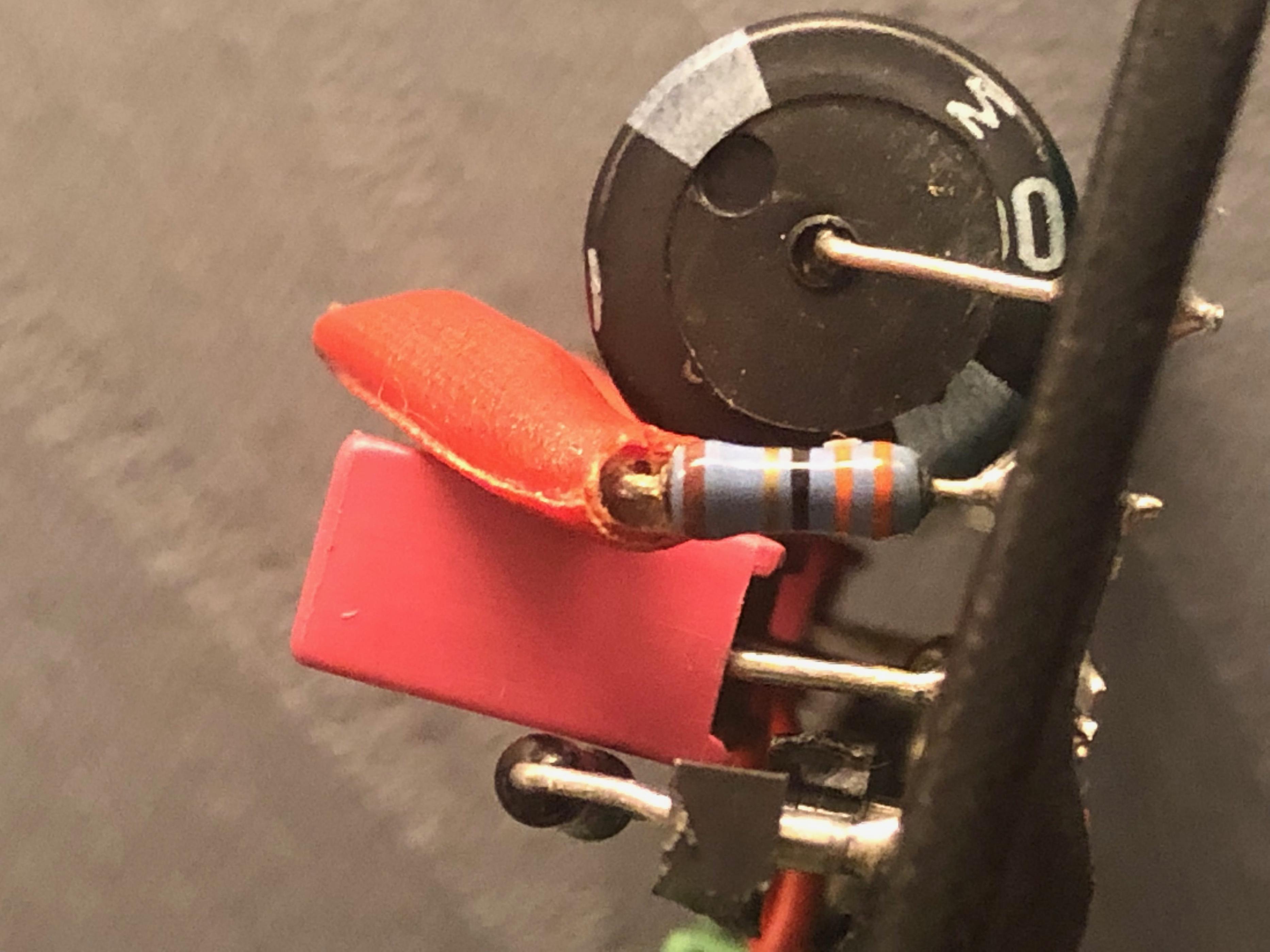

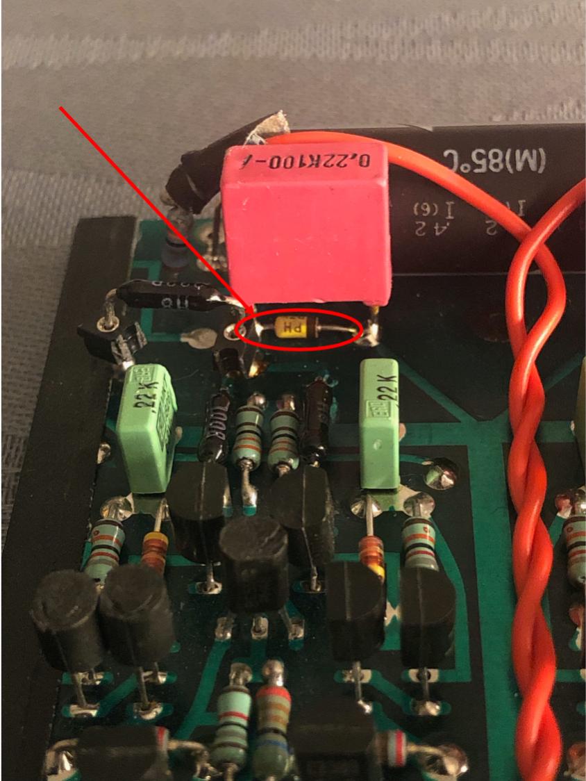

Marcel: The resistors are 33 Ohm on incoming power. Attached picture show one resistor with two orange bands, followed by a black, gold and brown. That should make it a 33 Ohm resistor with 1 % tolerance. It evens measures correctly within that tolerance 😉
The zener diodes are quite small (attached picture) and measures L=2,5 mm, diameter Ø=1,5 mm.

27 V - 10 V - 10 V = 7 V
7 V/(2 * 33 ohm) = 0.1060606... A
Rough estimate for the current that the amplifier needs: 20 mA
Estimated current through the Zeners: 80.606060... mA
Zener dissipation: 806.060606... mW
Allowable Zener dissipation: about 400 mW or 500 mW
I wouldn't dare to put 27 V on it, unless the Zener voltage has been increased to more than 10 V.

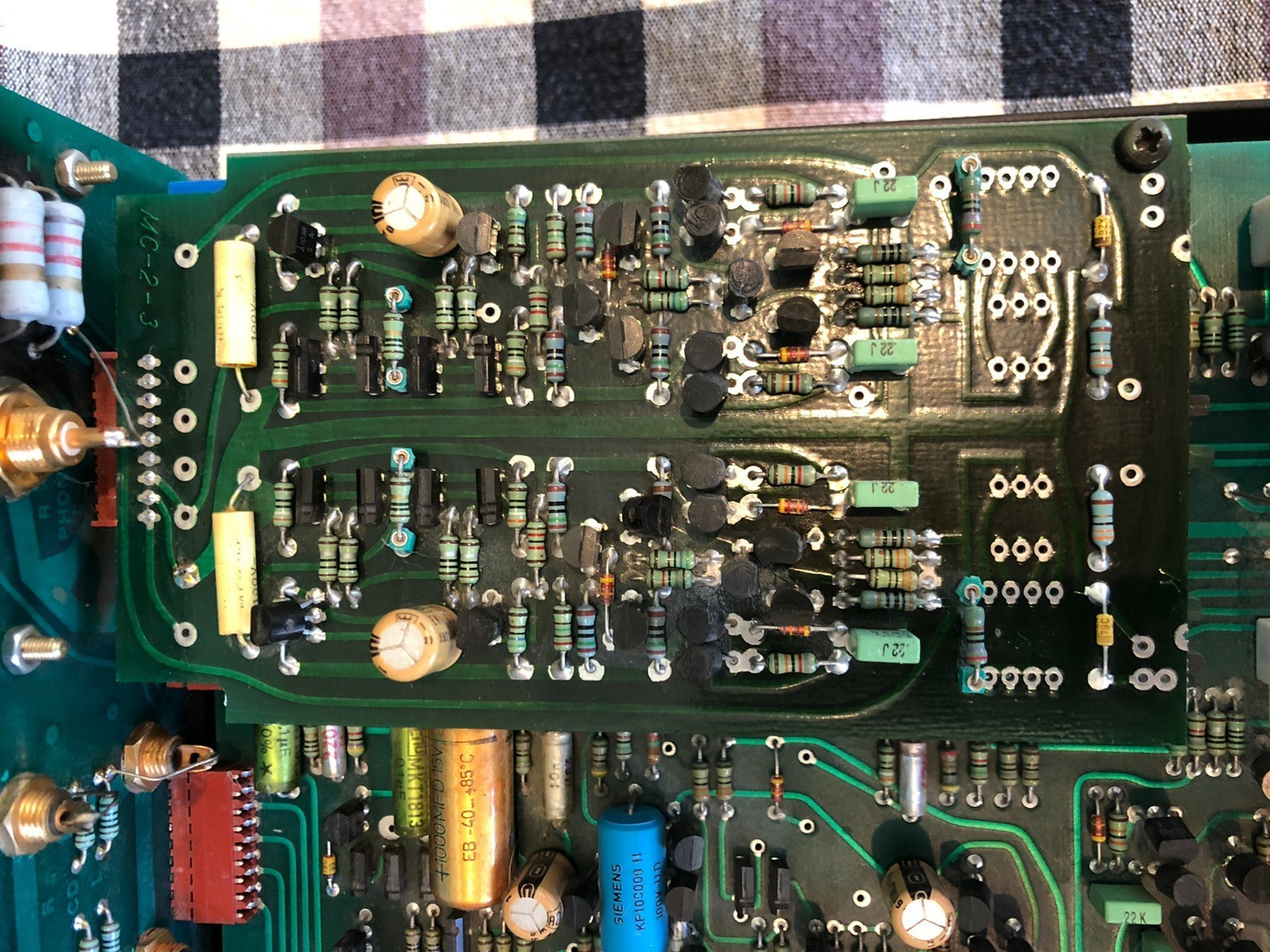

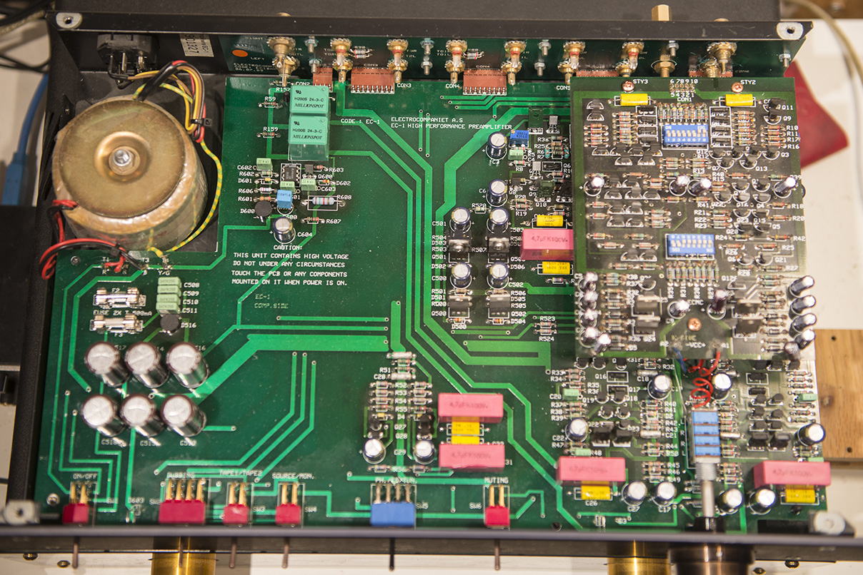

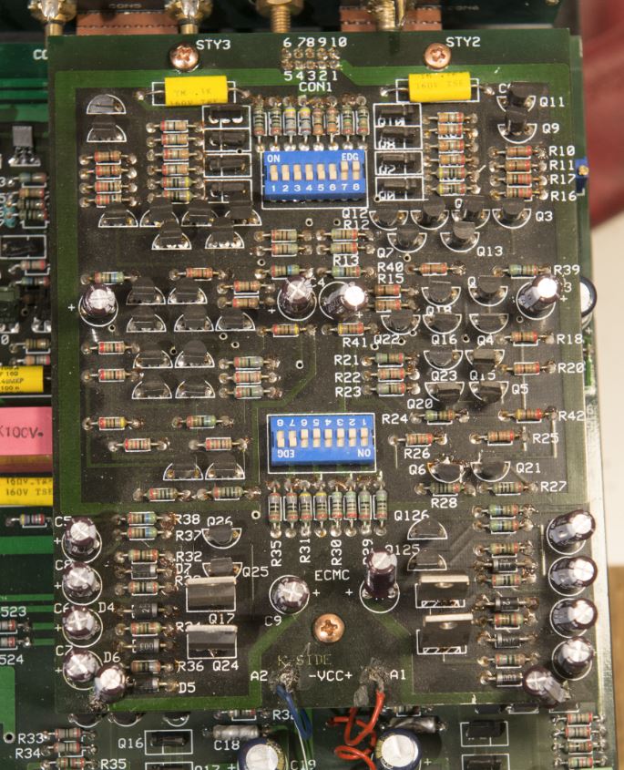

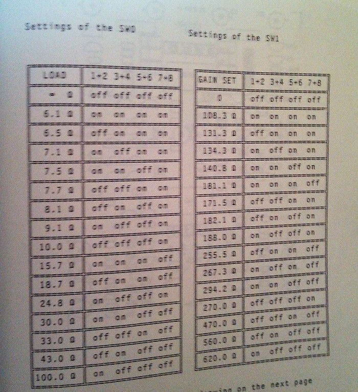

The first is early version 1987, with switchable MM/MC mode. The MC stage uses replacable resistors for load and gain, like the ECMC2. It also has options for using several resistors in combination to get just theperfect match. This is special, and beyond me.

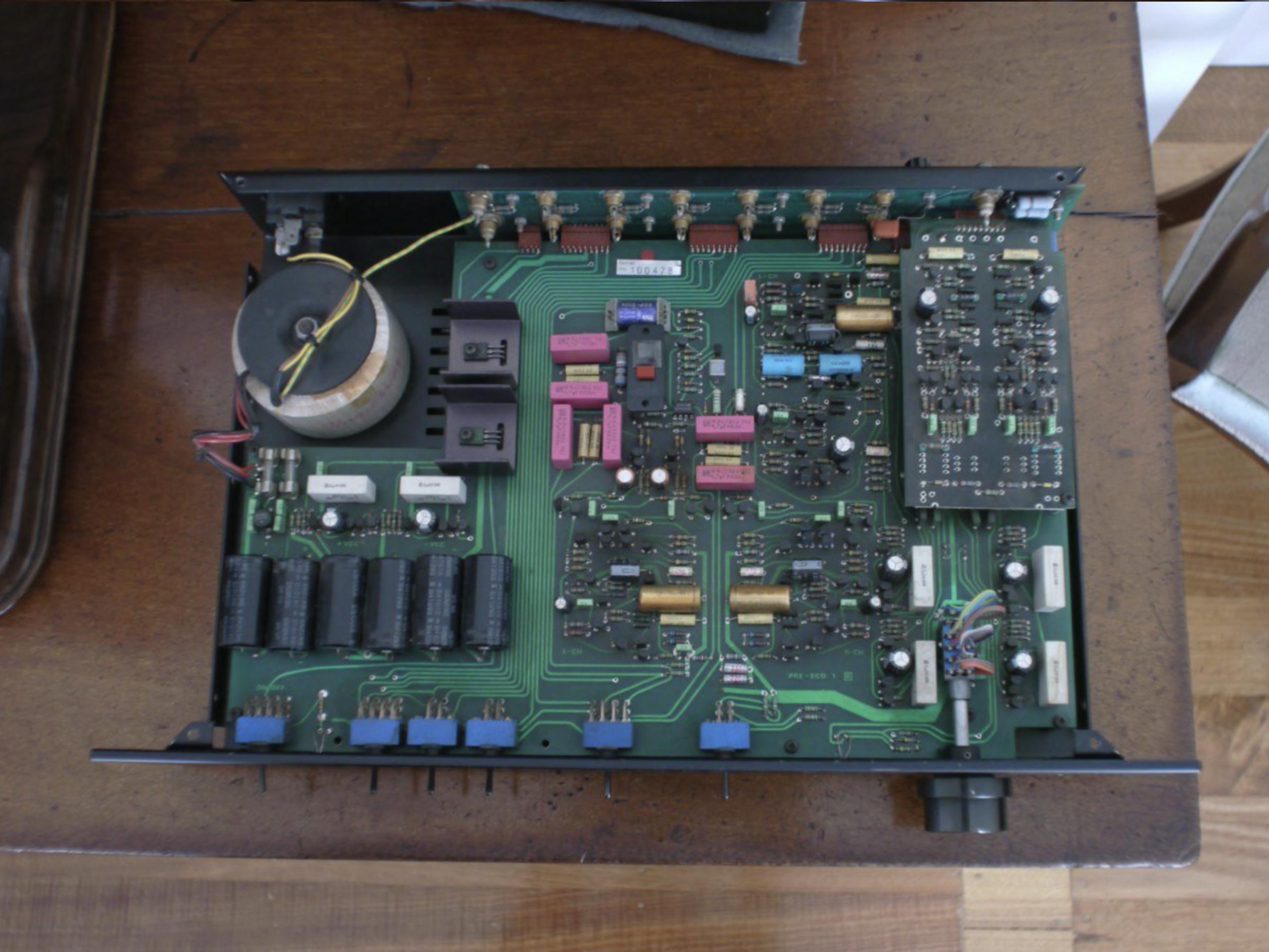

The second (I call it EC-1b) is dated July 1989, and is MC only; that is, they have removed the switch for MM/MC. The MC card can be lifted out, and the signal paths in the multipin connector shorted (sorry for term), and it becomes a MM stage only, 22pf/47kohm with 32db amplification.
This system is repeated in the EC-3 preamp, which also came with a balanced MC stage, basically built on the EC-1 (according to EC). I've attached a pic of this version too, but unfortunately I don't have this MC stage version.

But, from what I understand, I could extract the MC card in my oldest version and make a standalone headamp? Battery powered even?
Of course I'm wondering if it could be made balanced in the process, like the EC3-MC, but I'm afraid the answer would be too difficult for me to implement...🙄.
The Zeners are used as shunt regulators rather than voltage references, hence they work at a higher current - but with 27 V at the supply input they work at a too high current (about 80 mA while they can handle 40 mA). Assuming they are still 10 V each, that is.

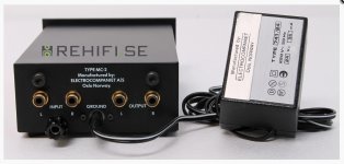

Your contribution also adds new info to this thread, were we are trying to demystify the MC-2. For your info I have attached a picture of the MC-2 with its external PS.
Would it be possible for you to take a clearer/sharper picture of the resistor values scheme from, what I assume is, the manual for the EC-1?
There are more cues to listen for in adjusting both R1 (load) and R2 (Gain) even though Hans Polak has demonstrated, that the R1 contribution is of less importance, or irrelevance as I am sure Hans would express it..
Thanks again Marcel for knowledgeable input on whether 24 V or 27 V was feasible in the power supply. From your calculations we must assume, that there was an error in the screen printing (see attached photo) for this batch of MC-2´s 😀
