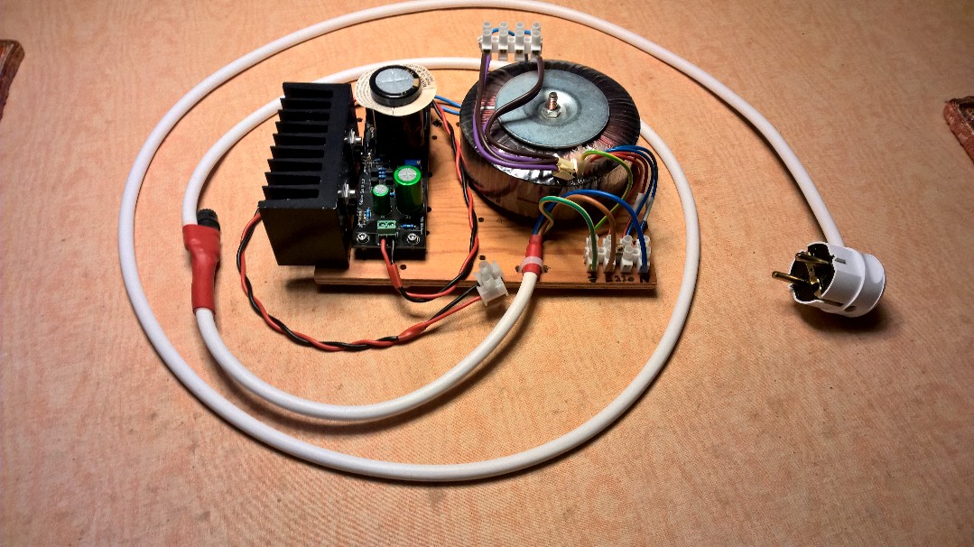

So - here is some more food for thoughts... 🙂
First of all thank you so much for all the inspiring and knowledgeable comments from all of you. They are highly appreciated. I definitely feel we are getting somewhere.
A very good friend of mine helped me optimise the MC-2 with correct resistor values for a Benz Micro Ruby (which also happens to be his 😀), that I have on loan.
We used Holco and Shinkoh resistors. The change in sound was noticeable from the original R1=18 Ohm and R2=332 Ohm. Now the Benz is loaded with 47 Ohm and gain set accordingly.
Now - my very good friend also build me a shunt regulator based on a Salas design. Only in a test bed with what parts were available, hence the trafo is rather big and so is the cooling fin (see attached picture). We have a steady 23,8 V on the inside of the MC-2, just as with the original trafo.
But the sound.... differs... a lot 😱
- Soundstage became really wide and deep with so many layers.
- Midbass was tightened up and the low bass to mid bass is now very detailed
- Dynamics improved considerable and soundstage is rock solid.
- Treble sounds truer, more real and much, much more detailed.
So a generous power supply unit is definitely a way to go even for this modest amount of current drawn from the circuit. A shunt regulator may not be the best alternative, but what do you members suggest? A regular PSU with filtering, shunt regulator or...??

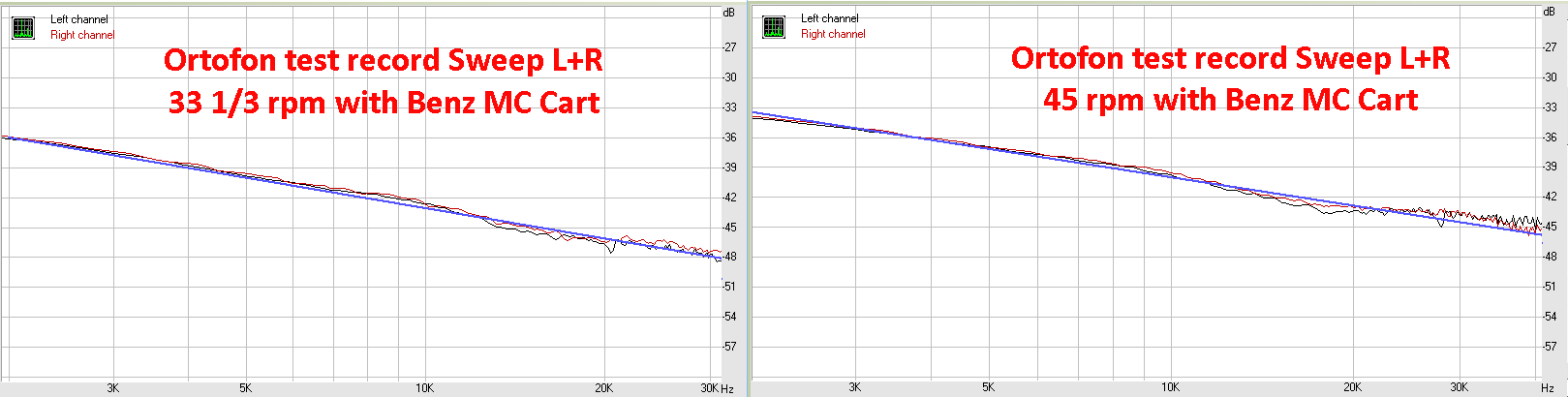

Hi Marcel,
1) Fortunately your suspect is not valid in the real world of MC carts.
Take my Cart, Rcart=38R and Lcart=15uH.
This gives a -3dB point at 403Khz, not exactly a thing to worry about.
So assuming a 50 mH coil because output is 10 times lower is more then a factor 1000 to pessimistic. 😀
2) The other thing you mention is cable capacity, which does not play any role with these values,
but also keep in mind that in case of using a virtual input, this cable capacity is directly in parallel to this almost zero ohm virtual input impedance, thereby having even less effect as when the Cart is loaded with 47R inside the preamp.
3) To prove the above, have a look at the following graphs made from an Ortofon test record, cut with constant velocity and played with a straight non Riaa preamp.
Graph was made with my cart directly connected to the virtual input of the preamp and should ideally result in a -10dB/oct downwards slope.
As you can see, the result is almost exemplary up to 40Khz.
To conclude, don't keep hanging in figures, you always have to try and test with your ears.
Hans
