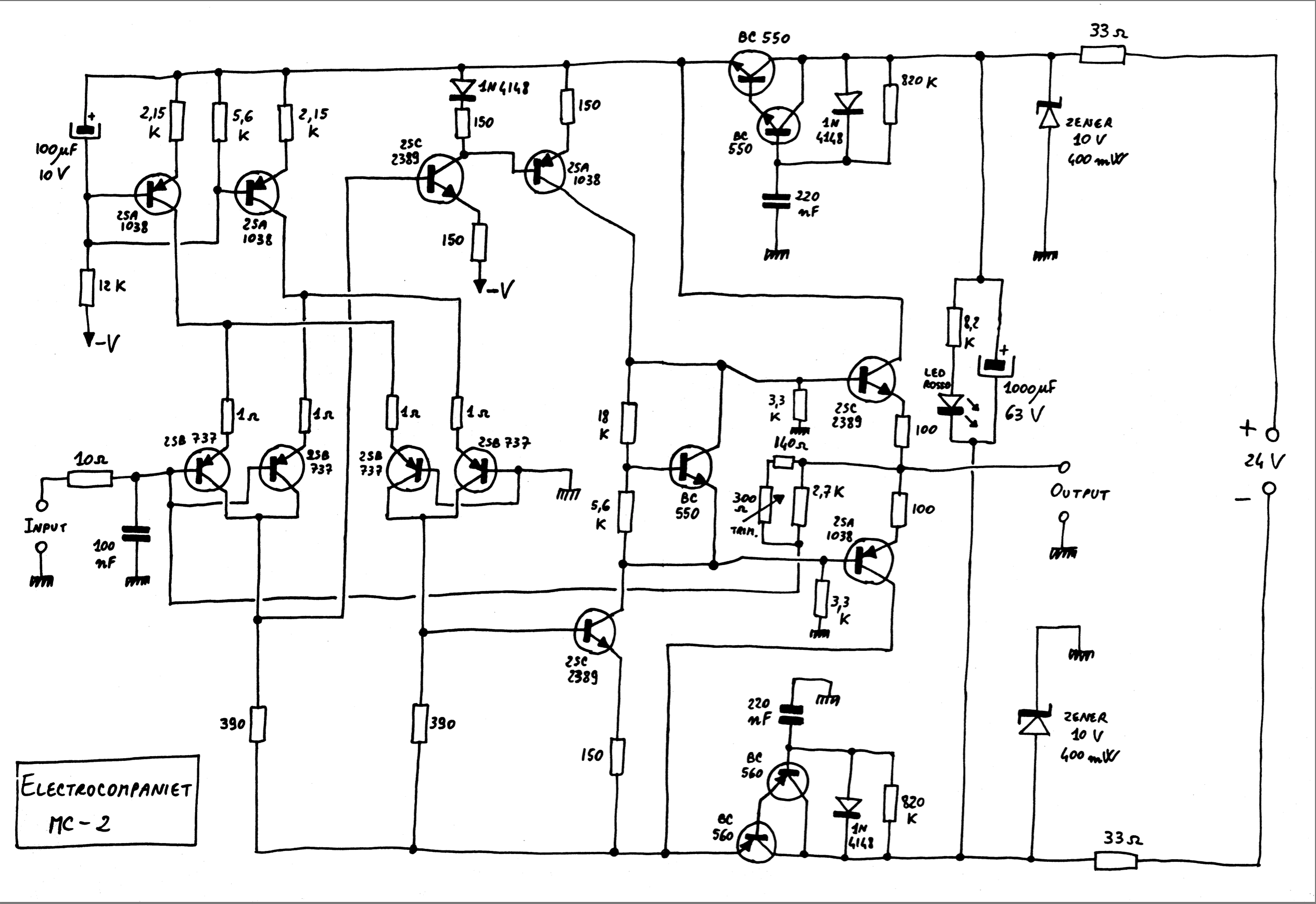

I found a drawn schematics on the internet which correlates well with my unit except for trim resistor setup for feedback/gain. I have only a fixed resistor in mine.
This is for the first version with load resistor being (maybe?) 10 Ohm on input.
Feedback/gain reistors made up from trim resistor in series with 160 Ohm; both in parallel with 2.7 kOhm. This should result in values between 151 Ohm and 393 Ohm.

The schematic has a 10 ohm resistor to a virtual ground, so its input impedance is ideally 10 ohm - which is unusually low. Maybe they later changed to a non-inverting configuration, with the signal applied to the bases of the right two 2SB737s and the 10 ohm connected to ground?

Assuming the amplifier has a decent amount of loop gain, which it probably has, the cartridge sees the input resistor as a load - so the 10 ohm, 33 ohm, 43 ohm or 100 ohm to the virtual ground point also sets the input impedance.

The gain from the terminal voltage at the input to the output voltage is ideally -Rfb/R1, where R1 is that 10 ohm, 43 ohm or 100 ohm and Rfb the resistance of that circuit consisting of a 140 ohm resistor, a 300 ohm potmeter and a 2.7 kohm resistor.
The gain from the cartridge's open-circuit voltage (Thevenin voltage, EMF) to the output voltage is lower, ideally -Rfb/(R1 + Zcartridge), where Zcartridge is the impedance of the cartridge. You would get the same gain reduction with cartridge impedance with any amplifier having an input resistance of R1, it's just the voltage division between the amplifier's input resistance and the cartridge impedance.

Is the circuit inverting the input signal? 😕
Meaning I will have to alter the wiring connector pins on the cartridge?
yes, it is inverting.........."minus gain " means inverting.

The amplifier seems to need only one floating 24 V source, the 10 V Zener (or actually avalanche) diodes then generate +/- 10 V from it. 27 V may already overheat the diodes, so I guess you would need three 9 V batteries in series and a 47 ohm resistor to limit the current. Just three batteries might do if their internal resistance is high enough.

Put a pencil on it. If we trust the numbers, it already has 606mW in the 400mW diodes.
But do we understand how much power-crap reduction is possible here? The R-Z well over 20dB. The cap-multipliers are not pulling their weight at about 40dB. All paths from a rail to the output are via Collectors and typically >>60dB. Maybe 70dB each but three paths so pencil 60dB. Plus 40 plus 20 is 120dB rail rejection relative to output. To input another 20dB-30dB.
There's things I don't like but power cleanup does not look necessary. The designer is not as dumb as we think.
606 mW is assuming that all current flows through the Zeners. The rest of the circuit draws about 20 mA (rough estimate), so it is very much on the edge: it needs to draw 20.6 mA to reduce the power dissipation of the Zeners to 400 mW.
