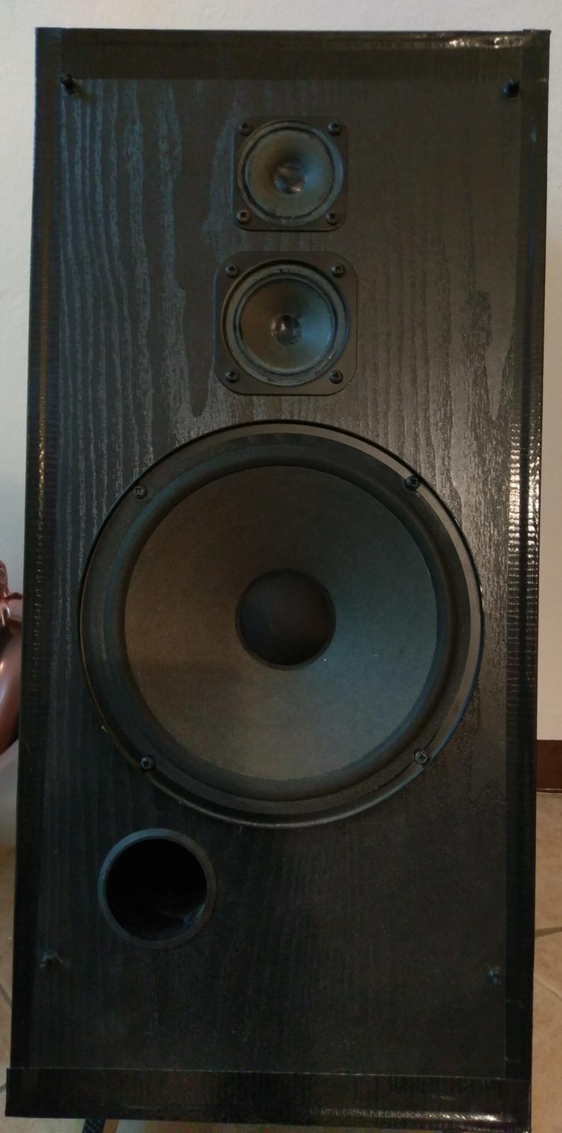

One small detail about the old enclosures that I saw when I was toying with covering the "extra hole"... I forgot they had some mold on them and the wood has a soft touchy feeling mainly in the back. So Im either gonna just change the back panel or gonna redo the box with some extra boards a friend has :smash: (hurray for me, I get to scratch my woodworking itch anyway 😀)
I want to respect the plan you made for me, so if I see it's worse than thought, I would just do an exact copy, minus the extra hole of course, respect the inner volume and use the existing port tube. I just wanted to ask you if I should have some special considerations for redoing the box? 😎
If building a new enclosure, you can take the opportunity to re-arrange the drivers on the baffle. I would raise the bass driver, and hence the tweeter, higher up the baffle. You may also like to locate the port centrally for symmetry. Look at other 2-way speakers as a guide.

If building a new enclosure, you can take the opportunity to re-arrange the drivers on the baffle..
Noted thanks! I would still have to wait and see how it looks when I take off that back panel, hopefully it's not that bad 😛
I have a pair of B&W DM560's so maybe I could take some placement cues from those.. The B&Ws have a narrow baffle and deep enclosure as opposed to the Sanyos (a bit wider and shallower), but I suppose that the current baffle dimensions are important to respect correct?
Although narrow baffles and deep cabinets are the current trend, it's hard to see how, given the size of the woofer, you could make the cabinet much narrower.
As long as you maintain the current volume, you can tweek the other cabinet dimensions to suit any possible reduction in baffle width.
