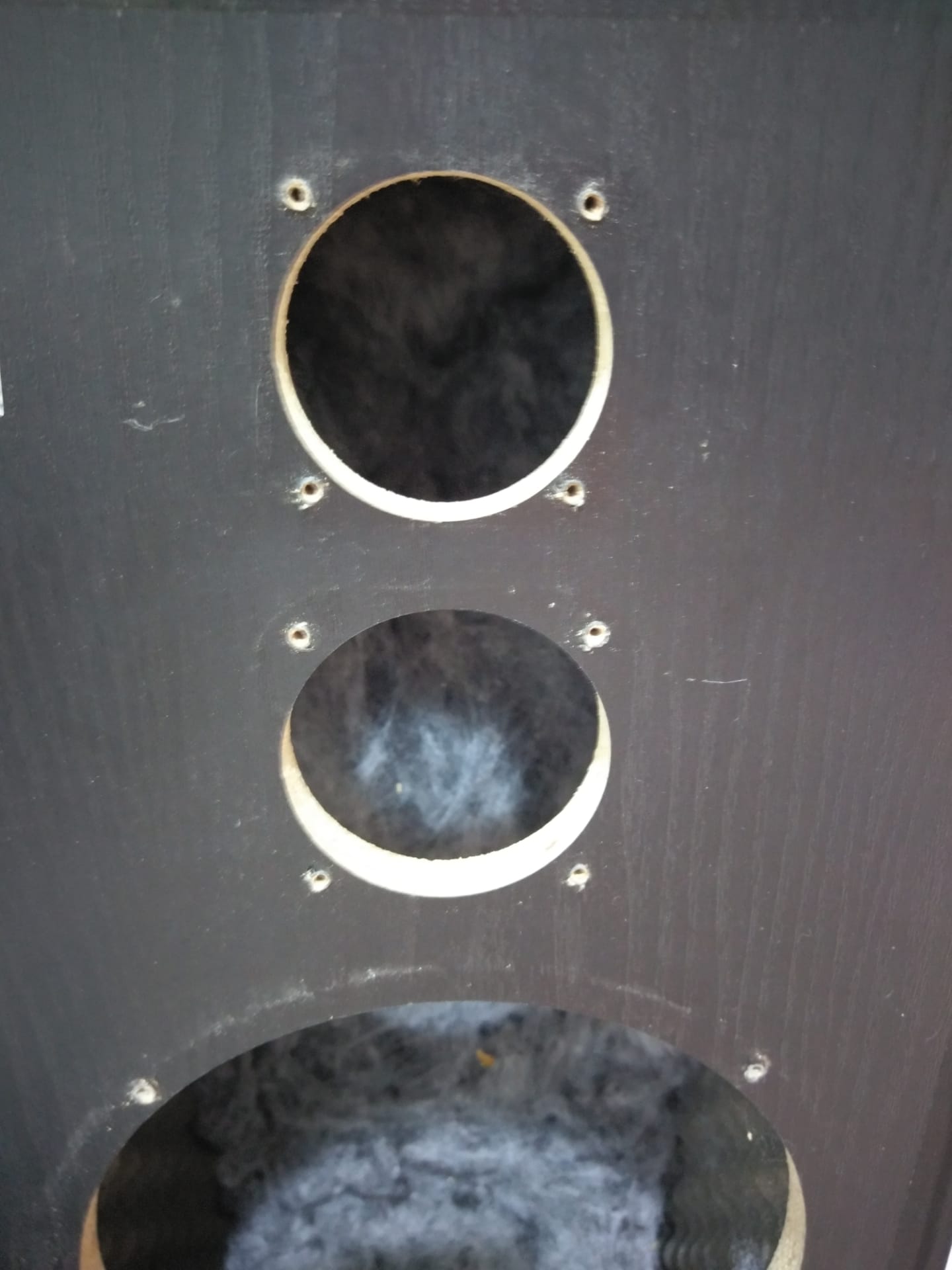

The mid (supplied by a 2.2uF cap) and the tweeter (supplied by a 1.0uF cap) are not well differentiated and are working in tandem in the high frequency range.
The combination can usefully be replaced by a single tweeter having a cone of similar size to that of the present mid - like the Monacor tweeter I suggested.
I regard the three-way arrangement on your speaker as simple window dressing - 'three drivers must be better than two' is probably what the manufacturers wanted the uninitiated buyer to think. This speaker is not real hi-fi - it is one designed to impress the average domestic consumer.
I'm surprised that it is difficult to order a tweeter from this Italian distributor: TWEETER CONICO,10 W, 8 OHM - Zzippgroup

.. the TW 6 NG would fit into the tweeter aperture of your enclosure with a little coaxing.
So I found a local site that has some visaton but not this one specifically. Can I ask, what info/specs should I compare to see if it fits? is it the cutout diameter only or can you estimate the fit from the cone size?
I ask cause the cutouts of this box does not have the trimmed edge that you see in better boxes, it's a flat cutout (I attach a pic at the bottom). So making the diameter bigger would not be an issue and could open the options.. I guess.. :confused:
If that makes sense or is possible I found a tweeter with the same specs as you have recommended (monacor or visaton) but bigger diameter (i never heard of this brand so i hope its good enough):
Dynavox: DX159 25mm Hochtoner
I really shouldn't have to tutor you on how to choose a tweeter whose dimensions suit your aperture, but I'll give it a go - life's a challenge anyway! ;)
Look at the attachment. See how the 63mm dimension means the back of tweeter will fit into your mid aperture? See how the 90mm dimension will stop the entire tweeter from falling into the aperture? See how the 80mm screw fixing circle diameter means that the screws will go into wood and not thin air?
Perhaps you can now tell me if the Dynavox will fit, as I can't read German!
It's difficult to make a circular aperture substantially larger. If it just needs to be a little larger, you can achieve this with a curved file.

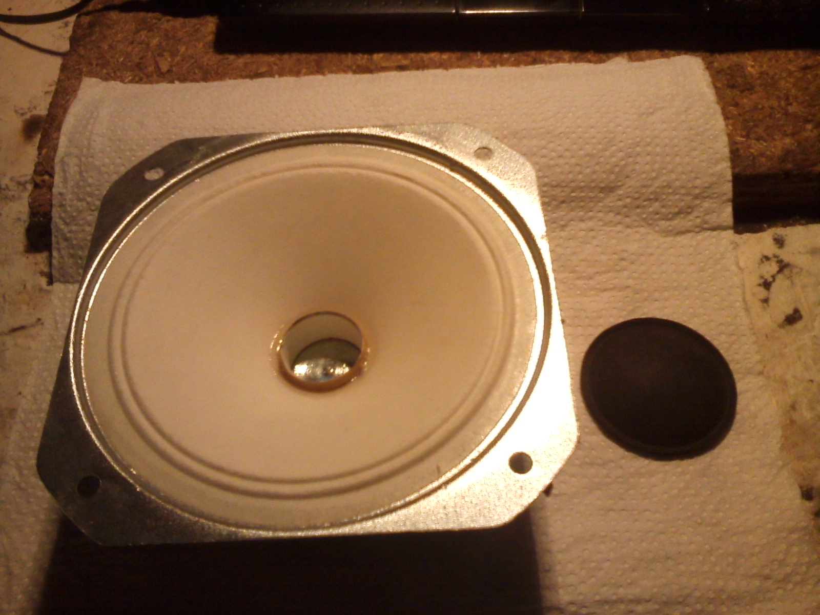

Long ago cone tweeters were all that was available, so everybody used them, what else?
Even the "best" speakers around, think Marantz, Altec, KLH, Advent, early AR, even JBL!!!!!
Then domes swept the market and cone ones were forgotten, except some terrible ones in cheap speakers (like ... um ... what you found ) but now many are rediscovering them, at least to repair old cabinets kept in storage, gotten for peanuts at Salvation Army or even free.
Domes are technically better because they reach higher flatter but need higher crossover frequencies; fine in a 2 way with, say, a 6" or 8" woofer which reaches higher so as to meet the tweeter, but if woofer is larger or heavier, you have a hole in the middle which generally needs its own mid speaker.
While a cone tweeter which is actually a "light small speaker" reaches way down and can easily be mated to "any" woofer.
As Galu said, given your "mystery" woofer , a cone tweeter will integrate better with it, replacing *both* mid and tweet.
The low cost and ease of mounting is a bonus.

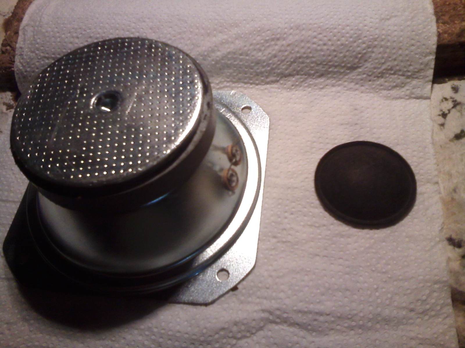

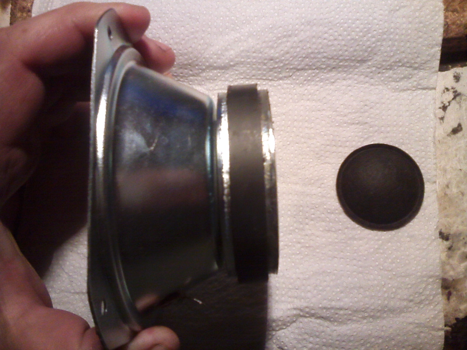

FWIW, I make my own speakers, and after many years I made cone tweeters again.
I am into Musical Instrument amplification and needed a LOUD tweeter, reaching as low as possible and biampable taking a lot of power, this is the end result.
4" cone, large (for a tweeter) high power 19mm voice coil which takes 35/40W RMS, I am talking 35/40W **at the tweeter voice coil** , system power can be as high as 500W RMS, intended use is slapping Bass players, Keyboard amps, and compact PA systems, without needing to resort to a horn + driver combination .
Huge (for a Tweeter) magnet: 73 mm diameter , some 4 or 5 times as heavy the Monacor or Goldwood one.

JMF has given a brilliant explanation of the advantage of using a cone tweeter in your application, NewGuy.
