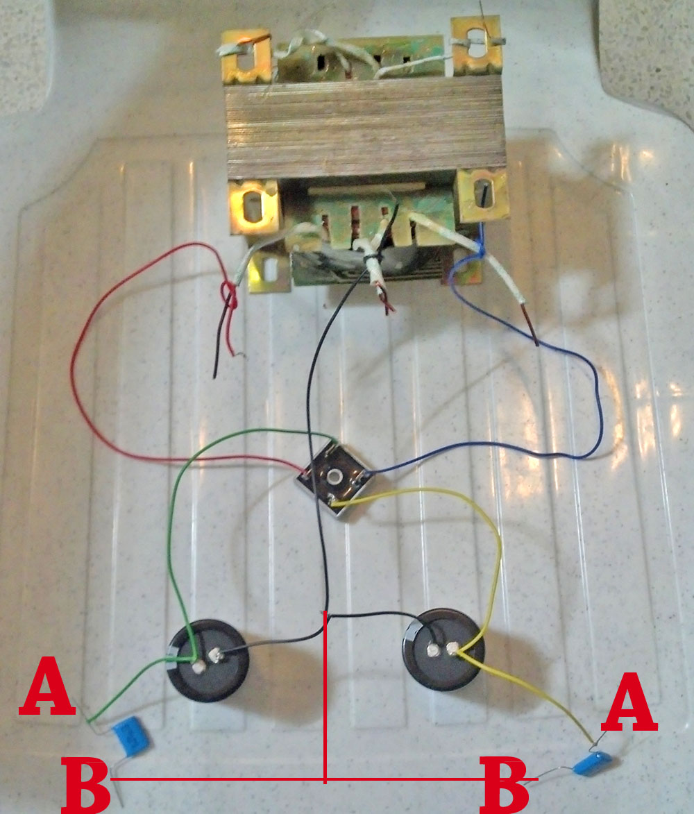

I am following this rectifier where my caps are :
10000uf/63v X 2
35A BR X 1
0.1uf X2 :

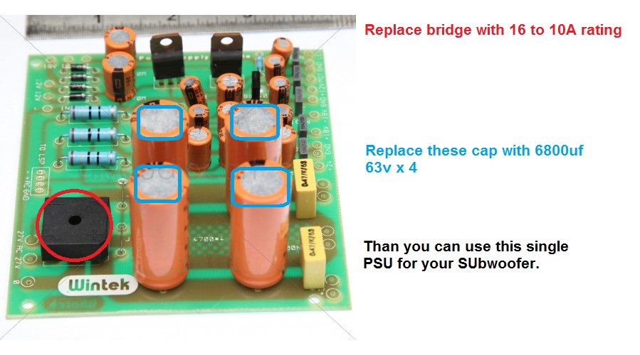

Thanks, that makes my task much easierWith following update you can use the PSU you have for your Sub-woofer

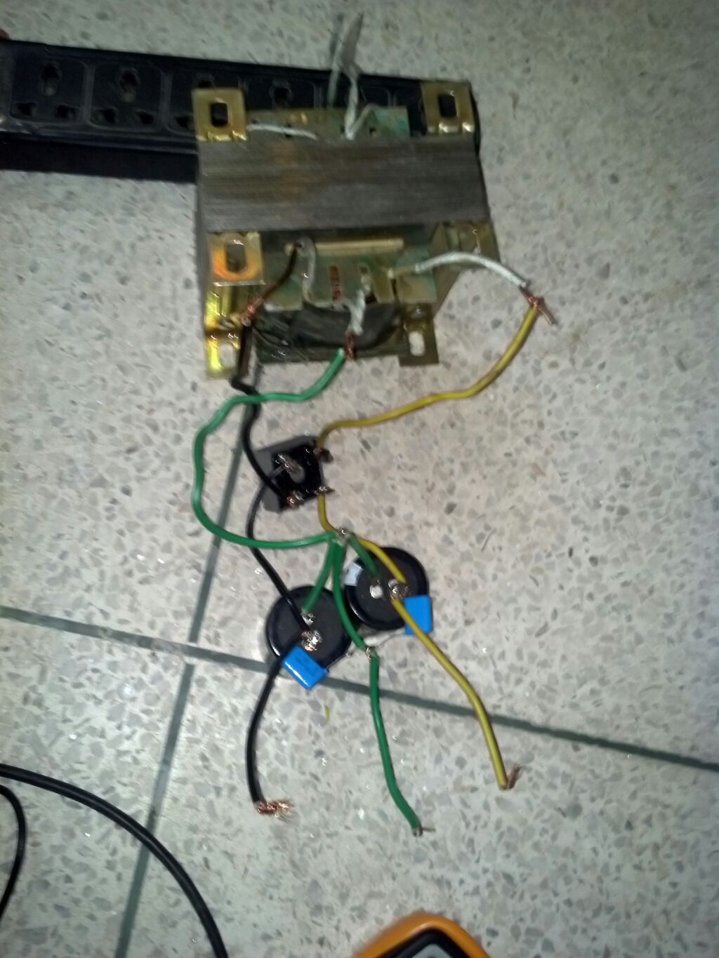

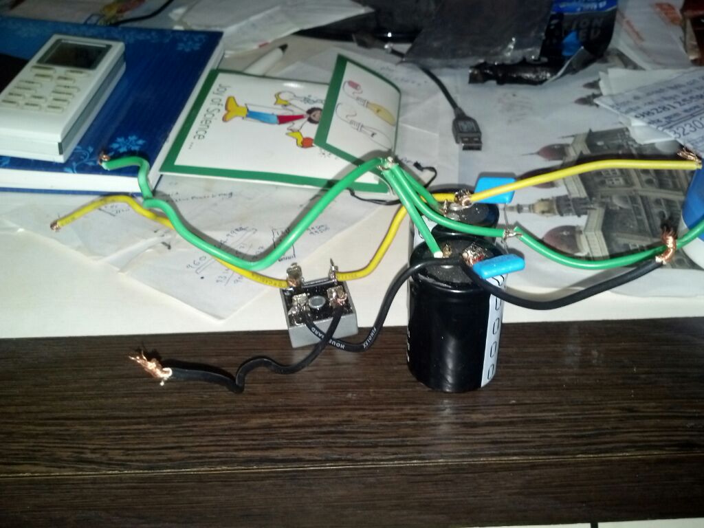

Well again checked the transformer after removing the bulb in series.
the 24-0-24 transformer showing 24-25 so its true 24-0-24 tranny. But the it showing 72 on positive (yellow wire) of PSU but nothing on negative (black wire). Green wire is zero where I tapped com pin of the MM, please check the pic:
3
is there something wrong with the PSU?
Also checked the 28-0-28 but nothing happening there. When I break both central wires, only they show reading of 25 but other two wires where I should have got 28, are not showing anything. winding part also became too hot and its still too hot.
3
Center tapping of transformer is not connected.. Or you are not selecting proper Center tapping of transformer.. Please contact trans maker to verify center tapping wires.
Please solder all wires.. loss wire may result in improper connections.
SOLDER ALL WIRE JOINTS.

I tried to measure the readings by connecting the PSU on my previous 24-0-24 transformer but it was showing some 72v on positive side wire of the PSU and 0 on negative side. Shouldn't it be some 30-32V on both +/- sides? Is there anything wrong with the PSU? Reading on transformer was corect and it was showing 24v on both ends.
How to diagnose and correct the fault?

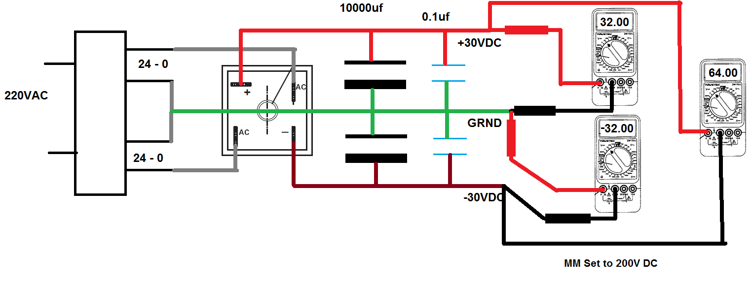

My reply was in response of 24v transformer only.. are u using a digital or analog meter for reading voltage..
Please find attachment as reference voltage reading layout.
Thanks, I was measuring in same way. I am again checking to verify and I am getting 24 on both sides (black wire of MM on 0 and red wire on either sider ) of the transformer.
But when I connect black wire on '0' of the PSU and red on (+), I get 72v and 0v on (-) side. When I connect black on negative of the PSU and red on positive, I get 144v.
Even when power is switched off and transformer wires are out of the power socket, current is still there on the PSU and I am getting reading of 67 and 134. When I disconnect the PSU from the transformer, still it is giving me same reading, the stored volts aren't draining from the PSU.
I checked multiple times, my connections on the PSU are correct as per the diagram discussed earlier.
I am using digital multimeter.
It's strange you are getting 72 VDC from 24 VAC.
With 72v DC you must have burned your test run of LM3886.. but your test was fine... How come....???????
Is your multimeter giving correct DC reading..
Please share a pic of multimeter showing reading.

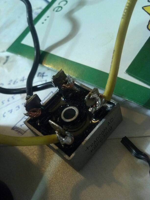

AFTER LOOKING AT LAST PICTURE CLOSELY IT SEEM YOU HAVE CONNECTED THE BRIDGE RECTIFIER WRONGLY.

Here are few more pictures of the rectifier:AFTER LOOKING AT LAST PICTURE CLOSELY IT SEEM YOU HAVE CONNECTED THE BRIDGE RECTIFIER WRONGLY.
The yellow wire going to the 10000uf cap is attached to (+) of the BR
