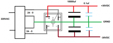

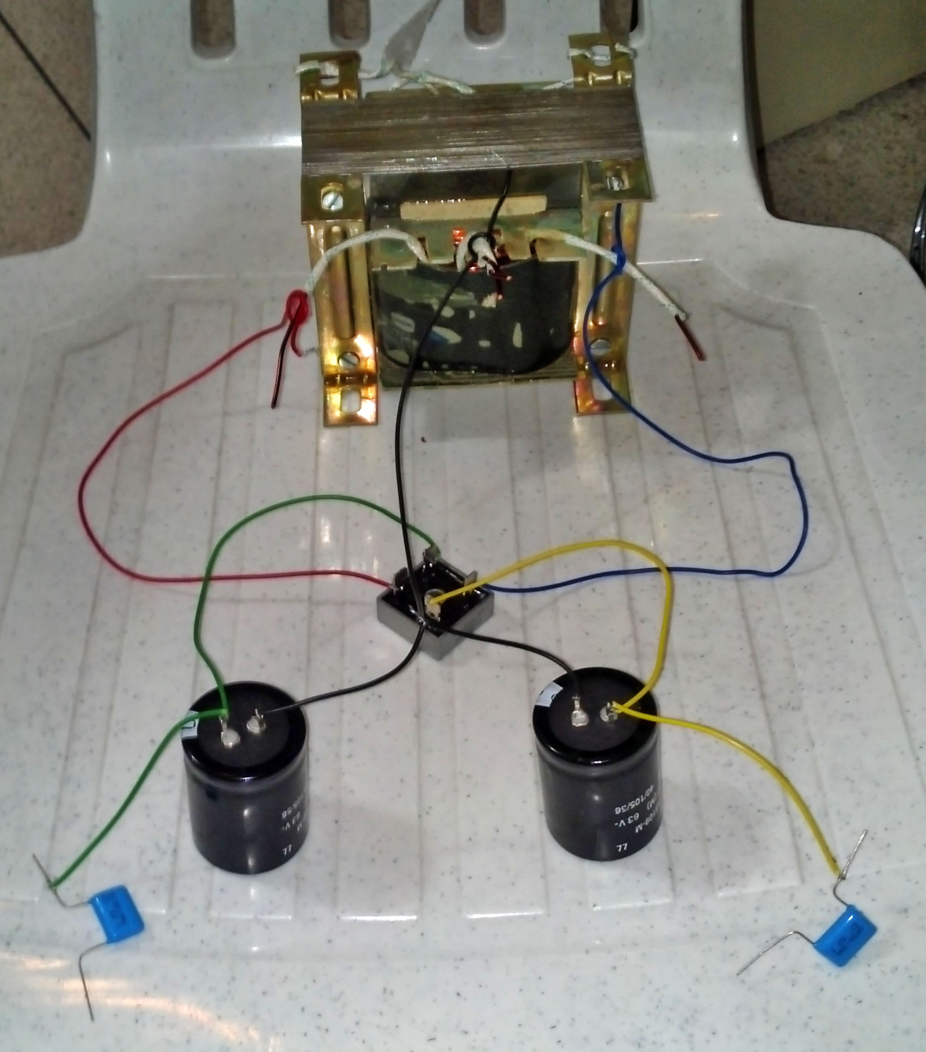

Please have a look at the PSU for LM3886:
Red and blue wires are coming from 24V supplies and black is coming form 0.
35A bridge rectifier : green is from (-) and yellow is from (+)
10000uf, 63V : right side - yellow is connected at (+) and left side green is connected at (-). Black is connected at opposites.
Is that correct?
will the wire from the blue 0.1uf, 100V will go into the amp board?
Where the black wire will go then?
Now can I connect all this to the transformer and power it on?

NO NO.. Do it like this.. and use 18GWS wire for power supply. these wire can't handle more than 1 amp of current.
0.1 uf caps should be parallel to 10000uf caps..
PLEASE.....PLEASE Sir, read all basics about power supply and electronics ones more... try to understand why each components is used and more...
If you continue like this than you will end up with a disaster.

Ive once killed a petty expensive class D amplifie boad...
Got "nice" readings fom the powe supply but you know what...
My cente taps was wired like... I had 48 volts on both sides but 0 between both 48s
What i mean... You transfome has 4 output wires, get multimeter...
Measure resistance to find 2 of the coils, mark the wires...
Now plug the transformer in without nothing on the outputs...
Now connect one of the 24V outputs to the other 24V ouput...
Now measure voltage between both 24V outputs that are alone
You should get eading of 48V or something very close.
If you dont, switch one of the 24V outputs and measure again until you get measurements between both 24-0 as 24V and 48 between both 24V outs.
If you have done that... Go and find serious wires... 1,5mm2 would be good...
Solder one to 0 of the transformer and 2 to the outputs.
Like green 24, 0 black 0 , green 24
The green ones go to your bridge rectifier and 0 remains open till you connect the capacitors.

Post27.
The black wires form a three way PSU Zero Volts.
The picture looks correct electrically.
There are 3 output wires: +ve -ve and Zero Volts.
BUT !!!!!!
your picture shows ENORMOUS radiating LOOPs, that will emit interference and will affect all low level receiver circuits inside the chassis.
You MUST make all the LOOPs small. Very SMALL.
Look at the three wires from transformer to rectifier. Two connect directly to the rectifier AC1 and AC2. The 3rd is the centre tap. This centre tap wire must be twisted with AC1 and AC2 to form a triplet. Leave the centre tap long. Solder AC1 and AC2 to rectifier. Solder +ve and solder -ve to the rectifier. Now using that long centre tap and + & -, form a new triplet. Run this new triplet to the capacitors. Solder + to cap, solder - to cap. solder a wire across the caps zero volts. Solder the 3rd wire of the triplet to that zero volts wire.
Now solder + & - and zero volts to the caps. Form yet another twisted power triplet. Run this triplet to the amplifier.
All the twisted triplets ensure the minimisation of the LOOP areas.

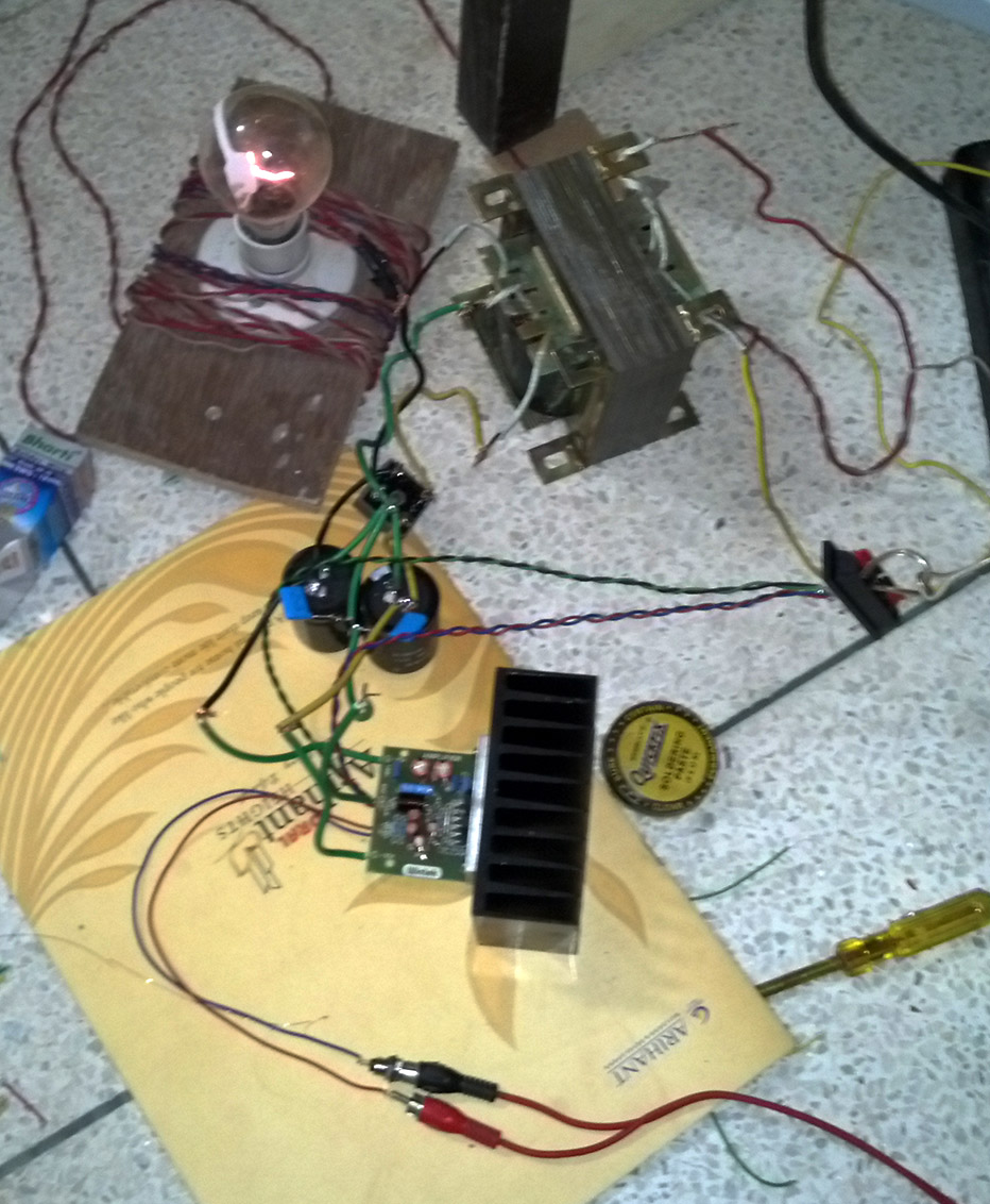

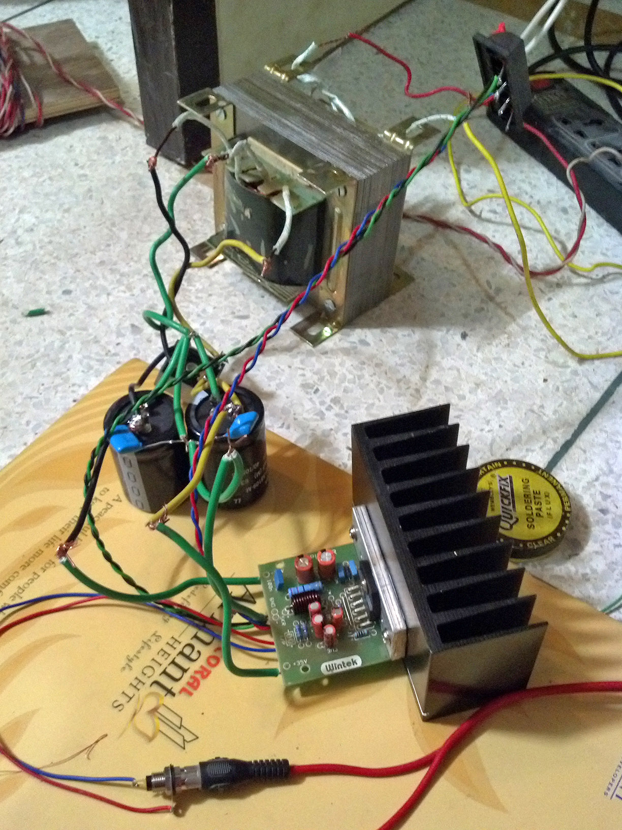

UPDATE:
Finally could successfully test my LM3886 board and the PSU.
Here is the picture of my live sounding setup:
Since it was first time test and I didn't have any fuse with me, I connected a bulb in series between power-line and the transformer. Started testing in steps. First I tested the transformer + PSU. Then I tested AMP board with only power connection. Then soldered speaker input/output wires and tested. Finally I tested with line and speaker connected.
Sound was beautiful, as expected, but wasn't loud enough though I could play only one speaker in mono mode since I have only one board with me right now. Output was room filling but somehow at par with my existing LA4440 based AMP.
Apart form mediocre output, the sound was detailed and clear, loved the quality. Most importantly there wasn't any humming or hissing which my current AMP produces a lot so a big relief. Hope it remains the same when I connect all the 5 amp boards together.
I couldn't find 14-18 gauge wires in the market so used some wires available at home. I used 1100V rated 1.5 mm multithread wires between the transformer and the PSU. After that I used this single thicker thread wire between PSU and the AMP. (Please see the single copper thread green wire shown in the below picture) Is it okay or do I need to replace the wires?

When I opened the volume above 50-60% on the PC, the light bulb started glowing and sound started distorting. Was it due to 24-0-24, 5A transformer? Do I need more powerful transformer? It is happening with single board, what will happen when all five boards will be playing? My speakers are 4ohms. Please see the picture below where light bulb is glowing at louder volume levels:
You are getting distorted sound cos you are having light bulb in series with transformer.
Light bulb is used just for testing.. and i think your testing went very well. now connect transformer directly to main AC and enjoy...
....I couldn't find 14-18 gauge wires in the market so used some wires available at home. I used 1100V rated 1.5 mm multithread wires between the transformer and the PSU. After that I used this single thicker thread wire between PSU and the AMP. (Please see the single copper thread green wire shown in the below picture) Is it okay or do I need to replace the wires?....:
I use wires from dead PC SMPS- they come in different colours, tinned & gauges clearly printed,try local e-scrap dealer. You can also purchase ordinary electrical wires like Polycab 1 sq.mm (multi stranded) from electrical shops. These 1 or 1.5 sq.mm (if you prefer) can be used to connect spk. also. Alt stripped LAN wires can also be used but the insulation is low voltage rated & can't stand heat during soldering. I use these LAN wires as spk. cables. Getting single core wire of good quality is difficult as Govt. agencies issues FR certification to multi stranded cables only.
BTW keep your work area clean(of bits of wires, pins, et.c.) and use some kind of temporary insulation tapes or sleeves or else you will be sending "Smoke signals" to diyaudio
