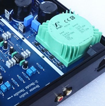

On the right corner there are diodes for rectification, the smoothing caps and as it looks two regulator chips with the heat sinks. The green connector at the upper right side has three connections so you need 2x15V center tapped AC from a simple mains transformer

> power rating of the transformer
It looks like five dual opamps, unknown type. Taking 5mA/opamp, 10mA per chip, that's 50mA DC. Double that for AC Amps, 0.1 Amps AC. 15VAC+15VAC (30VAC CT) seems ample. 30VAC*0.1A AC is 3VA, the minimum transformer.
> less EMF interference
The really teeny 3VA transformers can throw a lot of hum/buzz for their size. I would be looking at 5VA-10VA types. (30VAC CT @ 0.25A)
I do have a doubt. Those regulator heatsinks are WAY bigger than the opamp chips they power. Typically a regulator dissipates 0.6X-1X the heat in the load (opamps). Did they just get a good deal on large heatsinks? Did they spend 2 cents extra to get sinks that look WOW! in the picture? Also the diodes look like 3A jobs when the 1A 1N400x type should be over-ample. I suspect you are right: the designer and the merchant are totally separate parties, good-looking trumps taut engineering, and you won't get technical info from the seller. But hey, it's cheap!! Inspect for bad solder. Wire it up. See if it smokes. With voltmeter black on ground, you expect +/-22V DC on pins of big caps, +/-15V DC on opamp power pins.

Most op-amps only draw a few milliamps at most. As an example, the Texas Instruments NE5532 datasheet shows a typical 8 mA draw per dual op-amp, and a maximum of 16 mA.I'm trying to figure out the power rating of the transformer to buy.
Your board has five op-amps, so 40 mA typical, and 80 mA max draw. Times 30 volts (+/- 15V) that's still only 2.4 watts, worst case. A 5VA transformer will have a nice big safety margin.
Edit: I see PRR beat me to it.
There have been millions of audio circuits built with conventional audio transformers, and negligible noise (i.e. far below audibility)....the transformer will sit next to an audio processing circuit. Would you recommend spending the extra cost for a toroidal or will it be something like a 0.5% more noise with a regular transformer?
That said, this requires good layout and grounding, and distance is your friend - physical distance between the noisy transformer, and the sensitive front-end electronics.
If the transformer is right up against the circuitry, a toroidal transformer will certainly make it easier to achieve good hum and noise performance. If you can find one that doesn't carry a big price penalty, I would say it's worth getting.
I'm a bit concerned about the three transformer-to-board wires, which carry AC with a nasty spiky waveform (because of the way diode rectifiers work), and run right up to the PCB. Wires carrying AC will radiate some noise no matter what type of transformer you use, and wires carrying AC with a spiky waveform will typically radiate more noise and buzz than wires carrying pure sine-wave AC (some of the noise isn't radiated, but coupled to the circuitry through stray capacitance.)
We can only hope that whoever designed the PCB paid attention to detail and made sure this AC-to-board layout still produces acceptable noise.
If I were building this filter from scratch, I would convert the AC to regulated DC on a separate PCB at a safe distance from the sensitive audio circuitry, and then run three wires carrying only DC (which doesn't radiate electromagnetic noise.)
I suggest trying the board as designed. If there proves to be too much hum and buzz, you can always convert the AC to DC off-board, and feed the board with DC. The on-board diodes won't have much work to do, but the board should work just fine.

Very interesting. This is in fact what ESP does, separate power supply that feeds the LR board with +-15VDC.
Could you clarify on what is acceptable as input on the three pins of the board since by design it wants +-15VAC (and by +- I mean phase of course). What other configurations could make it work the same way? The way you describe it is sounds like I can just substitute +-15VAC with +-15VDC and eliminate AC noise, if it's there.
Without actually seeing the board (or better, the schematic for the board), I'm making an educated guess. (It might help if you provide a link to the board you bought.)The way you describe it is sounds like I can just substitute +-15VAC with +-15VDC and eliminate AC noise, if it's there.
I can't actually see that end of the board in the photo you posted, but it looks as though it has four diodes onboard. Almost certainly they are wired as a full wave bridge. The two ends of your 30V AC transformer winding feed the bridge, and the centre-tap (the "0" in the 15-0-15) provides a voltage halfway between the other two.
As designed, the four diodes rectify the incoming AC, steering positive half-cycles to one supply rail, and negative half-cycles to the other.
Now, if you replace your transformer with a +15V DC, 0V, -15V DC power supply, everything still works normally. Only two of the four diodes in the bridge will be in operation (because the incoming voltage never reverses polarity). Those two diodes won't be doing anything useful, because there is no AC to convert to DC. But they'll still conduct, and allow the incoming DC to flow through them.
So yes, all you have to do is connect +DC to the point on the pad where you normally connect one end of the 30V AC winding. 0V DC goes to the same place the centre-tap of that 30V AC winding would otherwise go. And you connect your -DC where the other end of the 30V AC winding would have gone.
15 V AC RMS (one half of the 30V winding) rectifies to about 21 V DC, less two diode losses of about 0.5 - 0.7 volts each. Each voltage regulator chip on your board is therefore being fed something close to 20 V DC, either + or - as appropriate, which is then regulated down to +15V and -15V.
If you choose to power your board with DC rather than AC, you'll want to provide a similar voltage - roughly +/- 20 volts DC.
You can get this from a modern switching supply or two, or from an old-fashioned 60 Hz transformer, toroidal or otherwise. If you use a transformer, you'll want a 15-0-15 VAC transformer...because after you rectify it to DC (off-board), it will turn into the +/- 20V DC you need.

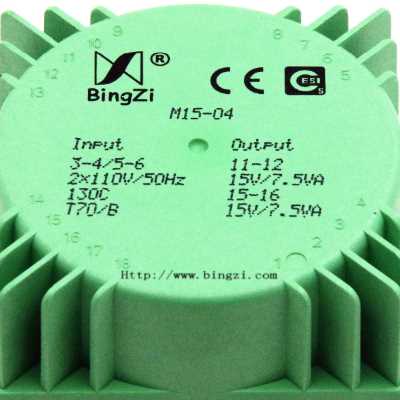

Given things on the board are as you suspect, it's just as I imagined. Substitute AC with DC, just with a different amplitude.

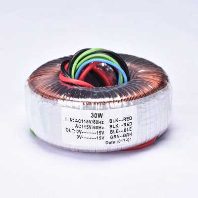

I found a completed LR product there in the far east, and zoomed into it's toroidal transformer:
And further research shows it's this, it's a PCB mounted version:
So the people in the far east are using a 15VA transformer. Perhaps they are aware of noise problems at lower power ratings. Perhaps it costs the same to make a 10VA transformer. I trust you guys however, in that this board's demands are nowhere near 15VA.
This green thing costs something like 20$. I almost got it until I found a different toroidal, 30VA mind you, for something like 13$ so I just snatched it. If it works, cheap is good in this case:
It has a dual primary winding so I imagine I have to very carefully connect them in series so that it properly works in my country (Greece, 230V-240V) and nothing blows up.
So I am super excitedly waiting for these two components to play with.

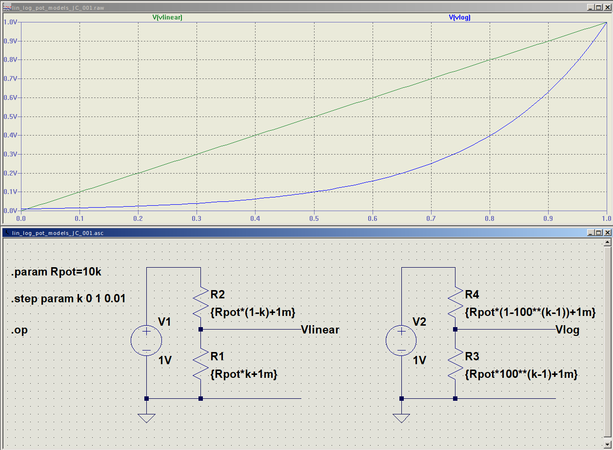

I've worked in PSpice (and priors) for 30+ years and still find little tricks.
I noted something in LTSpice which can be useful. After a DC (.op) run, if you hover parts on the schematic, the power dissipation appears in the bottom of the window. (At least resistors and batteries; don't have a tube/transistor on the bench yet.)
This would almost be useful for a question which came up elsewhere: what resistors to use for a HIGH power switched attenuator. He had plan and values but not power ratings. The problem can be solved with DC: put 28.28VDC in, that's same-as 100W @ 8r. But the resistors are in two switched strings, 8 steps, any one of the resistors "could" be the hot one (inspection will suggest the worst case but I guessed wrong a few tries), so 8*18=144 values to compute. A spreadsheet would do it in an instant but setting-up would a tedious chore. (I advised building with all 10W, spread out, feed 24VDC, nose/finger check for hot or cold parts, watching that output voltage is nominal (nothing blew yet).)
Do you use pot? Does your pot blow-up if setting is zero or 1? (Divide by zero error.) There is an elegant fix. Maybe everybody knows but me.

I've used that trick too. A very useful tip.After a DC (.op) run, if you hover parts on the schematic, the power dissipation appears in the bottom of the window.
There is also a way to manually enter an equation to plot, and that equation can, for instance, be (some current) * (voltage1 - voltage2), so you can plot power dissipation in a device against time if you want, even if that device has no grounded terminals.
A while ago I was trying to design a variable guitar amp speaker attenuator, but the input impedance needed to be reasonably constant at around 8 ohms. The question was how to calculate that input impedance across the audio frequency range (the attenuator included reactive elements as well as resistors.)
In LTSpice, I found I could insert a 1 milli-ohm resistor in series with the input to the attenuator. That makes the current into the input port easily accessible within LTSpice. With that available, I could then plot (input voltage / input current). Voila, input impedance as a function of frequency!
More on how to enter your own equations to plot in this tutorial: https://www.digikey.com/eewiki/display/Motley/LTspice+Tips+-+Plot+Manually+Entered+Functions
The pot model wasn't included when I downloaded LTSpice (apparently it was included in some older versions), so I rolled my own, see attached image.Do you use pot? Does your pot blow-up if setting is zero or 1?
The good: I was able to figure out the equations to make a standard audio-taper log pot, as well as a linear pot. They're in the attached image.
The bad: doing it this way doesn't look like a pot on the schematic, just two ordinary resistors. Understandably, this confuses people.
The ugly: I was able to prevent the equations blowing up at zero pot rotation by adding 1 milli-ohm to each equation. It works, and the error is negligible when the pot resistance is much greater than 1 milli ohm. But this kludge is far from elegant. 😱
The ridiculous: I attempted to follow a couple of tutorials on how to create your own pot model (which means it looks like a pot, and uses the equations you type in.) I failed two or three times, then decided it wasn't worth spending more time on.
I also downloaded the old LTSpice pot model from somewhere and tried to incorporate that into my version of LTSpice. The results were erratic and unreliable, so after more wasted time, I gave up on that as well.
These days I feel that what's left of my life is too short to waste hours struggling with uncoperative software. So if I find a workaround, I take it, and move on.
