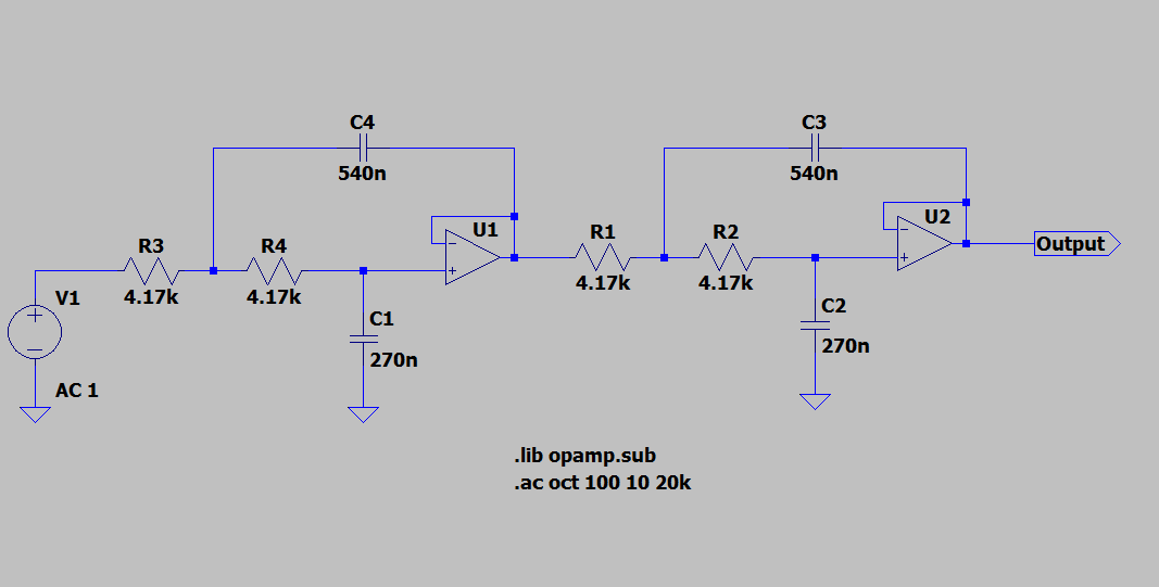

Because my knowledge of math (especially complex math) is a bit rusty, I 've just downloaded and installed LTspice and will go down that route.
Thankfully, Elliott Sound Products provides a utility that shows the filter circuit and also calculates resistance and capacitance for a given cutoff frequency. So I have everything I need handy:
Now I need to get acquainted with LTspice, put the circuit together, and get my curves. I 'll keep you guys posted.

Thanks (Gno)buddy! I wholeheartedly thank you for the tutorial link, because last night I managed to build the LPF portion of the filter but hit a brick wall while trying to run an AC simulation. I hope the tutorial will solve my issues. If I get really stuck I may ask you guys/gals for assistance.
Resounding success!
I only had to read up to the first part of the tutorial. Upon starting the simulation, the frequency/phase response window appeared, but with no output. All I had to do is touch the probe to the output of my circuit:

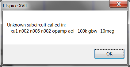

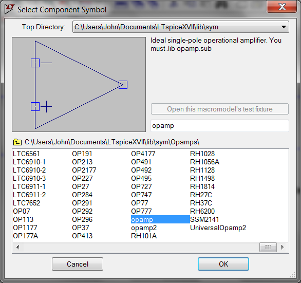

Building the circuit, I could not find any of the common op amps used in LR designs I find around the web. Moreover, most op amps had 5 pins and not 3. So I thought simply and used a simple ideal component named just "opamp":
However, when I tried to run the simulation, I got the following error:
It only got resolved when I used the ".op" button to add ".lib opamp.sub" on my schematic. To be honest I find it strange that things like directives or the AC sweep settings are written on the schematic, as they can be perceived as comments.
I'm just curious what this opamp related directive does and why it is necessary. (I suspect "real" opamp models do not need anything like this).
Yes, Linear chose to provide mathematical models only for the chips they manufactured.
Fortunately, you can add external models, and Google will usually turn up the one you need. I tend to use only two types of op-amps in my own circuits, the NE5532 or the TL072. I found models for both online, and insert them into my LTSpice simulations as needed.
You can even find models for vacuum tubes, though many are of dubious accuracy. The attached image shows a simulation I did recently as part of a discussion on the proper way to choose the value of the cathode bypass capacitor in a typical tube guitar amplifier preamplifier stage.
(There is a wrong formula that is widely used, and this simulation shows what's wrong with that formula. If the formula was correct, both gain stages would have the same identical frequency response. The simulation shows that this isn't even remotely true. Ergo, the formula is wrong!)
For more information on how to use external models with LTSpice, look no further than part 4 of Simon Bramble's LTSpice tutorials: LTspice Tutorial: Part 4
As far as I know, this tells LTSpice where to find the mathematical model of the particular op-amp you are using. That model will include equations describing such things as the open loop voltage gain of the op-amp at DC, and the poles and zeros that define the open-loop frequency response.

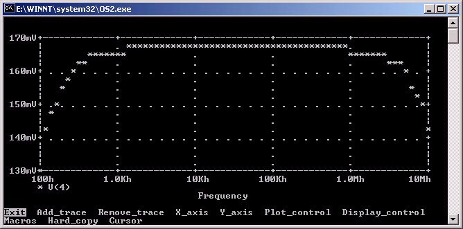

PRR
Joined 2003
...I thought just labelling my output would automagically include that label...
It isn't smart enough to know what "output" means. In the sim image I posted, I had to place the circle-arrow thingie to easily get a plot of that point.
Yes, I could also type a "command line" into PROBE to get data about an arbitrary un-labeled un-pointered point.... the syntax does not come to my fingers that easy.
(All this plotting stuff is "outside" SPICE, traditionally in a module called "PROBE". Which originally printed ASCII characters on greenbar paper. The input to SPICE was originally punched-cards, and remnants of that technology can still be found in the internal workings. Also it comes from an era when not all terminals had lower-case characters. When FORTRAN was the only good way to work formulas. Yes, SPICE was soon re-written in C, but it had to preserve many FORTRAN conventions to keep compatibility.)

...originally printed ASCII characters on greenbar paper...
A version of Spice that printed ASCII characters to a text terminal (in lieu of graph paper) was still available on Linux a few years ago. I think it's still available today.
There are a few truly Free (no cost, open source) graphical frontends too. I haven't tried using any of them, though.
If LTSpice had been open-source, it would be looking and working much better by now. As it is, it feels like a view back to the aesthetics (using the word loosely) of Windows 95. Thick-bordered windows in a fetching shade of mouse-fur grey, jagged fonts, clunky icons, et cetera.

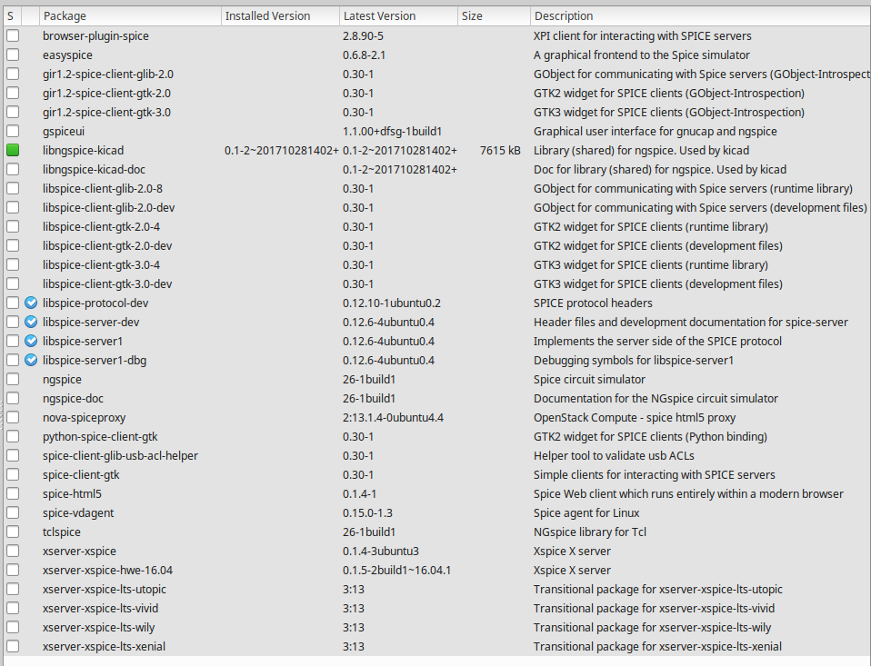

It would be very interesting to find a strong open source version of this tool
A tonne of things with "spice" in the name pop up if I search my Linux distribution's package manager (see attached screenshot.) But I don't know if any of them is developed as far as LTSpice, or ideally, better.
Kicad - an open-source schematic-editor and PCB design program - now includes some circuit simulation capabilities too, I think. And they're probably based on the SPICE engine.
Kicad's origins go back to the 1990s, but researchers at CERN began using it and improving it about five or six years ago, and progress has been rapid since then.
If you find an open-source SPICE variant that is as good or better than LTSpice, please do let me know!

Thanks for the plot settings tip.
From your screenshot, ngspice + ngspiceui may be a strong contender. ngspice is cross platform but apparently command line based, so the question mark is how good ngspiceui is.
I did a quick search earlier and found a tool called qucs that seems to be good, although it's not spice based (I think).
And a sweet quick link: gplEDA Homepage

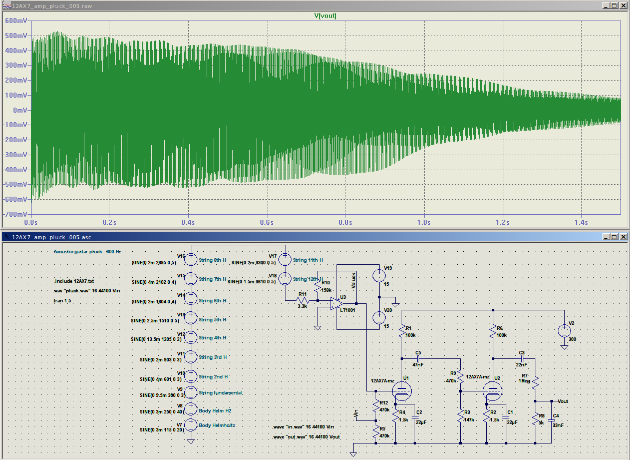

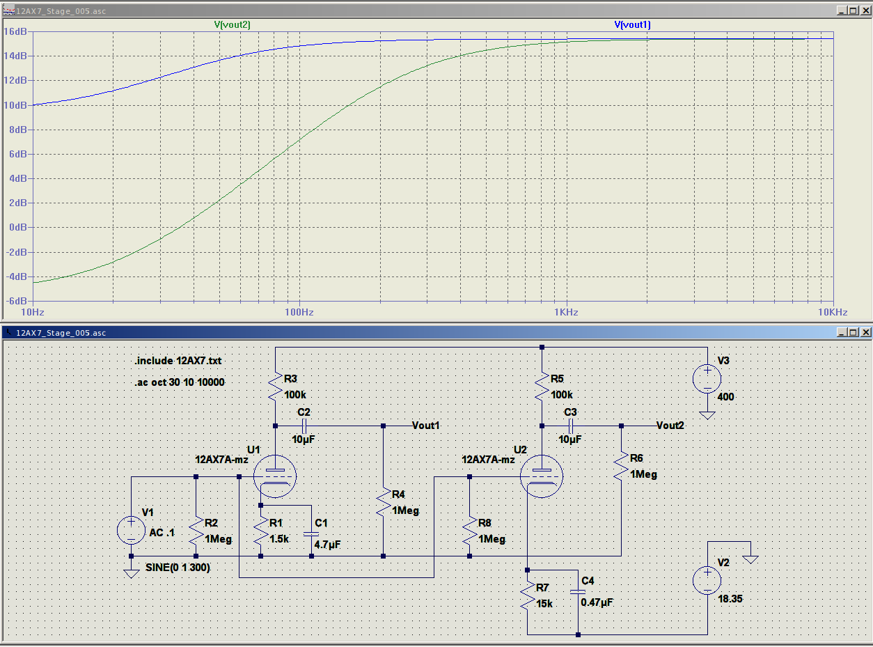

The attached screenshot shows one of my LTSpice simulations. A dozen carefully tuned damped sinewave generators generate a waveform approximating what you get when you pluck a guitar string; this waveform is scaled by a simulated op-amp, then fed to a simulated two-stage vacuum tube guitar preamp, and the resulting output waveform is computed. Finally, the output waveform is also turned into a WAV file that I can listen to.
What I found from this and similar experiments is that the DC bias levels in the triode stages fluctuate during the duration of a single guitar note; those fluctuations in bias translate to fluctuating amounts of distortion that add subtlety and richness to the guitar tone. The envelope of the note is altered too, rounding off the harsh initial attack.
You do not get these effects when you use an almost-perfect device like an op-amp to amplify the guitar signal. You also do not get them from the majority of guitar distortion pedals on the market, 99% of which use an op-amp and a couple of clipping diodes to generate unvarying, unsubtle, boring distortion.
I cannot imagine how much DIY code it would have taken to do something like this without SPICE - certainly I would never have taken on such a project!

...A tonne of things with "spice" in the name pop up if I search my Linux distribution's package manager...
Many of them not "our" SPICE.
A lot seem to be "Simple Protocol for Independent Computing Environments", "allows users to view a computing "desktop" environment ... from anywhere on the Internet".
Easyspice and ngspice seem to be e-sims. NGspice is fairly well known. It harks back to planning your sim on paper and punching cards/lines (no schematic editor), although third party interfaces are available. Their Resources Page is worth a look.
I focused on ngspice last night, going through their resources pages. It seems to be a mature simulation engine and the good thing is that it is integrated in more complete software packages that provide luxuries like schematic editing. I started downloading eSim and KiCad last night but transfer was interrupted due to a battery outage. I 'll try to build the same circuit for the LR crossover in both of them, see how well they work (or not).

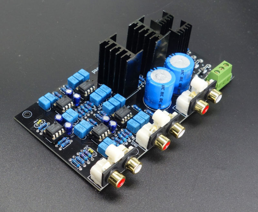

Speaking of the LR crossover, I decided to snatch a cheap implementation of it for further experimentation. Sadly, the good people in the far east that sell it seem to not know what they are selling:
My specific query is about powering the unit. Their product description states:
"8. AC adapter power supply range Dual 14 to dual 19V"
Now, I can not understand if this means a regular center-tapped-secondary transformer (+-15V AC) or simply +-15V DC.
Can you guys tell by the looks of this board which case it is? Because honestly I do not expect a reliable answer from the seller. If the power input is +-15V AC there should be additional components for DC conversion to feed the opamps.
