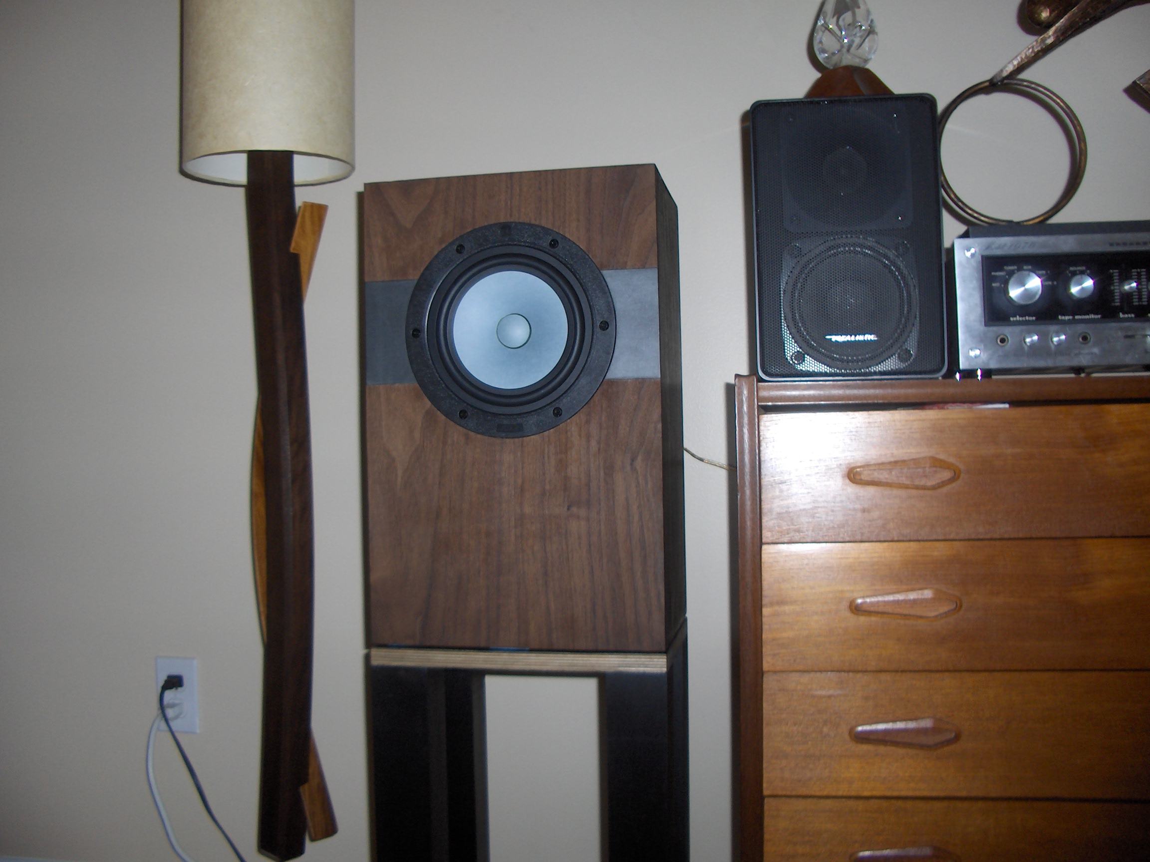

Hello DIYer's,
I finally completed my second build and satisfied with the result.
Here's a brief description:
* Mark Audio Alpair 12.2p drivers
* 19L Baltic Birch rear ported box.
* bracing side to side and back to front.
* 1 inch felt covers the inside wall.
* walnut veneer on front and top, the rest is stained.
* the stands are also DIY and stained black.
I only have about 40 hours in them. They sound OK and I'm hopping that things get better. They are detailed but lack bass, which I expected and I accept it.
