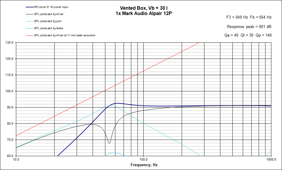

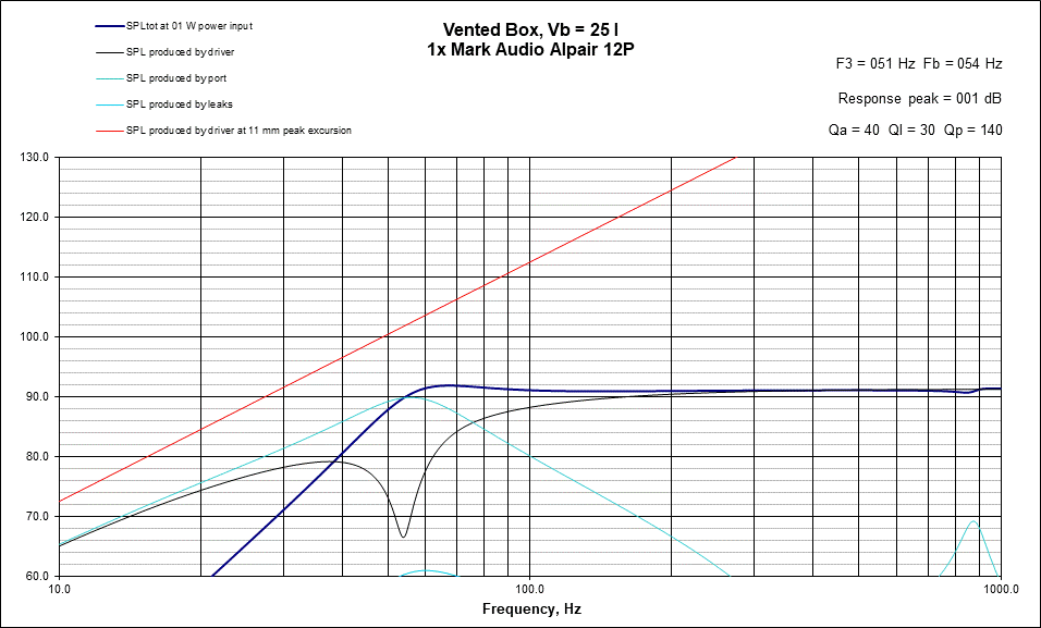

I would need some help in deciding which one of these 2 enclosures give the best measurement for the Alpair 12p.Can someone please run these numbers through some measurement software and let me know which one to build? Obviously, I am open to minor dimension alterations.
I tried playing with WinISD but for some reason I could not save the driver's T/S parameters.
Box 1) internal measurements= 24cm X 39cm X 27cm
Box 2) internal measurements= 24cm X 39cm X 32cm

How do you define 'best', and what tuning frequency[ies]?
I'm currently on my laptop so can't look closely at this precise moment in history, but assuming a voltage source amp both look significantly over-sized for the 12P assuming a regular vented box, so will either have a large peak at tuning if tuned relatively high (unless heavily damped), or some form of quasi EBS alignment if tuned relatively low, so may lack LF output unless either boundary-loaded, or used with a high output impedance amplifier / equivalent series resistance.
...and as far as vented is concerned, as predicted (and several of us have pointed out previously) those sorts of volumes are somewhat over-sized for the 12P short of a relatively high output impedance amplifier, with underdamped (peaking) alignments at tuning under anechoic conditions (attached, assuming 1ohm output impedance). With a rear vent and near-boundary positioning, you are likely to experience more significant gain peaking at tuning, and potentially a 'one note' / 'on-off' effect due to that and the relatively narrow vent tuning, unless the boxes are heavily damped. Power handling may also suffer somewhat, and you may encounter some self-resonant effects (standing waves) in the duct due to the length / CSA ratio, although the rear position should mean this latter is unlikely to be a significant problem.
Generally speaking, I've seen worse, but they're not what I'd call particularly good alignments.

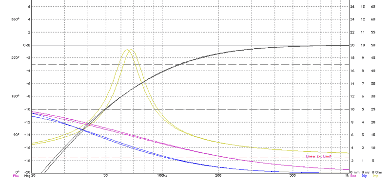

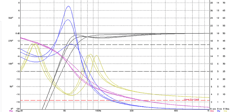

Now armed with the tuning frequency.
You can see the bump Scott talks about.
My first rule of vented boxes is that the 1[su[]st[/sup] derivative of th eFR curve shoud not cross zero more than once.
You can see your 2 (poor) alignments along with one in 17 litres that is decent (not the one i use in the Mar-Kens, i have to account for another facet of my designs.
dave
