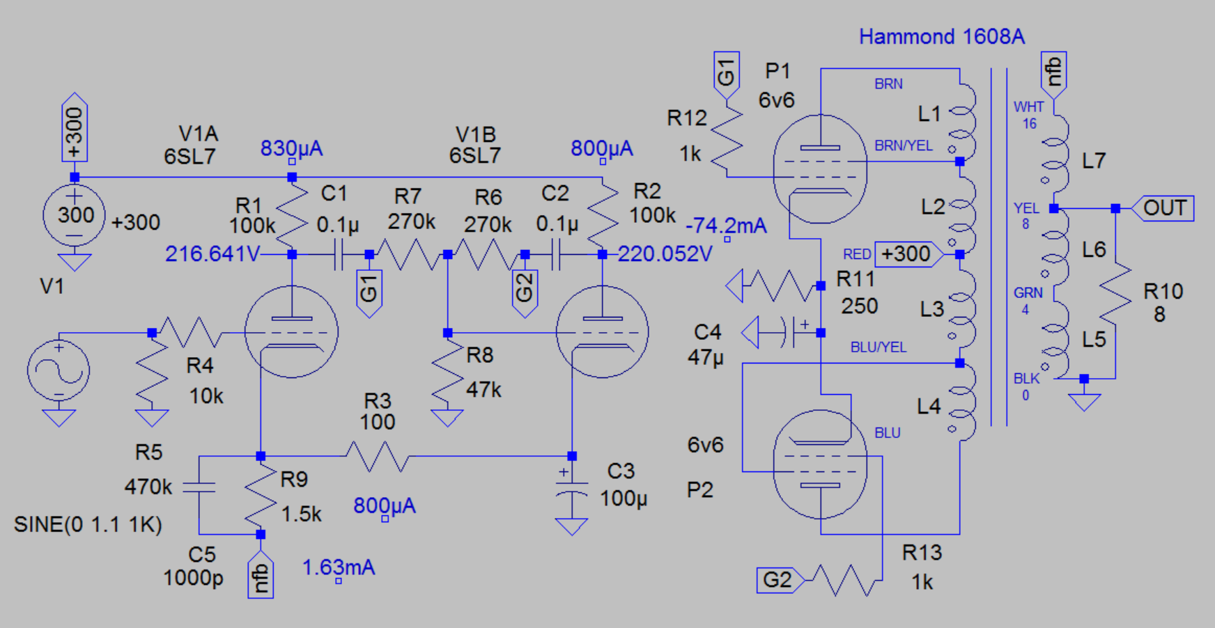

To make things simpler and easier for my first build, I opted to build a published design (DIY Push-Pull (PP) 6V6 / 6V6GT Tube Amplifier Schematic)

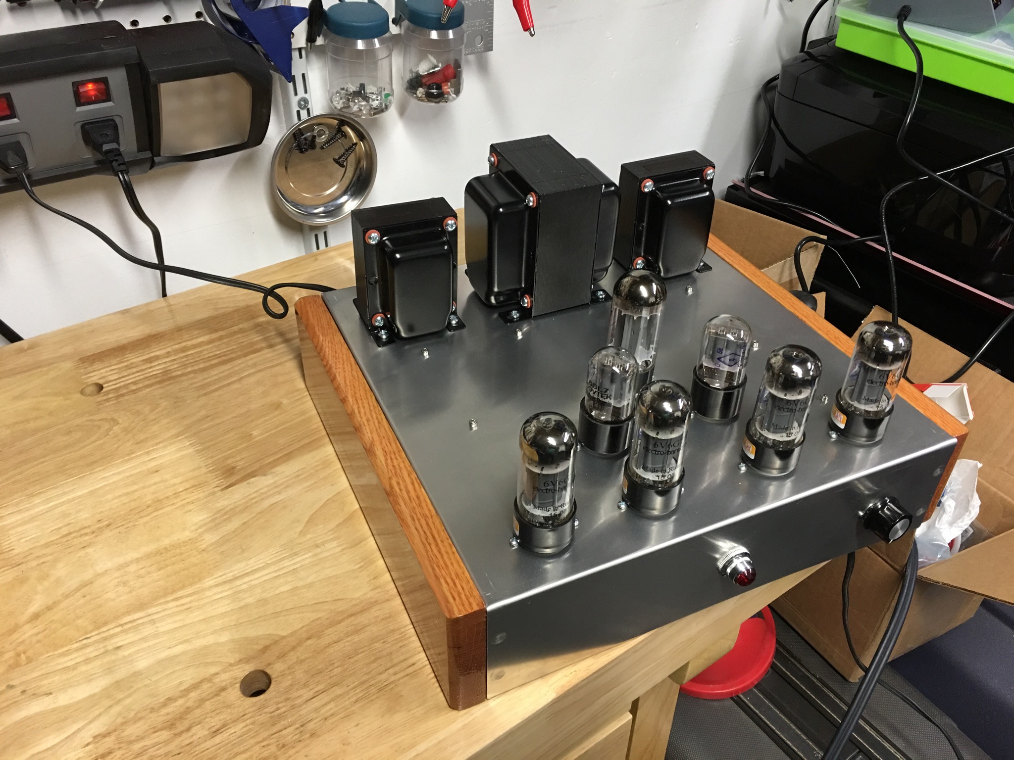

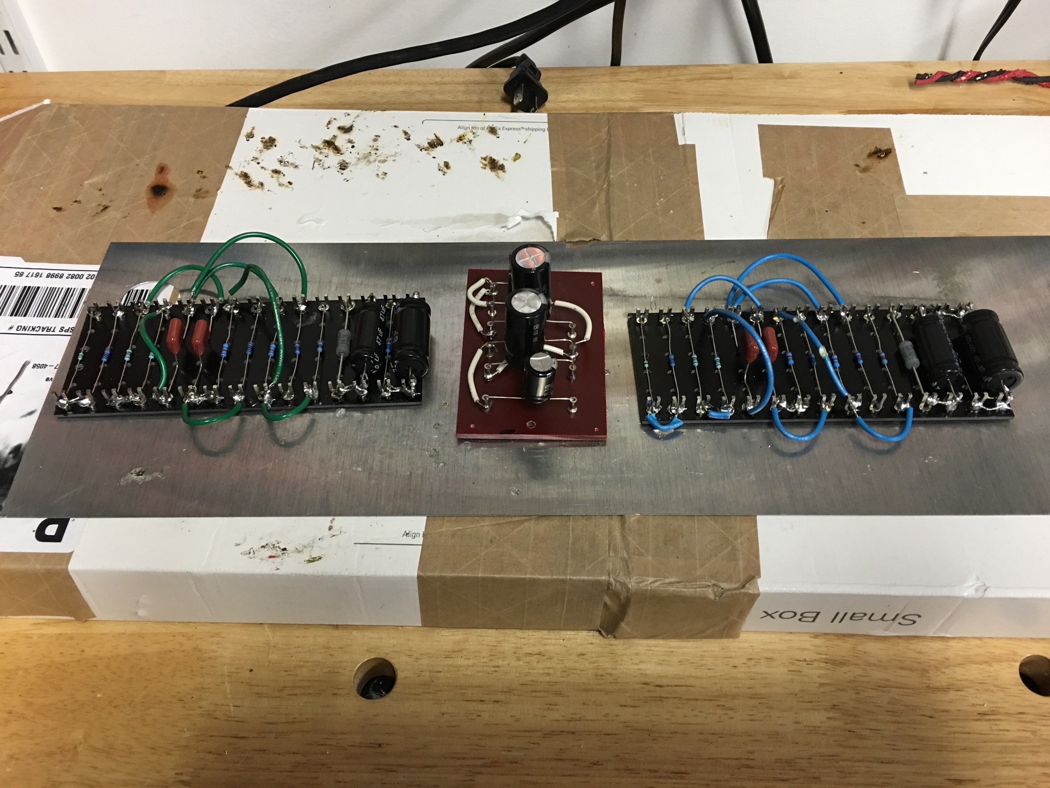

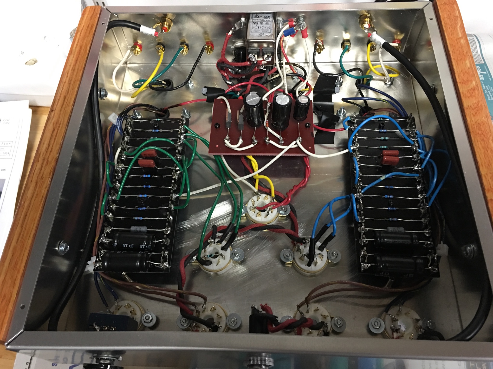

I've attached a few pictures of the build but understand that they may not be very helpful. I can take more pictures of specific sections of the amp if needed.

If I increased the ac voltage any further, the speakers started emitting a high pitched whine.
This sounds like possible positive feedback caused by the global feedback from the OPT secondary back to the input cathode. The feedback should be negative. The quickest way to test this is to reverse the plate wires from the output transformer to the 6V6s. With positive feedback the amplifier will be driven hard as an oscillator and can/will cause the fuse to blow. This is a common occurrence with first time power ups.

When you suggest to reverse the plate wires from the o/p transformer to 6V6, is this the brown and blue wires on the 1608A going to the 6v6 plates? If that is the case, then should I also be reversing the screen wires (brown/yellow, and blue/yellow)? I am referring to the color schemes from this document (https://www.hammfg.com/files/parts/pdf/1608A.pdf)

Yes, that is correct. Reverse both the plate and screen wires. doing so changes the phase relationship at the transformer secondary.

Nice job, BTW. I really like the turret boards.

I'am a little suspicious of gNFB that could load down the output, 1.5k and 100 ohms and 100u. If I use 6L6 in place of 6V6, the sim shows it oscillates.

Mr_Zenith, I enjoyed working on the turret boards. Got some parts from Tubedepot and designed the power supply board. The signal boards I did not design. Got them from Angela Instruments so could not plan the layout more efficiently. Learnt my lesson and designed the power supply board layout after that.
