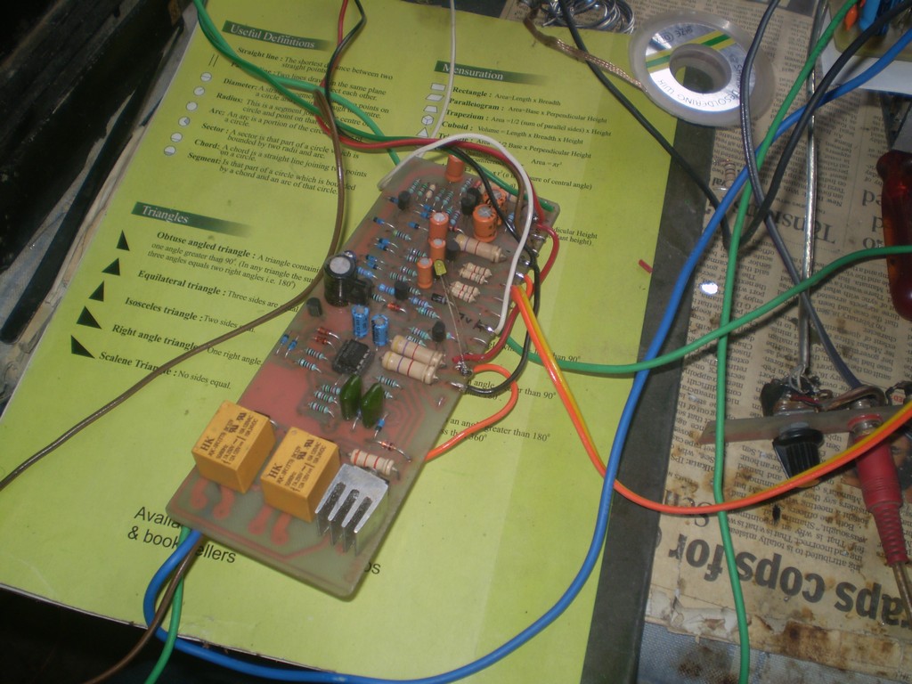

I need amplifier protection for 1000w rms 8ohm amplifier AB class
short circuit protection on output of the amplifier its not for home use

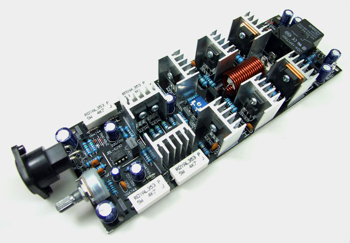

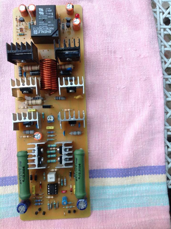

I have built 2x800w rms 8ohm amplifier with 10MJ15003 10pcs per chanel
I have protection circuit for that amp but I dont know is it going to work on the amp I posted shematics its shunt resistor sensing circuit with temperature dc short protection and power on delay led indicators for all
Dont worry I was working with lethal voltages all my life tesla coils etc
The schematics I posted is just for driver stage Im planing to put 14 pairs of output transistors 2c5200/2sa1943
Regards

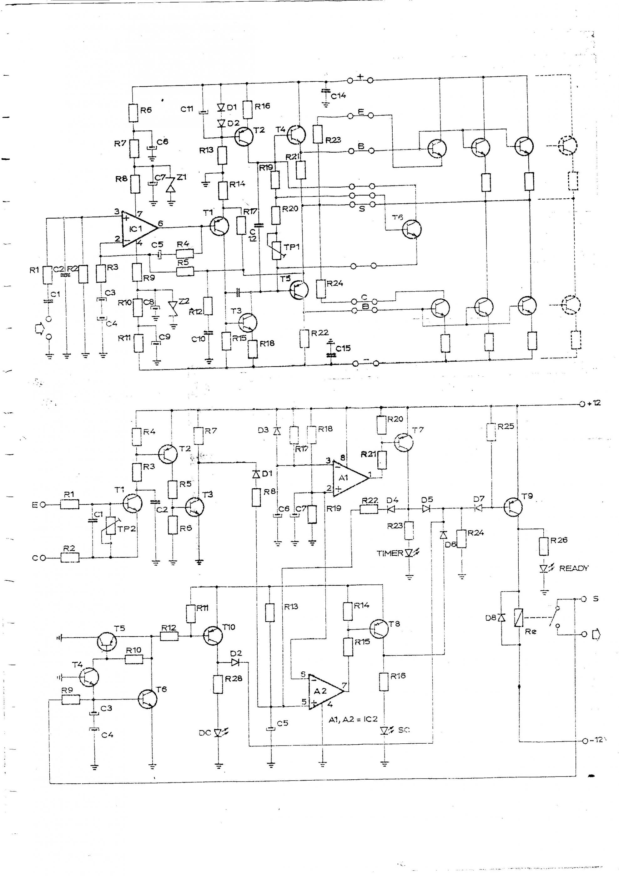

Here is the shematics of amplifier that I built 2x800w rms 8ohm with protection circuit 10x mj15003
How to connect this protection circuit with AB class amp that I posted schematics on the first page with 2sc5200/2sa1943
Protection circuit is under the amplifier circuit
Regards

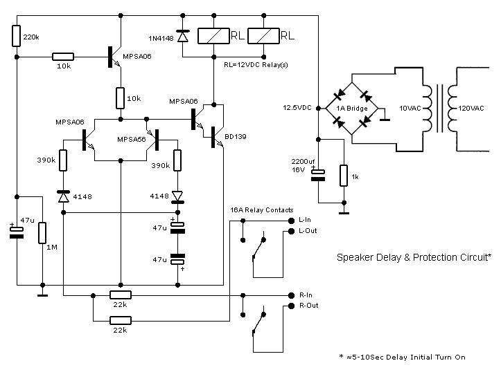

Well, here's my two cents worth. I'm using this on a Phase Linear 400 and it works great, at least for DC protection and turn on "thump" delay...
The back to back 47uf caps should be at at least one quarter of one rail. They could potentially explode if the DC goes too high should a short occur, but are isolated by the 22 ohm resistors. (On the PL I upped them to 47k to help protect the circuit)
Also, you can use one DPST relay instead of two SPST as shown.

I this only DC protection and thurn on delay no short circuit protection for output transistors?

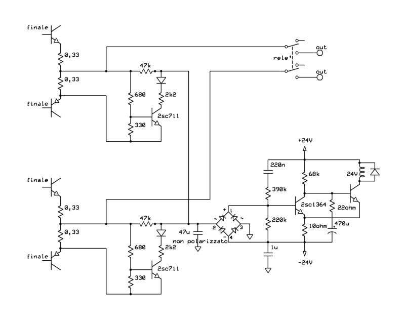

Hello
greetings jbl driver completed and tested nice sound but there are better
driver stage schematics much easier and better sound found this protection
while surfing does it look ok

I will need protection with Short , DC , Temperature,fan regulatin, power on delay,
clip ,sig pro ,power led indicators all in one
I have protection with all of than I dont have protection for short
How can I combine 2 protections in one
