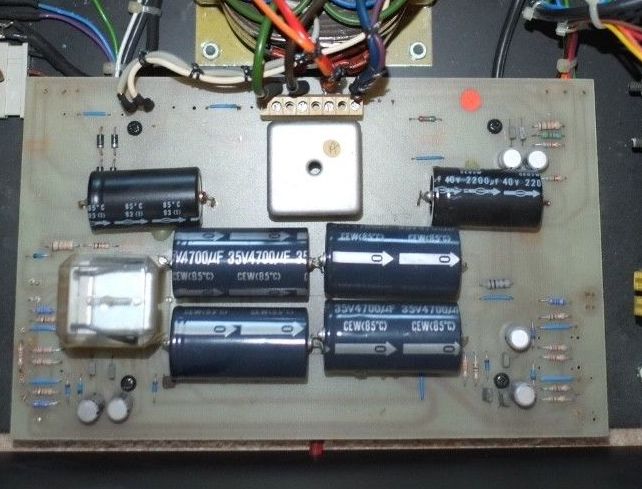

Pic of powers supply
I think the way forward is to get the power supply working and protection cct working.
So back in with the relay, do not connect power to either channel. Then just switch on....see what happens. If it doesn't trip measure voltages. There are 2 voltages one for driver supply one for power transistor supply.Something like 27v and 34v.
If it does trip we need to troubleshoot power supply.
Hi Tony,
Sorry should have mentioned that the relay is actually back in. Ok no problem I’ll disconnect both boards this evening and see what happens. If nothing untoward I’ll connect the good one test again and then the duff one. That relay should close in protection mode shouldn’t it?
Thanks again
Joe

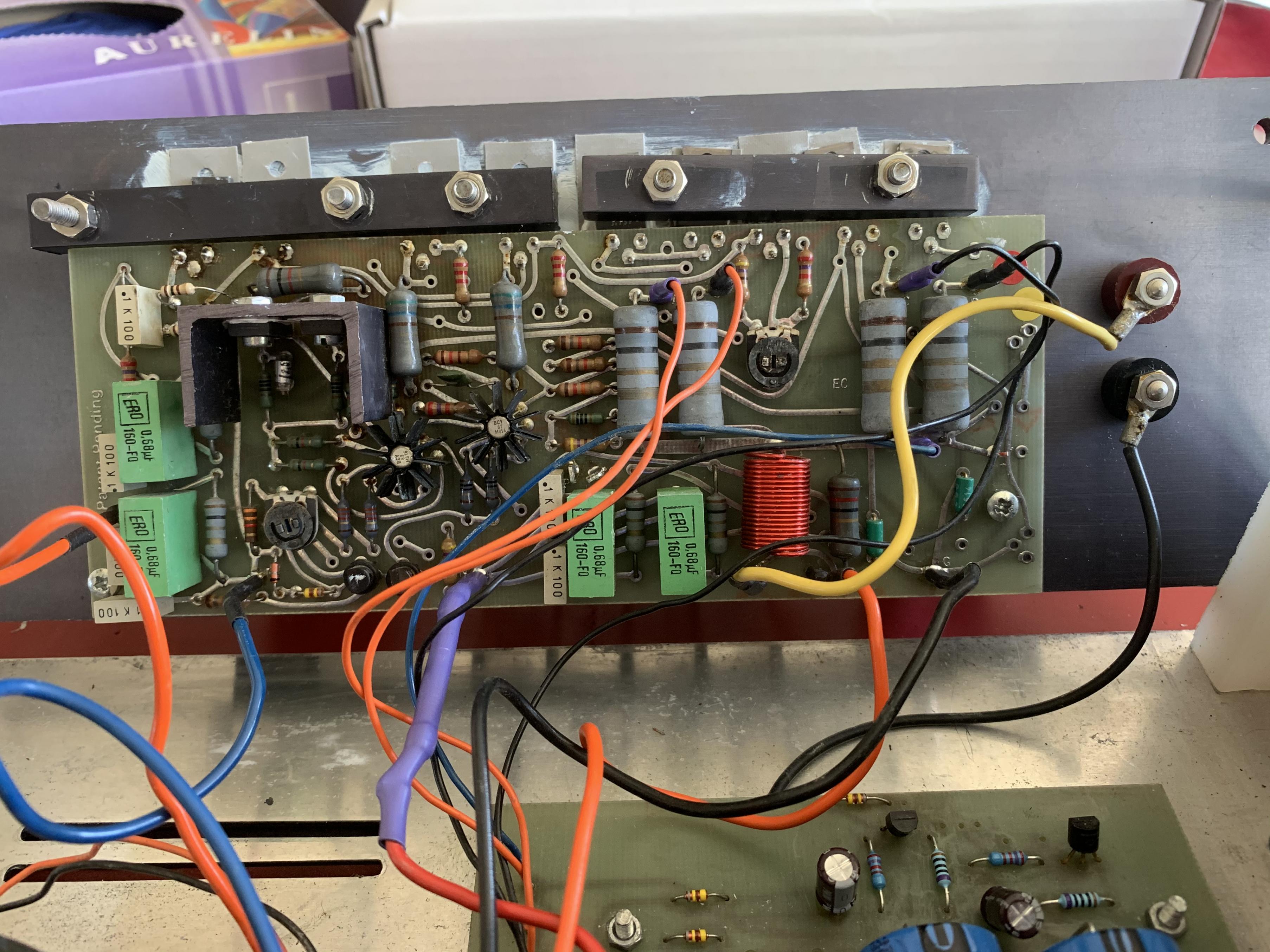

Hi Tony,
ok here's the results please see photo for orientation:
1) all connections to the boards removed - no relay activity at all on power on.
2 The following voltages are present:
+32V at LH orange wire
-32V at Blue wire
+27V at bottom orange wire
No -27 voltage at all on any wire.
All measurements taken with DMM black lead connected to speaker neg.
So I imagine the absent -27V is important - on the other amp is present and correct at the black wire. So why its AWOL on this one is beyond me?
Ref the additional connections: these are 2 x thin orange and 2 x thin black wires - these are above the big resistors. The thin blue looks like it comes of the ground(?) below these.
The only other wire is red which has a resistor in series and shows continuity with the ground speaker terminal.
So odder than an odd thing from oddsville.
Any thoughts are apprieciated.Thanks for your time.
Kind regards
Joe

Hi Tony,
yes indeed - the fuse had blown. But on replaceing and rewiring - the protection circuit kicks in straight away.
If I remove all the wires on the no bias board - leaving the other board connected - the relay stays open. I also have -27V on that black wire.
So a continuing problem with the one amp board.
So the only components not changed on this board are the caps and one Large 10K resistor and the two 140 Transistors and the diodes, so I'll check these and see where I get.
When changing the resistors like for like values were placed so nothing odd there, so either one of the through board connections is off or shorting or the transistors or diodes are oc?
Thanks again for your time.
Ref the fuses - 5amp/250V 20mm OK or do you have slow blow in yours?
Joe

I suspect outputs suffered thermal runaway. I would perhaps check voltages across emitter resistors to determine either BD 203 or BD 204 are faulty.
Thought the fuses were 3.15amp.
Best of luck
Hi Joe,
Yes I thought they had failed.
What are the fuses protecting, output devices have protection cct which works quickly so why fuse failed?
Certainly I would check further before switching on again. Perhaps a DMM check on components compared with the good side.
With hindsight the 5 wires 2orange 2 black 1 blue are the protection cct sensors directly to emitter resistors

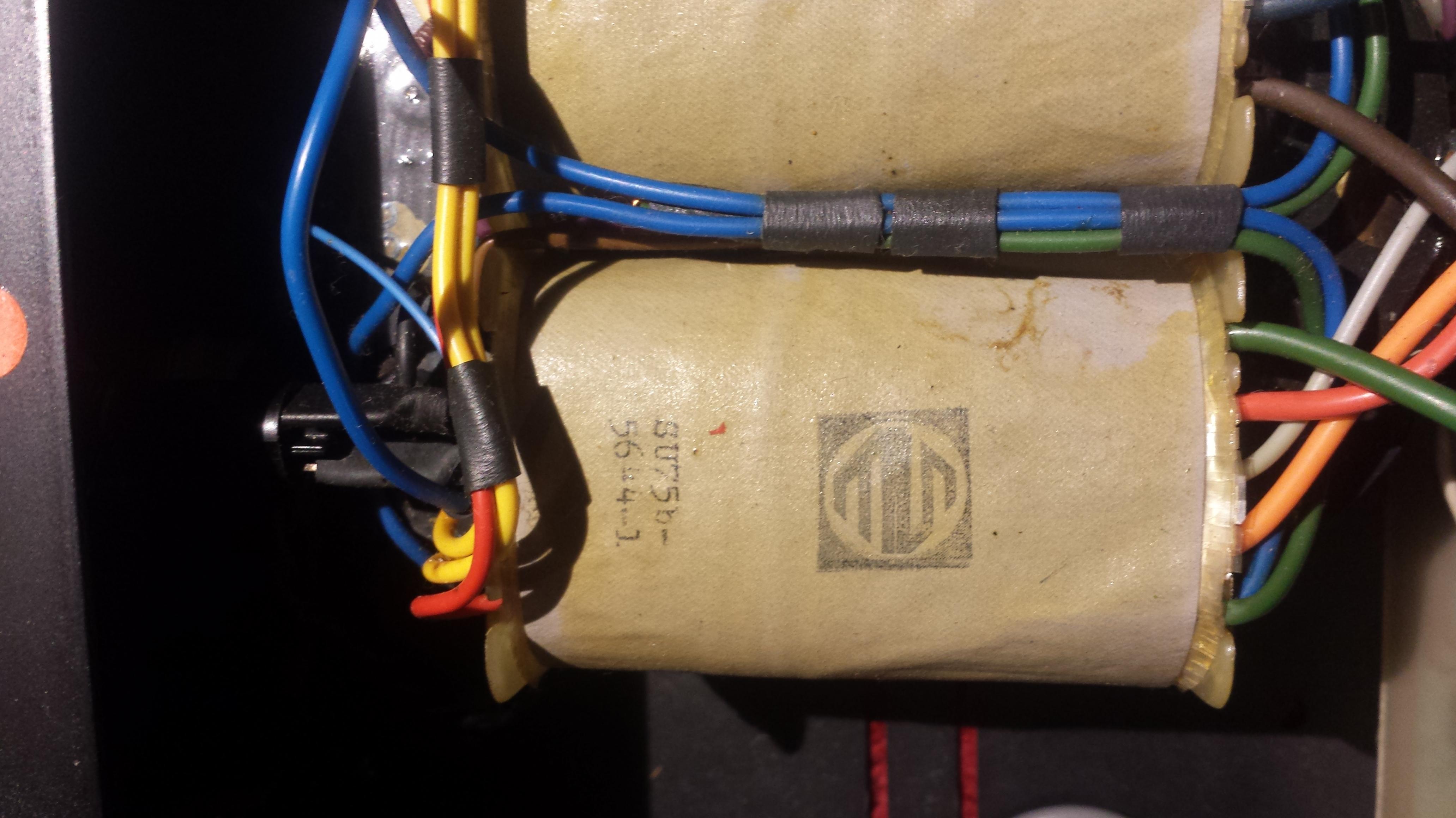

Hi Tony,
your transformer, does it have any information on it - one of mine has a pronounced buzz which lessens if the straps are made tighter. I wondered if repacements were available as the laminations have probably started to come loose?
Cheers
Joe

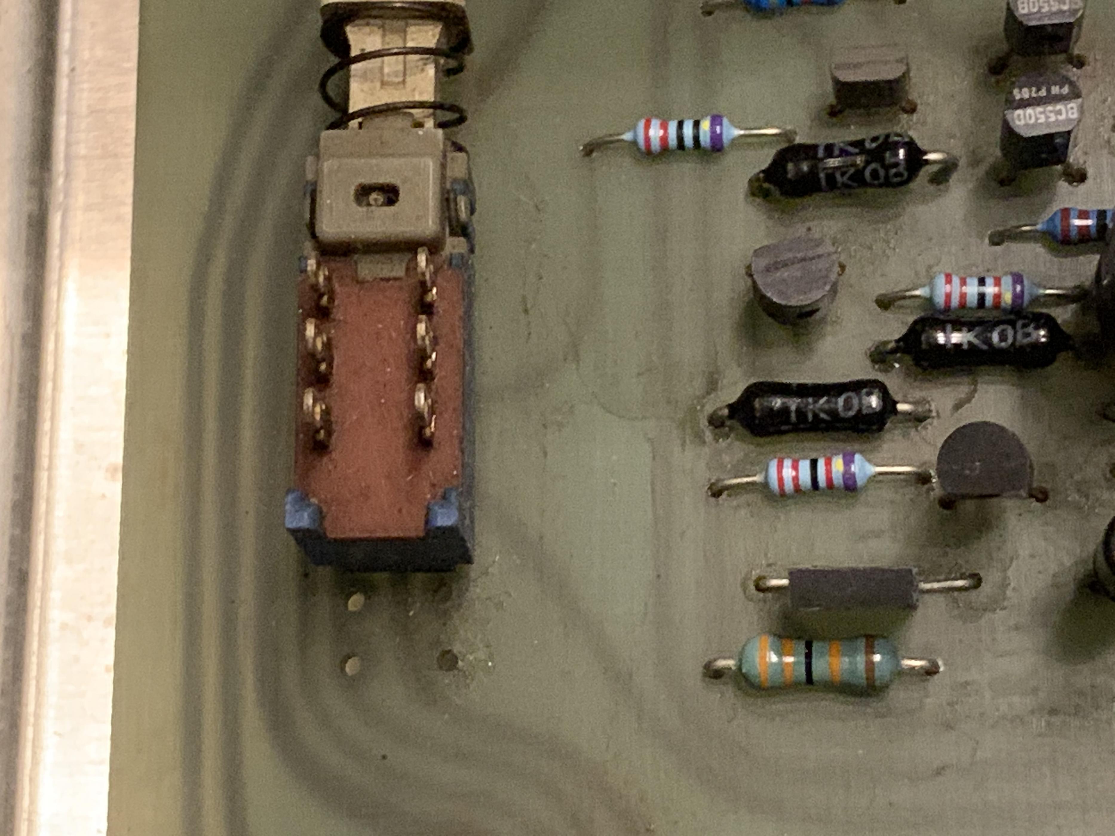

Hi Tony, on the off chance we have the same preamp layout, what do you think of this MM/MC switch - looks like a short replacement of an original to me? The switch apparently makes no difference - but I haven't got round to checking yet.
Cheers
Joe
