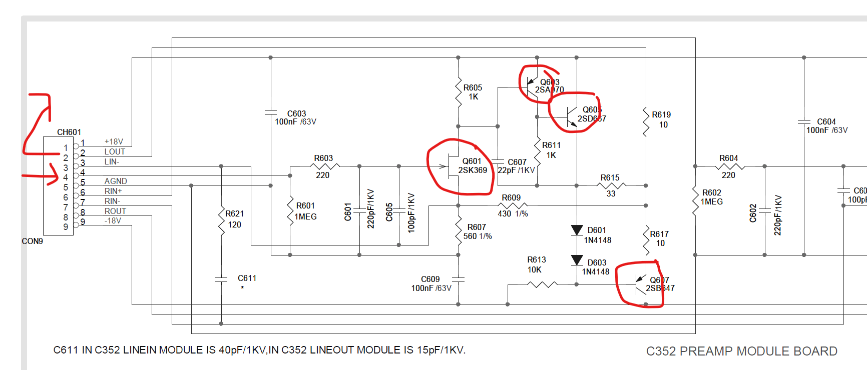

They are fully stereo independent Preamp (or discrete opamp?) module 1 & 2 module. Preamp module 2 is connected to Power amp by those links. The volume knob controls both preamp modules 1 & 2 simultaneously. So, the problem must be before those 2 preamp modules, as the L ch. noise is present on both preamps output. I tried reflowing almost all of the preamp section barring those components vertical modules . No luck, still noisy.
Next step , I will try to remove electrolytic capacitors in the preamp section and check them

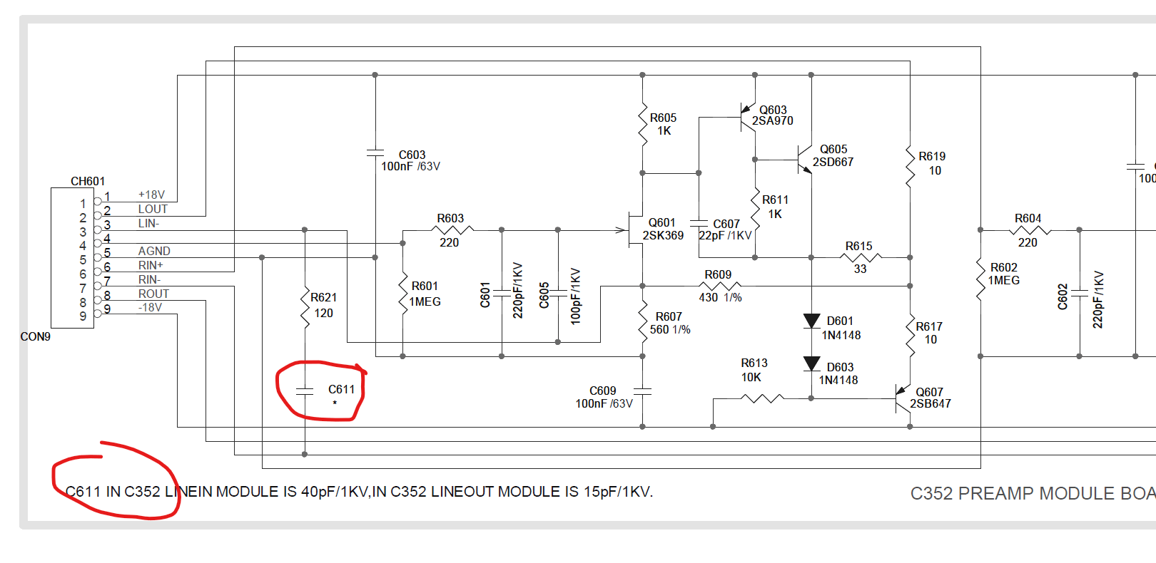

Looking at the diagram and the output of the preamp stage feeds the power amp directly. A problem in that area would nit be affected by the volume control. A scope would make this easier but without and I would be tempted to change the transistors and FET.
The volume control wiper feeds in on pin 4 for the left channel and the output is on pin 2. I can't see it being fussy on the three bjt transistors.

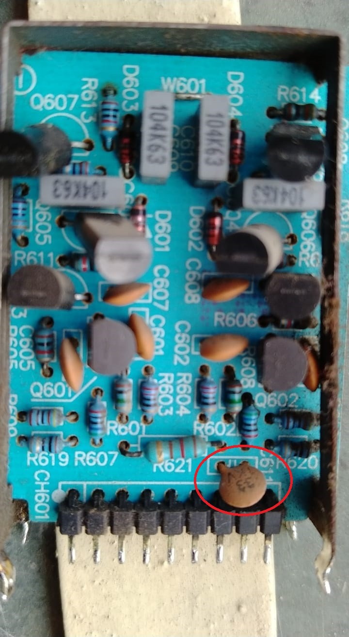

Today I swapped the preamp modules and reflowed solder on the faulty preamp module. Now the current situation is-
1 Audio coming at proper volume from L ch (previously -no sound on L ch, only crackling noise at full blast irrespective of vol. pot position but R ch was ok)
2 Crackling noise is now dependent on vol. knob position , varying from nil to full crackling blast directly promotional to changes in knob position
3 Probed various points with audio signal tracer circuit (separate mono Class AB + speaker), R ch of both the preamp module ok, L ch. of both the preamp module noisy. The preamp module connected by vol. pot. is putting out noise depending upon vol. knob position
4 Same situation as point 3, both pre out 1 & 2 RCA socket noisy depending upon vol. knob position

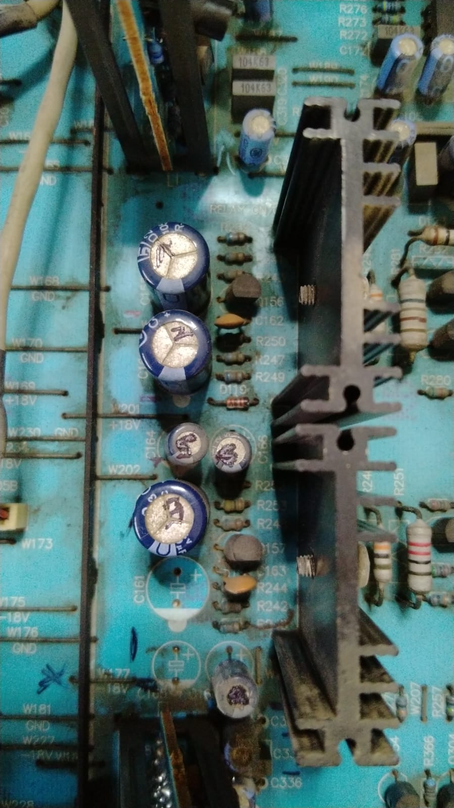

5 Removed few capacitors (220uF and 47uF) around the heatsink area, will check its ESR and do the preamp module transistors checking tomorrow (as suggested by Mooly )

In post #1 you mention the left channel faulty and the right good.
If one of the modules had a problem then swapping them around should just reverse the faulty and good channels but it sounds like more than that is going on now. If the crackling is dependent on volume position then the source of the crackle has to be before the pot.

One more thing I observed -
The modules are exactly identical and for testing. I had soldered only one good module near to the vol pot and kept the faulty module aside. Result no sound.
So I think they are in series . Previously I thought they were in parallel, one module with vol pot giving output at preout 2 RCA and the other with no vol control to preout I RCA
Todays update-

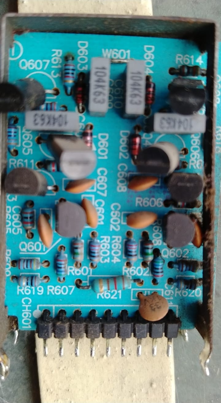

Removed faulty module again and will use short length jumper wires to connect it so it is easy to troubleshoot
Q601 is K170 instead of 2SK369 in the preamp module

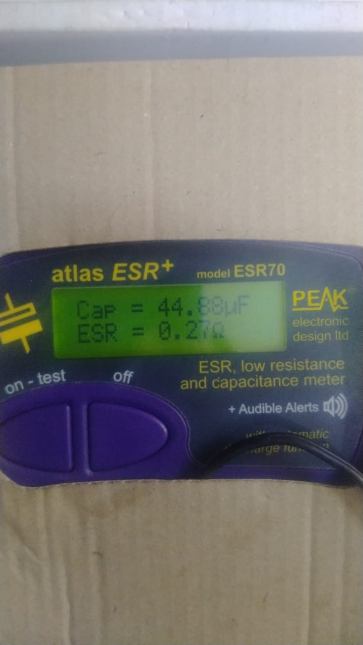

Measured Capacitance/ ESR of old 47 uF & 220 uF was surprisingly within tolerance range! All the horror stories of leaky , bloated , bulged J.H. caps had got me worried. Those 4 PC fans did their job well in keeping everything cool, if not quiet. BTW after powering ON , I checked temperatures of various components, with no input signal , things go beyond 62 degree Celsius pretty quickly(<30s). Really bad thermal design
Anyways changed it with new 4 x 47uF & 4 x 220uF , further testing of caps & recapping is kept on hold till I get the preamp section working again
