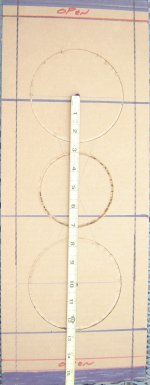

This is my friends HT, worked on the speakers way back when and now realize they are too small.
Just picked up a new/used mtm center, so can use that and re-build the 3 set (have plenty of drivers)
Thinking mtm's with old drivers and the Vifa XT25, in 20 - 23liter BR boxes.
What's needed? mtm xo design, with the Peerless 832591/Vifa XT25.
Any help with a crossover design would be gratefully appreciated.

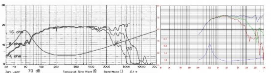

Woofer: Thlele Parameters attached:
Tweeter - http://www.parts-express.com/pdf/264-1016s.pdf

The question here is clear, simply looking for a xo design using the Peerless 5" and Vifa XT25 in a 20 - 23liters mtm box; going to copy this box idea.

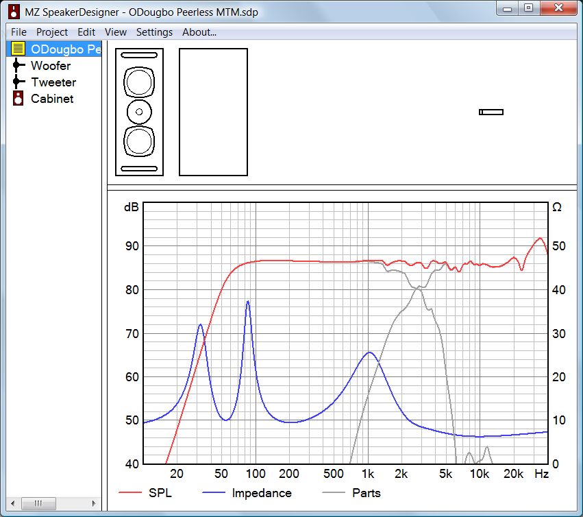

2.5kHz 3rd order acoustic for both ways, in 2way MTM config.
Well there is that dip around 2,500, didn't know if that is an issue or not.

Did some cutting today

The XT25 is really tricky in crossover design. Every time I try, all attempts to get a decent frequency response using a classic 2nd or 3rd order high-pass filter fail, great.
Fortunately 4th order works very well. Disadvantage is the additional inductor needed, but it provides the conditions for the tweeter to perform at its best.
Integrate the dip to the overall shaping. It takes on and off axis response data of of the drivers mounted on the final box, a calibrated mic, FFT, and CAD to do any real crossover job properly. Then subjective evaluation that could lead to significant changes or to just small tuning sessions.

It looks like the sim includes 3dB baffle step correction?
