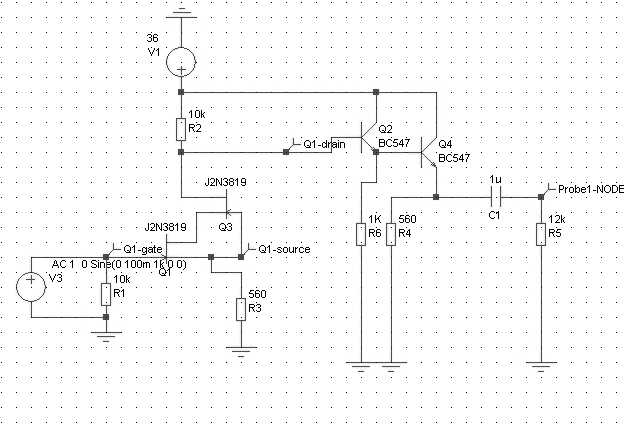

Help me with my JFET / BJT design
OK... I tried to attach an image.. but its in emf? format.
Simply put... the pre-amp was simulated with 2N3819's and BC547's.
It has a cascode 2N3819 with a 560 ohm source resistor and a 10K drain resistor.
Running from a +36v supply... that places the upper 2N3819 drain at around 18v.
This is taken from this point into 3 paralleled BC547 emitter followers with a common 270 ohm resistor.
Output is taken from this point via a 1uf cap and a 10K load resistor.
Simulating the circuit... I get 0.0001% THD with 10v peak output at 1Khz.... but at 10Khz get 3.53% THD...
Why the huge difference?
Should I be running more current in the cascode?
btw... I need a voltage gain of 10.
Thanks!!!!

Hi Richard
First of all it would help with a schmatic
The THD simulation is difficult, since it's based on samples, and a FFT (Fast fourier transform) The problem is problably the simulator and not your amp. 🙂
Also the THD needs a center freq to do the calculations. What program do you use?
My experience is that simulations are less than perfect regarding THD, but a nice tool to make sure all your DC levels are right.
\Jens
yeah, we need a schematic.
and I think most of us have come to the conclusion that distortion numbers on a simulator are about as close to worthless as you can get. there was at least one thread on this a while back.

schematic?
I am using a SIMetrix demo software.
Ahh... I think I figured it out:
split supply
oh... well since the source of the FETS are about 1v above ground.
And btw I changed the drain resistor to 12K and the source to 680. Better symmetrical clipping...
I would have to go with a split supply to build a CCS for the source of the input FETS.
I could try a CCS on the output NPN....
The j fet is a depletion mode device so it self-bias but is limited as to how much voltage swing is allowed at the input. If you bias the input at a higher voltage, this will allow a wider voltage swing at the input before clipping.

THD figures
Run a transient analysis... display the curve and select it. Its under the 'Measure' menu on that window.... select transient and select distortion full.
something like that anyway...
you can also do a FFT on it and see how the THD spectra looks like.
Simulated this circuit has a nice distortion progression.... dominated by 2nd until close to clipping then 3rd creeps in.
