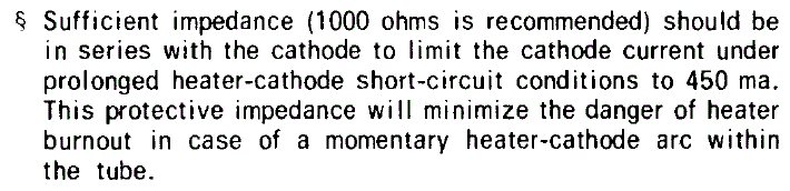

* series impedance should be used with cathode to limit cathode current under prolonged short-circuit conditions to under 450ma.
Confusing, when the maximum is 1.6ma!

Heater current is 200 mA - must be limited to less than 450 mA (this suggests that heater voltage possibly could be increased to increase emission (increase current, decrease saturation voltage) but it's obviously operating outside specified parameters. The 27KV rating is while conducting; 60KV is "off". Dissipation (V x A) rating is average, at least to some maximum pulse length (might be fractional to whole seconds).

Same with plate current, maximum averaged over time. Peak instantaneous current in impulse is usually specified for a given impulse duration or duty cycle. 450 mA here is the maximum allowed instantaneous current. 1.6 mA average current should not be exceeded, even though plate dissipation limit would allow it. Higher than specified maximum plate current will cause cathode stripping and dramatic reduction of tube's life.
The 450mA relates to the attached condition in the 6EL4A datasheet. The 450mA is from an internal arc with a relatively benign voltage across the arc (as the heater shouldn't be more than 450V negative to the cathode) and not due to an anode related current of 450mA (which has the 1.5mA average limit). As a sanity check note that if the 6.3Vac heater was at -450V, and it shorted to the cathode, the 1k cathode resistance would limit the heater arc current to 450V/1k = 450mA. Such a fault current should be at least fused such that any fault is 'momentary', as described in the notes.
Note that the application is for a shunt regulator, where the anode current will be constant, with a 1.5mA max limit capability. There is no duty cycle allowance for > 1.5mA, or is there a surge or momentary rating, so you go into unchartered territory if you somehow have a surge, or transient or pulse or fault in your load.
Although there is only one pre-condition for power turn on, I would suggest you use a heater pre-start or at least identify and assess some commercial equipment as to whether they use a heater pre-start.
