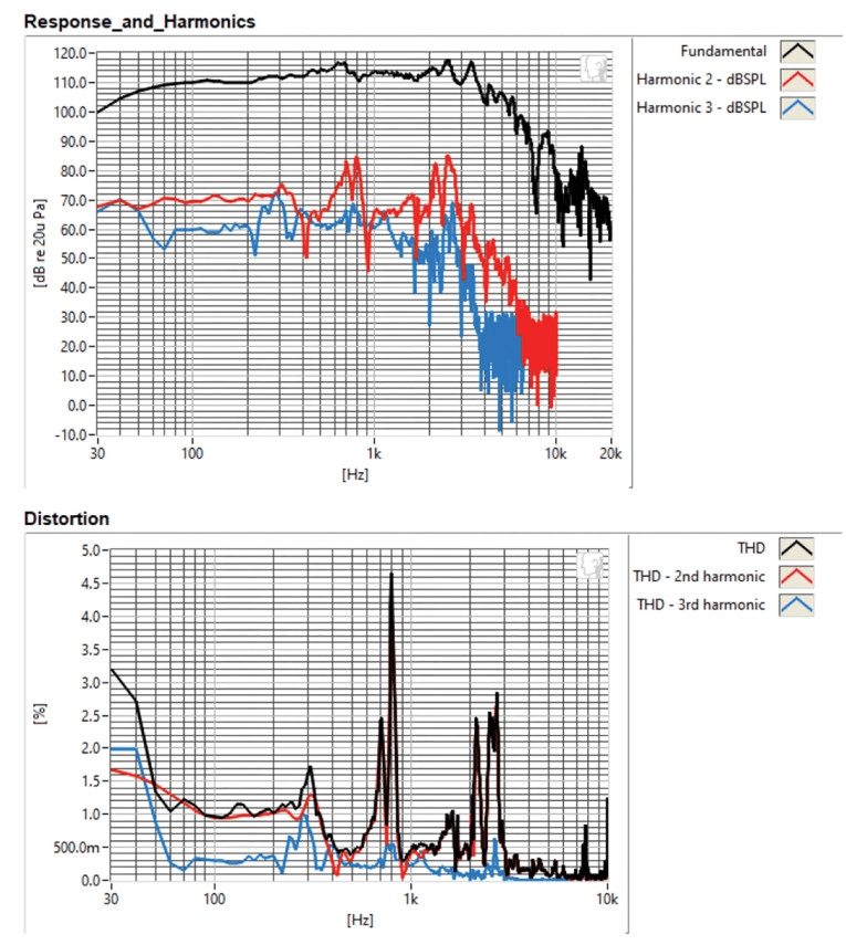

10NMFS.pdf
I would not suggest that one. It is designed as a subwoofer, so it would typically be crossed lower than you intend.
There is a large peak in distortion near your cross point.
https://audioxpress.com/article/voi...ofer-from-beyma-s-near-and-mid-field-nmf-line
"I mounted the 10” driver rigidly in free air and set the SPL to 94dB (the criteria for home/studio monitor drivers) at 1m (9.7V), using SoundCheck’s built-in pink noise generator and SLM. I then measured the distortion with the Listen microphone placed 10cm from the driver. This produced the distortion curves shown in Figure 11."
Reactions: argou
“Go figure” ….
Thank you for your reply !!!
The reason I post this alternative was that at the same article you are referring to ,the author is commenting the below :
“Given the SPL anomaly centered on 8kHz, this driver could easily be crossover to a midrange driver between 200Hz to 700Hz so it could easily be used in a three-way application as well as a subwoofer.”
I saw that as well but was left wondering if that was a typo and he meant 800 Hz (instead of 8 kHz) after looking at the plots. There is also a little "wrinkle" in the impedance around 800 Hz. It's another symptom that a problem could be there.
Another point is that many will use notch filters at breakup points like that to make the speaker more usable near breakup. Since you don't have measurement/modeling capabilities, this is not really feasible. Yes, you could just use a textbook filter to try to deal with this problem, but a lot of assumptions would have to be made and there's always the chance something goes wrong. It seems safer to me to use a driver with inherently good performance for your desired range. It decreases your pool of usable drivers, but increases your chances of success.
