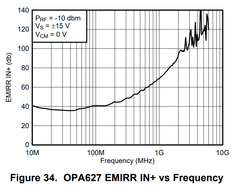

For ADA4627-1, didn't offhand see anything about EMI/RFI immunity in the datasheet.
OTOH, OPA627 has info on EMIRR IN+ including a table, and this graph:

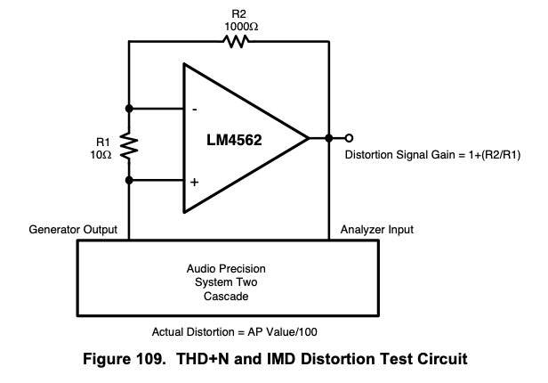

Another approach is to use the test circuit shown in Fig. 109 of the TI LM4562 data sheet:
The key is to reduce the loop gain of the opamp so the distortion becomes measurable. Then compensate for the change in loop gain by changing the reference on the distortion plot. This does assume that the distortion doesn't change in nature/composition as the loop gain is reduced.
