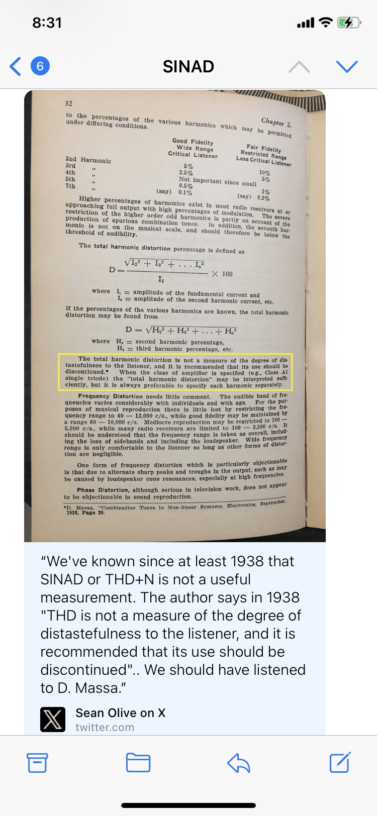

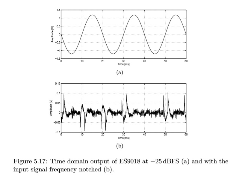

This was also part of the text: "..."the "total harmonic distortion" may be interpreted sufficiently, but it is always preferable to specify each harmonic separately."
I believe that it needs to be included as it puts the "total harmonic content is not a measure of the degree of distastefulness to the listener,......" into context.
The harmonic content is more important than the "total" harmonic distortion.
