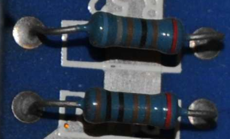

Hi people, can you help me identifying these resistors. All I know is they are Roederstein MK3's.

I do not know if the colors are right but the top resistor band colors read as follow:
blue yellow brown black brown red value = 641X1 tolerance 1 % temp=50ppm
bottom
brown black black brown brown red value = 100X10 tolerance 1% temp=50ppm
Please double check the colors.
