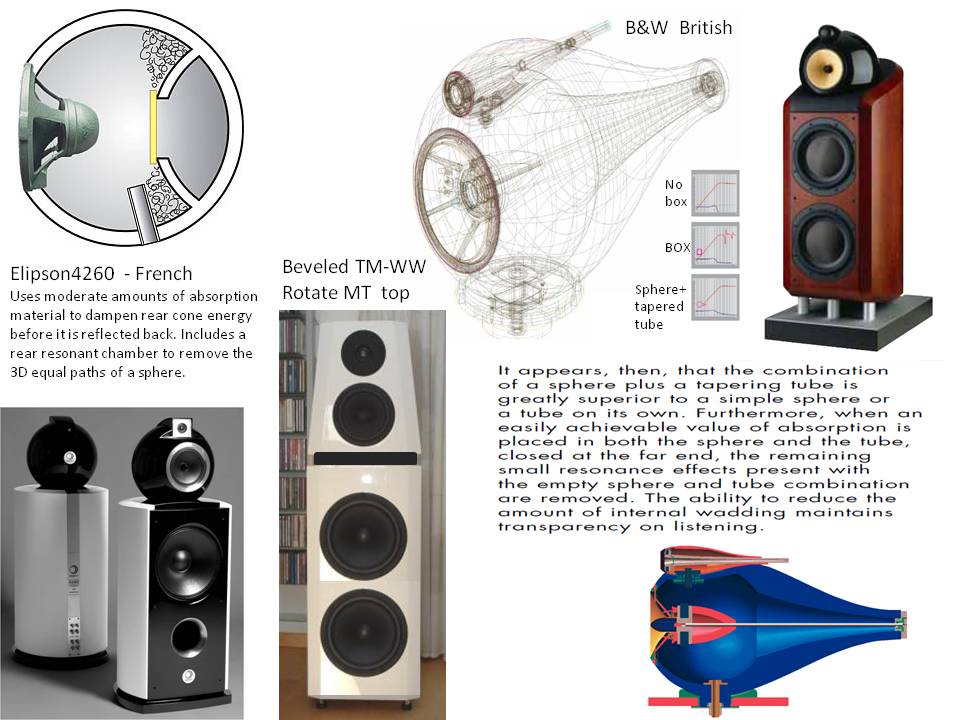

Smart Sphere enclosures:
French.... includes modest amount of absorption material at the rear of the sphere, plus a resonant rear chamber that removes the 3D equal path lengths in a sphere.
British.... Sphere + stuffed rear tapered tube to spread out resonances and absorb rear cone eneregy.
A rotatable MT with tapered/beveled edges also has good diffraction response. Just add a W or WW bass bottom for a proven design with many DIY Xovers on the web, including SBacoustics. It can be painted to match your cabinet colors. Camouflage?
If you cannot accept a high efficiency design using a horn tweeter with controlled dispersion that fits your room dimensions, then put some of your artistic talents into a MT-W(10") or MT-WW(8") with a rotatable MT top. Your MiniDSP will provide time alignment such that you can use a flat baffle. Just bevel the edges.
