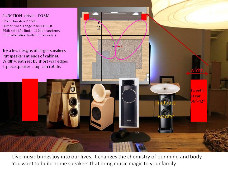

Consider a few sketches of larger speakers at the ends of your cabinet.
How many inches(cm) from the right cabinet edge to the right edge of the small wall bump-out? The right speaker will not go against the rear wall, but rather the back of the right speaker will go against the short wall bump-out. This will set the speaker width and depth. You will need to be able to toe-in the speakers, or at least toe-in the mid-tweet frequency unit(s). Design for 3-on-a-couch without comb issues.

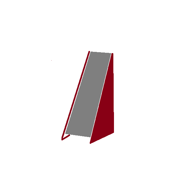

make the woofer active, and you may not need any other 'sub'
how would a complete triangle look ?
or just with more narrow top and wider bottom closer to the floor
That will result in a problem where to place the mid-woofer. The tweeter can be small, but the mid-woofer needs to be at least a 4" and placed close to the tweeter, that needs to be placed close to the top.make the woofer active, and you may not need any other 'sub'
not if you make the bottom wider
there have been a few designs like that in the past
I believe one was made by Electrocompaniet 😉
anyway
big distance between woofer and mid might demand a bigger midwoofer instead of a small mid
xo point may need to be lowered like if being a 2way with sub
or else place woofer higher
imo ... I would probably prefer straight up sides, no angles
but I'm old and boring
what do I know about youth 😀

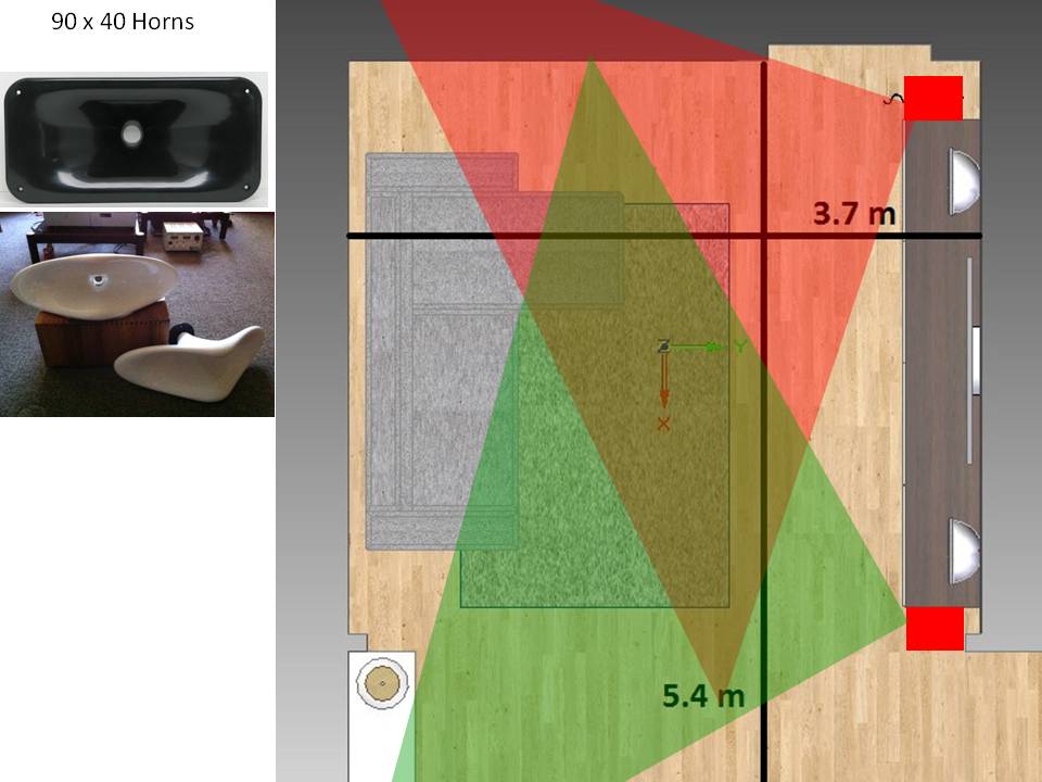

Very attractive 3-way pyramid cone speaker sketch! Side cabinet placement allows speakers large enough to make music magic. SBAcoustics drivers would be a great price/performance choice, with several diy Xovers on the web to study.

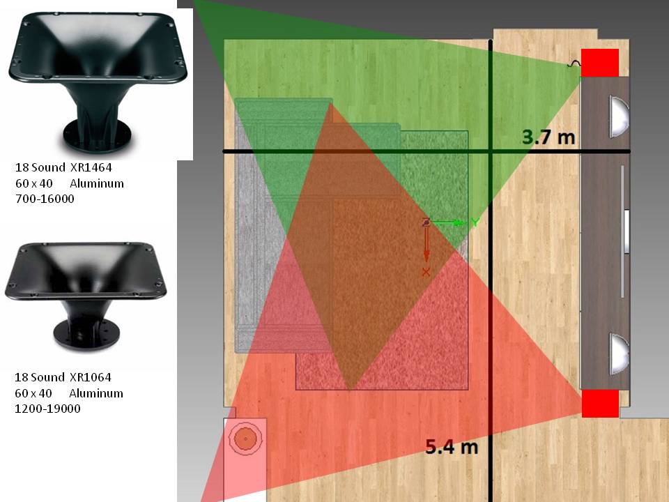

The normal recommendation for proper soundstage development is to toe-in cone+dome speakers until their center lines cross just in front of the listening position. An equalateral triangle (L-R-listener) is often recommended as a blank sheet room goal. You could add toe-in on your sketch to get the full interior desigh effect. A two piece, W + MT design would allow toe-in of just the MT top if the W Xover is ~100Hz.
High frequency horns with 90x40 or 60x40 polar response will remove significant room reflections when compared to the 180x180 polar response of MT cone+dome. Take a look at the 60x40 horn coverage picture for your room dimensions.

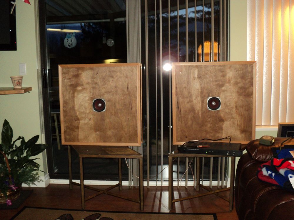

My project one-square meter(each) OB units didn't phase her........
When I was considering my new speakers the first thing that came to mind was a Trio from Hawthorne Audio. So I was reading up on it and my wife take one look at the size (besides they would need at least a meter behind them for breathing room) and freaked. I shelved that idea because the idea of sleeping on the couch did not appeal to me. 😉

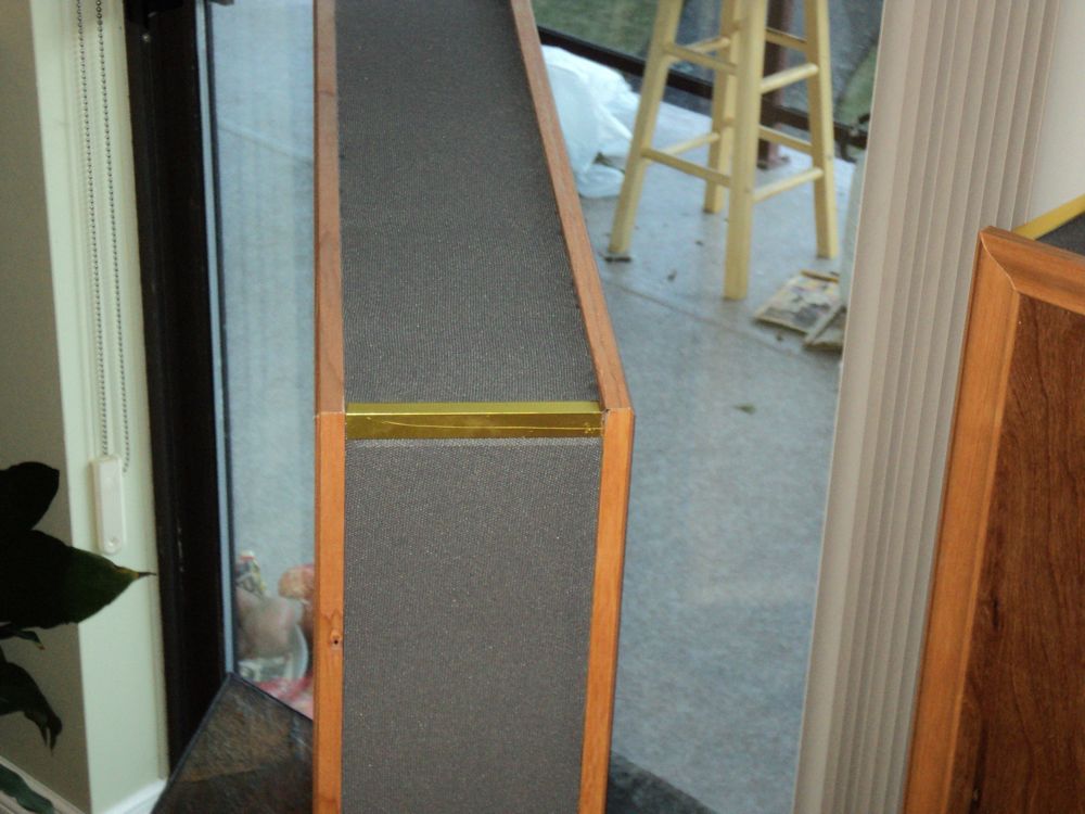

Anton, methinks you're trying too hard. I still think for WAF, the Cornu works best. Especially if you cover the driver with a silkscreen on it's own frame to hide the driver. Make it about 1/2 to 2/3 coverage of the box.
Here is a shot of the edge so you can see they look fine from that perspective as well. The 'scratch' on the trim is actually a string of hot glue. On the right of the first pic you can see how I added the moulding so it looks like it's own frame and filter cloth to hide the horn mouths so it tends to meet many of the WAF requirements. One either side of the TV on the wall, and the woofer wherever there's room.
In the second pic they are just there to listen to. Not only can you see the camera flash but you can see the reflection of the jellyfish lamp above the right speaker. 🙂
On top of that, they took only 20 hours as you see them so if they don't work out you can decide on something else. Besides, with the foam core, they are the funnest build I can remember.
