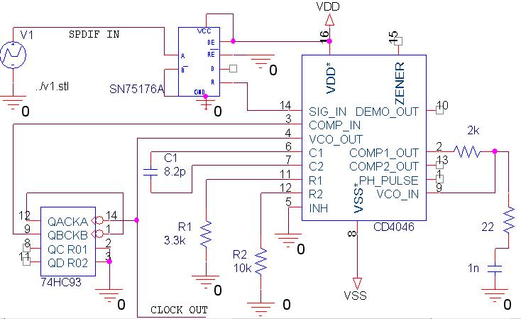

Help me design a SPDIF reclocker, preferably based on 74hc4046
Hi
I want to design a reclocker that is based on typical TTL IC's and a very basic one. I do not nessesary need low jitter, rather a real PLL reclocking based on data bits, not preamble (like in cs8414 or so..)
I am not sure what is the way to amplify SPDIF signal to TTL level as well as wheather I need a frequency divider in PLL.
Please help!

That's how I'd imagine this reclocker to be.
C1 probably will need adjustment.
Please comment.

darkfenriz said:
By AES? Not whole, why do you ask?
If something's wrong, than well, If you could help, this ehhmm... would be some kind of ? helpful...
There are minor design errors and there are Tacoma Narrows sized errors. Your error is so fundamental, the only thing I can say is read and understand the specification
darkfenriz said:
Read the specification, datasheets of receivers and Hawksford's publication.
No clue...
The datastream has the clock embedded in it, is biphase mark encoded and uses code violations to define the channel boundaries.
Which particular edge do you plan to lock to and what do you intend to use as a reference ?

It won't make the slightest difference, it still won't work. From the diagram in post #5, the OP is trying to work with the raw SPDIF datastream.

That's right, silly me,
I knew it is BMC coding, but didn't suspect it is impossible to directly reclock with a PLL, my experience with clock recovery circuits is very poor.
Thank you for pointing this.
Any idea how to make it work with general purpose devices?

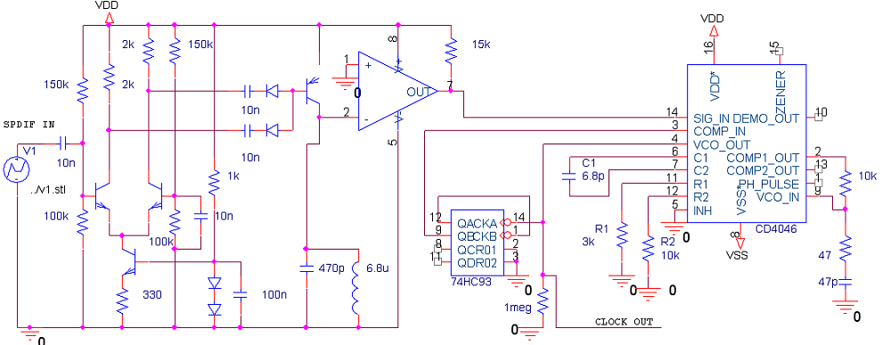

OK
I've changed the schematic, so that it should work now.
I've included a "rectify and filter" front end, which I designed with friend for E1 stream (HDB-3 encoded) about a year ago.
What do you think of it?
