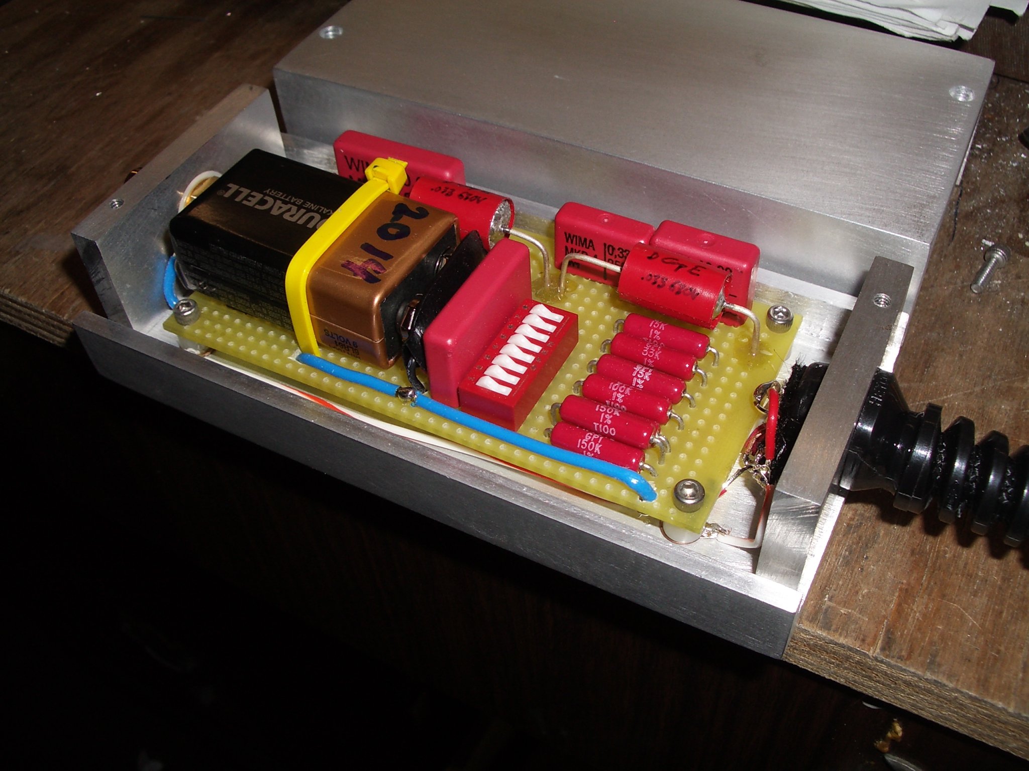

Built my (SE) versions back in 2010 for my Quads and Vandy sub combo. No balanced versions alas..
It’s been 13 years since I made this and going on memory the battery was used to put a voltage on the shield like the Audioquest series of battery biased cables and was a real pain to implement
I believe JBL had something valid on keeping caps biased I recall ? but don’t hold me to it..
I did have one battery drain one time and could not tell it’s effect on the sound stage so building a set without the bias
would make it easier
I went off pics of an existing one for reference and hand drawn schematics. I will have to look around for it

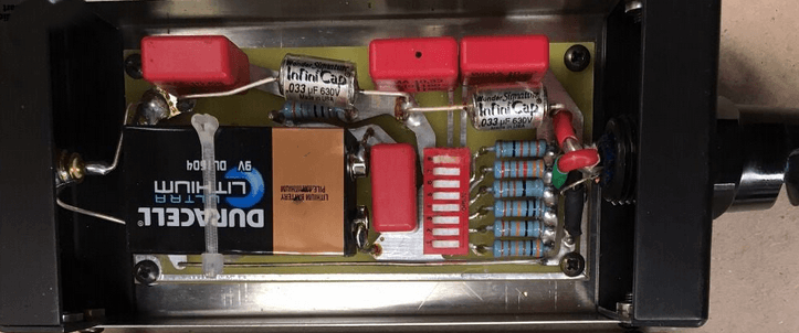

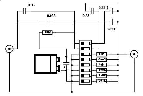

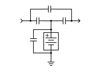

Based on the images, I come out with this schematic:

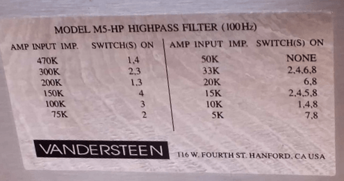

For 50kΩ amplifier input impedance (NONE dip switch on), capacitance = 0.0302µF,
for 10kΩ to 33kΩ input impedance (dip switch #8 on) capacitance = 0.149µF,
for 5kΩ input impedance (7,8 dip switch on), capacitance = 0.224µF.
Can someone verify that the above schematic, components values and calculations are correct? Thanks.

My speakers are designed to be used with a 100 Hz first order high-pass filter. A pair of these RCA filters were included with the speakers: https://www.vandersteen.com/products/m5-hp
I want to design and build my own version of this filter, adding the ability to accept balanced and single-ended inputs/outputs, and maintaining the ability to adjust to match different amplifier input impedances.
The spec from the manual is a signal measuring 1v at the filter output at 1000 Hz should measure 0.707v at 100 Hz. The filter should be adjustable so that this attenuation can be achieved with a variety of amplifier input impedance values.
I know the basics of designing an RC filter, but I need help picking the resistance and capacitance values, and designing switchable loading.

@SoaDMTGguy
Please check and post the component values in your M5-HP, especially the capacitor across the battery terminals.
For the balanced version, just duplicate the capacitors, a 10MΩ resistor and 2 extra dip switches on the inverting phase and install a toggle switch to move the shunt resistor ground connection to it, this will allow the user to select a balanced or single ended connection.

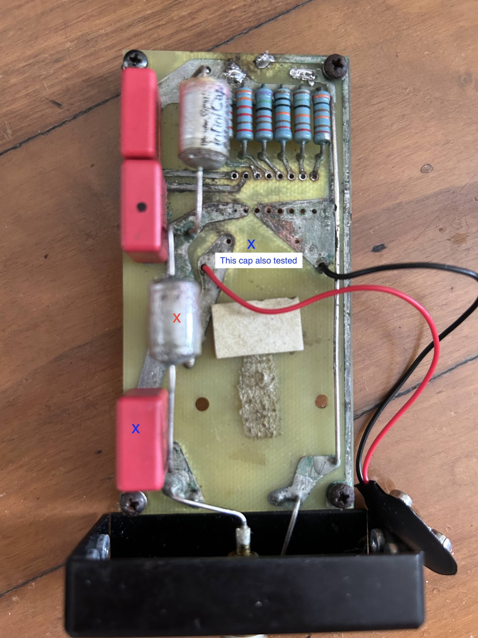

I have a spoilt M5-HP high pass filter damaged by battery leak. Please see attached photo. What should I do to repair the damage? Replace all the capacitors?
Thank you in advance.

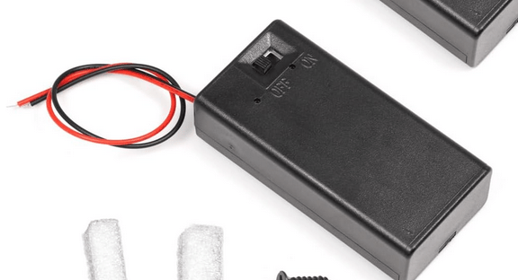

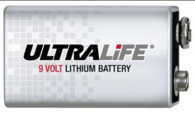

It looks like those .033 Infinicap need to be replaced and the PCB needs to be thoroughly cleaned to avoid short circuits. If space permits, use a battery tray and leak-proof long-life lithium 9-volt batteries to prevent the same problem.

I have checked most of the capacitors and they are surprisingly still in spec. I am now replacing the switches. Hopefully this will solve the problem.
The area under the switches seems to be the worst affected by leak.

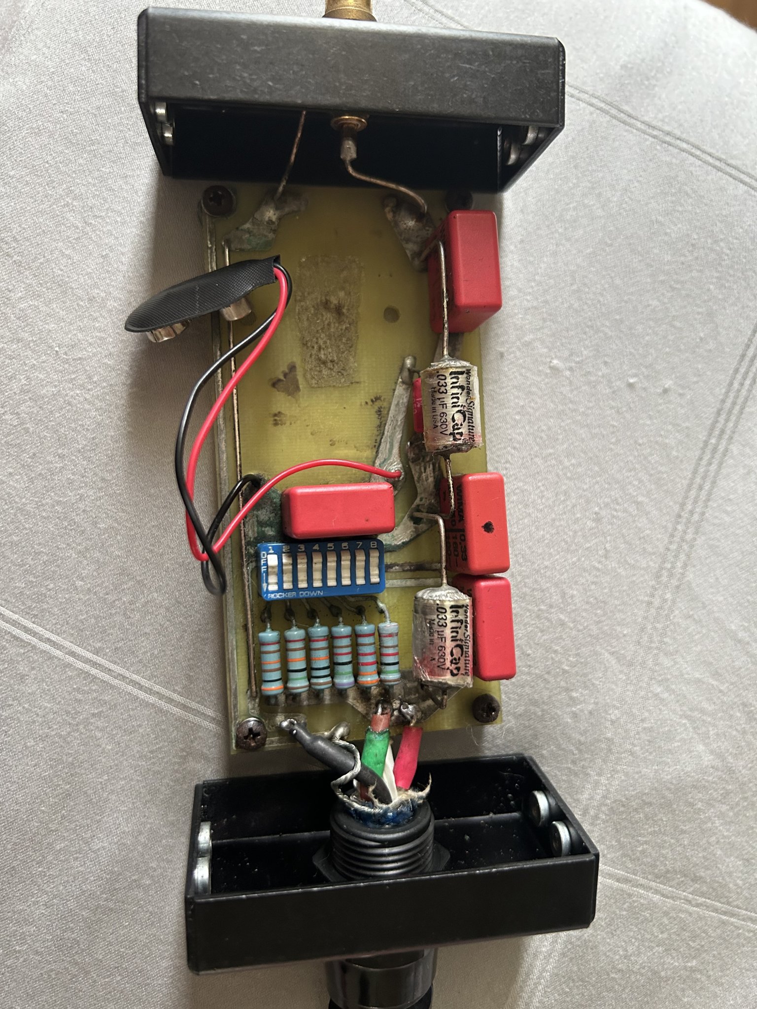

Can I also ask: there are 3 cables from the RCA jack: red - connected to the positive (point of RCA) and green and black that is connected to the ring of RCA. Black is connected to the negative line. Do I connect the green cable to the ground?
