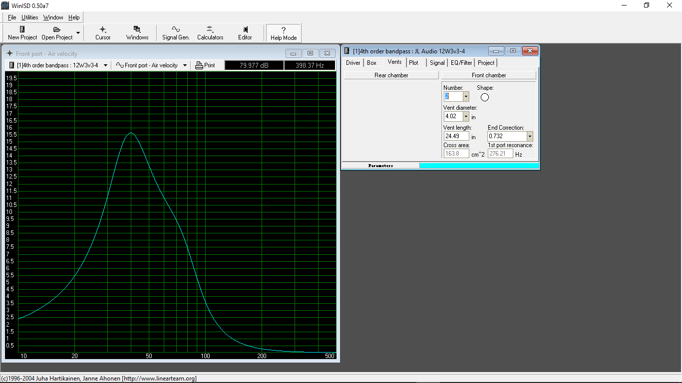

Airspeed 11 m/s at 20 hz.
Looks like a design used for an automobile. I wouldn't use that design for your project. I haven't used WinISD, but I believe that the transfer function magnitude tool would be used to design enclosures for cars.

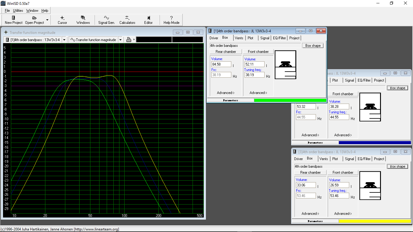

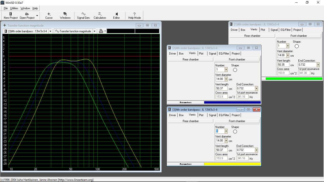

Hi JPcolin,
Here are some examples that could work for your project. The two examples with the higher Fh or F3 would work better with the satellite speakers your planning on using. In Winisd, once you have created a new project you can play around with the front and rear box volume, and the front tuning frequency to get the response you want.

Hi Matt,
Thanks, i haveno idea if this is good or not for my particular aplication, frequencies look good tough. I had a look at the air velocity in the port and ik is really low, (pompared to the 11m/s of Morca..) is this good or bad?

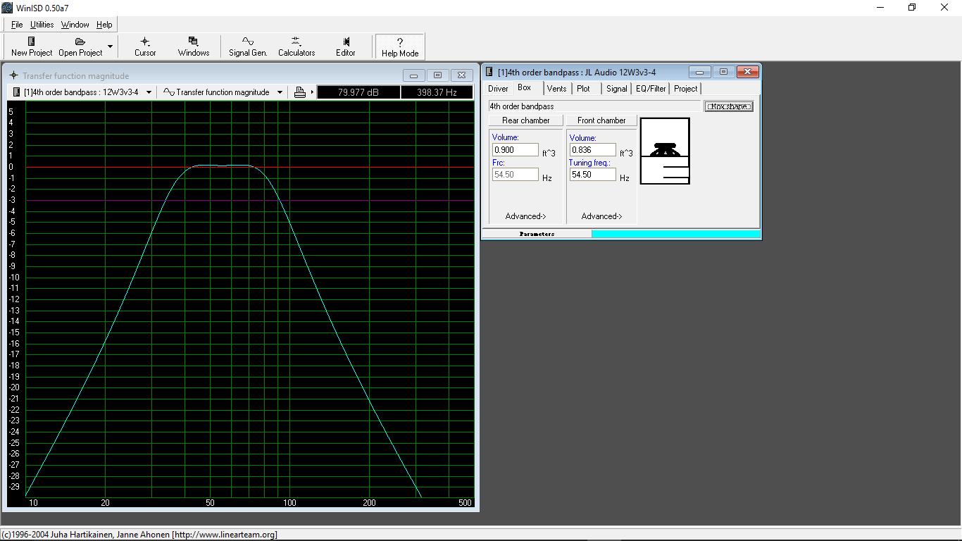

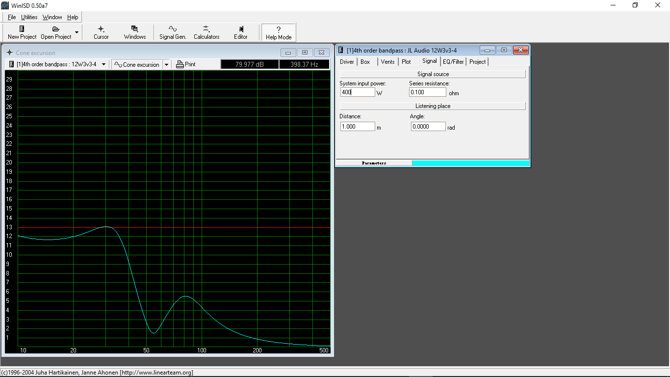

It's been a while, buti have some update, i was able to find a 12w3v3-4 for 40€ (new), so i bought it. Could you share some designs with the 12"? Your designs for the 13" looked good!
Hi Jpcolin,
Sorry for the delayed response, I didn't have access to the laptop until now. This design should work well with the 12W3v3-4. Notice that I used two 4 inch ports, 4 inch pvc is probably easier to find than 6 inch. If you have any questions please let me know.
Regard,
Matt
