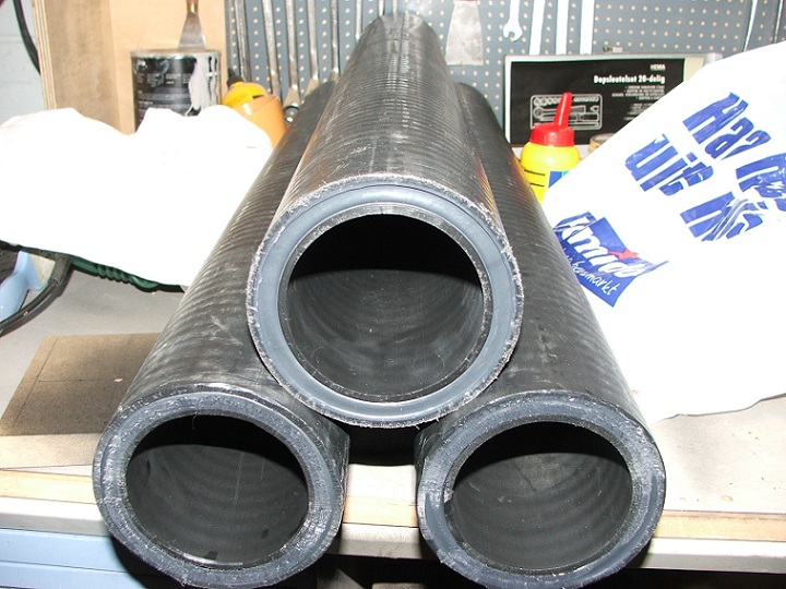

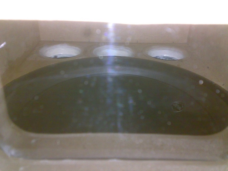

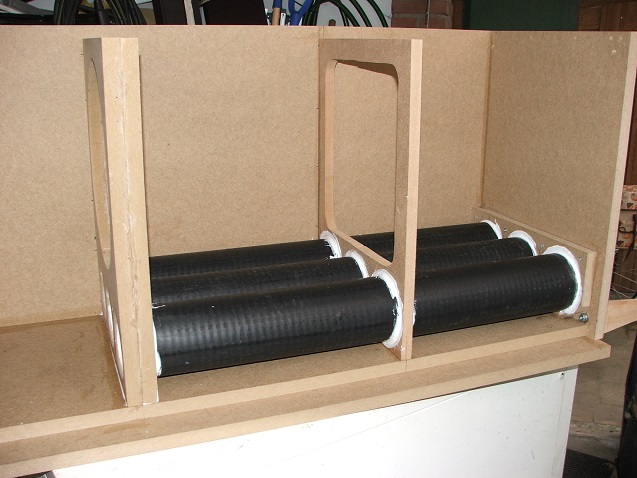

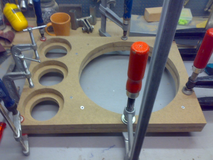

I have build one
Hi Morca, could you share your experience? Which JL sub? Which amp?
JL audio 13 W3V3-4
Hypex DS4 plateamp 400 watt rms at 20 hz.
Box 120 liter closed/39 liter vented.
3 vents of 82 cm long 8 cm diameter
VB1 16hz VB2 70 hz.
Airspeed 11 m/s at 20 hz.

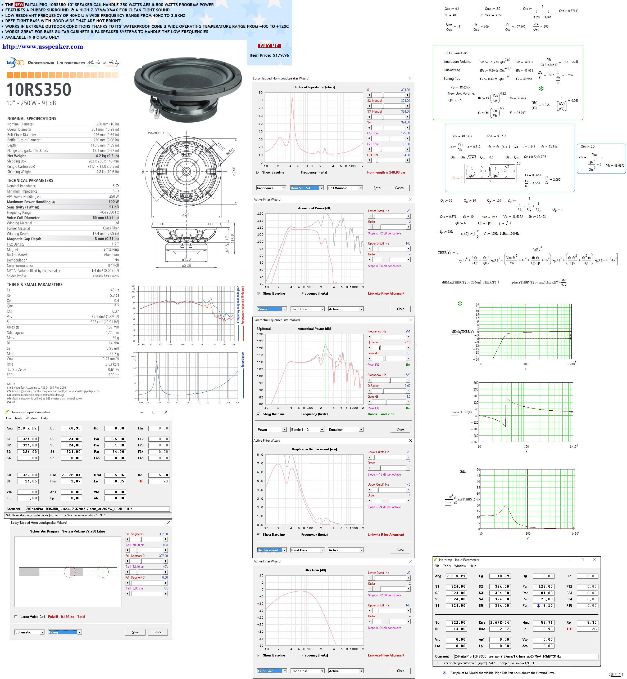

Thanks for the reply,
Ik tried to put the dayton and a JL Audio w3v3 12 in Winisd, but it seems there barely a difference, is this normal?
Also port diameter does not affect the graph...
Hi Jpcolin,
The parameters for the Daytons and the JL are very similar, so the sims will probably look pretty close. The JL subwoofer is a very good choice, but cost much more than the Daytons.
The port area will come into play when the power is increased. All of the output from the subwoofer is coming from the port, so you will need the port area as big as possible. I would use at least a 6 inch diameter port or bigger.
