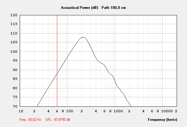

The upper part of the response changes, yes, but not the low end extension.
Am i missing something? Any other better way to model H-Frame?
Just a guess here because I am not a user of Horn Response, but is the program just sticking in a straight line below where it is displacement limited? Can you reduce the power input (substantially, because who is going to be using the system at 120db???) since this might push the displacement limited region down in frequency.

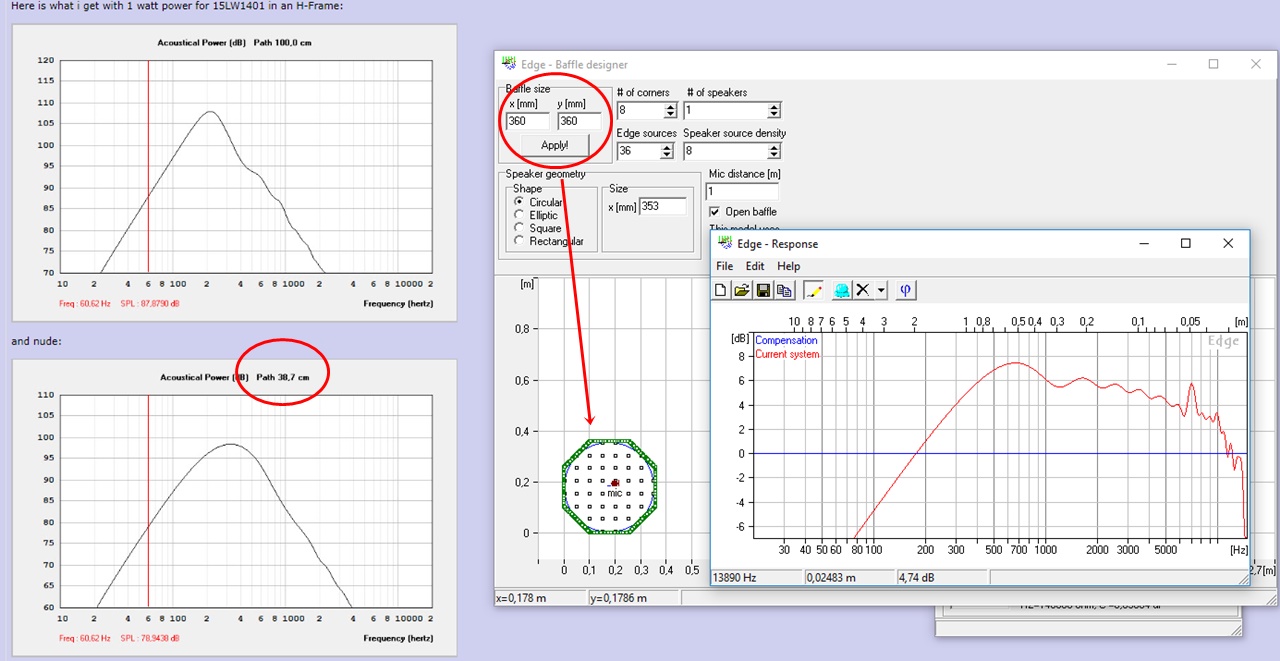

BTW, i made a mistake in a previous example of how H-Frame is modeled compared to a nude driver. When calculating combined power response, Hornresp requires the distance between two radiating sources to be provided. So, in an H-Frame model the distance was correct, but in a nude driver it was still the same as for the H-Frame which makes it an incorrect model.
Here is what i get with 1 watt power for 15LW1401 in an H-Frame:
attachment.php

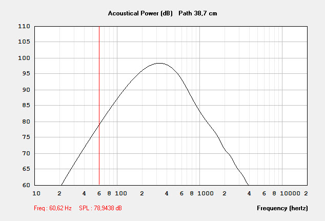

and nude:
attachment.php

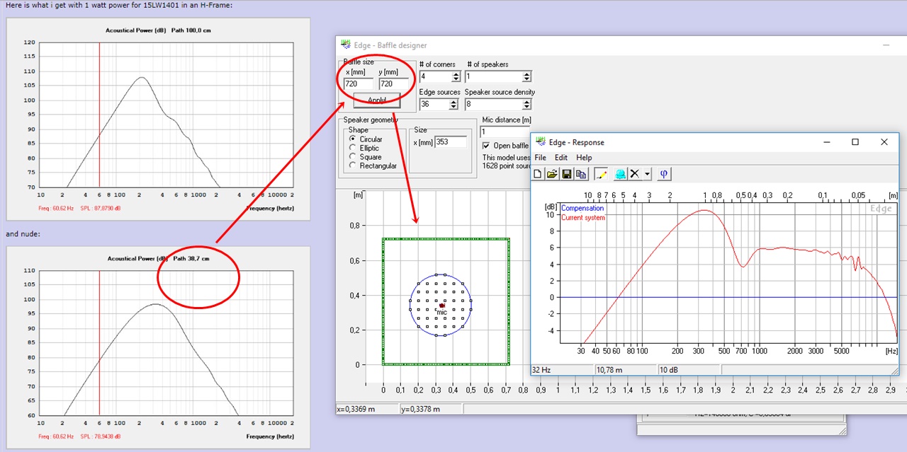

Your "nude" has path length of 38,7cm. That means from the center of the driver to nearest edge - radius - and diameter of 30"! Obviously you counted path length twice?
Perhaps the same mistake for the H-frame? In HR there is an option to show the baffle, check that!
I am more familiar with The Edge, but it uses only flat response for drivers.

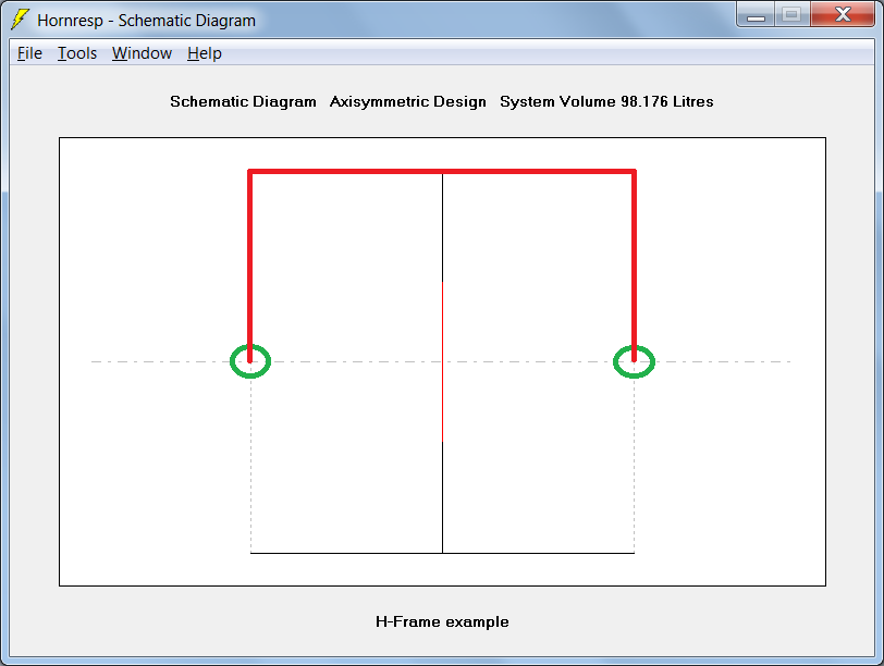

In my correspondence with David, he provided this illustration on how to calculate the offset:
764654d1561356710-hornresp-attach_1-png
From the dialogue one may conclude, that the distance is taken from center to center of the speaker. In the case of H-Frame (or compounded horn as it is presented in the Hornresp), the distance is measured from the mouth of that horn.
According to this method, provided i get it right, one should calculate the distance between center of the front of the driver and center of the rear of the driver, which happens to be the diameter of the woofer - about 387mm.

Then you must divide the distance by 2 (look at Kreskowsky link I gave in post #22)
A nude and baffled 15" driver simmed with the Edge here. Perhaps you should measure a nude driver quickly to verify this. I believe in Edge!
Not if the actual locations of the "acoustic centres" are taken into account when determining the acoustic path length - see link below:
Frontiers
Key comment: "The baffle structure has a physical length L = d1 + d2 and width and height W. The acoustic length is larger by about W/2 on each end, similar to the end correction of the vent of a Helmholtz resonator."
