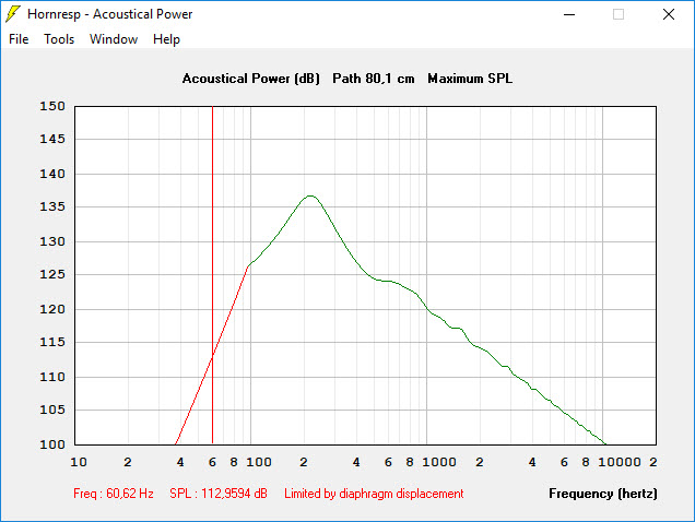

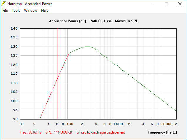

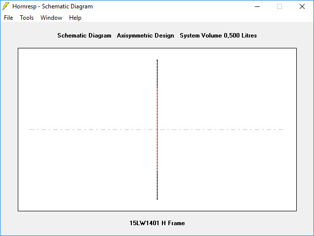

As i mentioned before, I have chosen a woofer driver for my dipole build - 18Sound 15LW1401 4Ohm, which shows promising 106dB at 60Hz in Hornresp simulation with its being a limiting factor 9mm x-max in an H-Frame.
Now, Hornresp does provide data with max SPL and the overall FR image and according to some correspondence between David McBean and some other guy from the forum Hornresp's h-frame models (modeled as compounded horns) are a lot like those provided by MJK MathCad models.
The only thing that i don't see in the Hornresp model is the resonance. Just out of my head i used and H frame with 25cm wings which give 50cm total depth. To make it look symmetric, H and D are also 50cm. Will this thing play up to about 180-200Hz? Aside from MJKs spreadsheets, what is the way to find out?
Hmmm...
Seems like i am misunderstanding something about modeling h-frame in Hornresp. Two models in 2xPi:
H-Frame with 25cm wings from each side:
attachment.php
Its calculated combined power response with MaxSPL function:
attachment.php
Nude driver (compounded horn with 0,1cm wings):
attachment.php
attachment.php
The upper part of the response changes, yes, but not the low end extension.
Am i missing something? Any other better way to model H-Frame?
