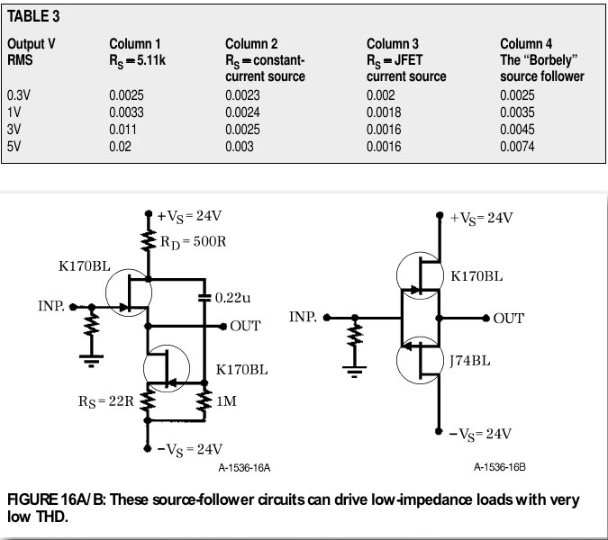

Curl has been telling us for years that jFETs can be biased to 90% of Idss rather than the more usual range of 25% to 75% of Idss.
Curl also reminds us regularly that when Vgs goes slightly +ve, Id exceeds Idss, But, he does warn of excessive gate voltage and it's effect on the gate leakage current.
The Pass B1 and the Salas version referred to as DCB1 are both excellent source followers using jFETs biased at Idss.
I would like to add this snapshot from Erno Borbelys "Jfets: The New Frontiers, Part 2": Have a look at figure 16B and it´s results in column 4.

my sims at 20kHz,1V and 5V of the above Buffers resulted in following figures (sims at 1kHz resulted in hardly any better values).
for circuit 16A, idling at an Id of 8.9mA:
THD1V: 0.000024% -132.39dB
K2: 0.000024% -132.9dB
K3: 0.00000141% -157dB
K4: 0.000001024% -160dB
THD5V: 0.000121% -118.3dB
Z(out): 25.6Ohms
for circuit 16B idling at an Id of 14.6mA:
THD: 0.000037% -128.6dB
K2: 0.0000372% -130.5dB
K3: 0.0000014% -157dB
K4: 0.000001057% -160dB
THD5V: 0.000186% -114.6dB
Z(out): 10.3Ohms
K2 dominates, all higher components vanish below the noisefloor.
Even lower figures are reached with a ccs-loaded cascoded JFET.
Like fig. 16A, but omitting with Rd,1M and the 0µ22 cap, replacing the JFETs with a cascode of BF862 (high-gm) and SST4391 (high Vgs) and adding Source resistors of 4.7Ohms to upper and lower leg.
THD: 0.000003% -150.45dB
K2: 0.000002328% -152.7dB
K3: 0.00000122% -158.4dB
K4: 0.00000107% -160dB
THD5V: 0.000009% -140.9dB
Z(out): 33.6Ohms
Here all values remain below the noisefloor, even at 5V output voltage. Noisefloor is at -136dB and slightly higher as with circuits 16A/B. Bandwidth limit is higher. Heat losses in the transistors remain lowest of all 3 circuits. The transfer function is closest to 1.
The introduction of a second source resistor to the upper leg shifts the DC-offset to 0V if the parts are carefully matched, allowing to omit with large DC-coupling caps at the output.
A slight drawback might be that the load impedance to all 3 circuits should be well in the kohms-range if to avoid output voltage drop.
