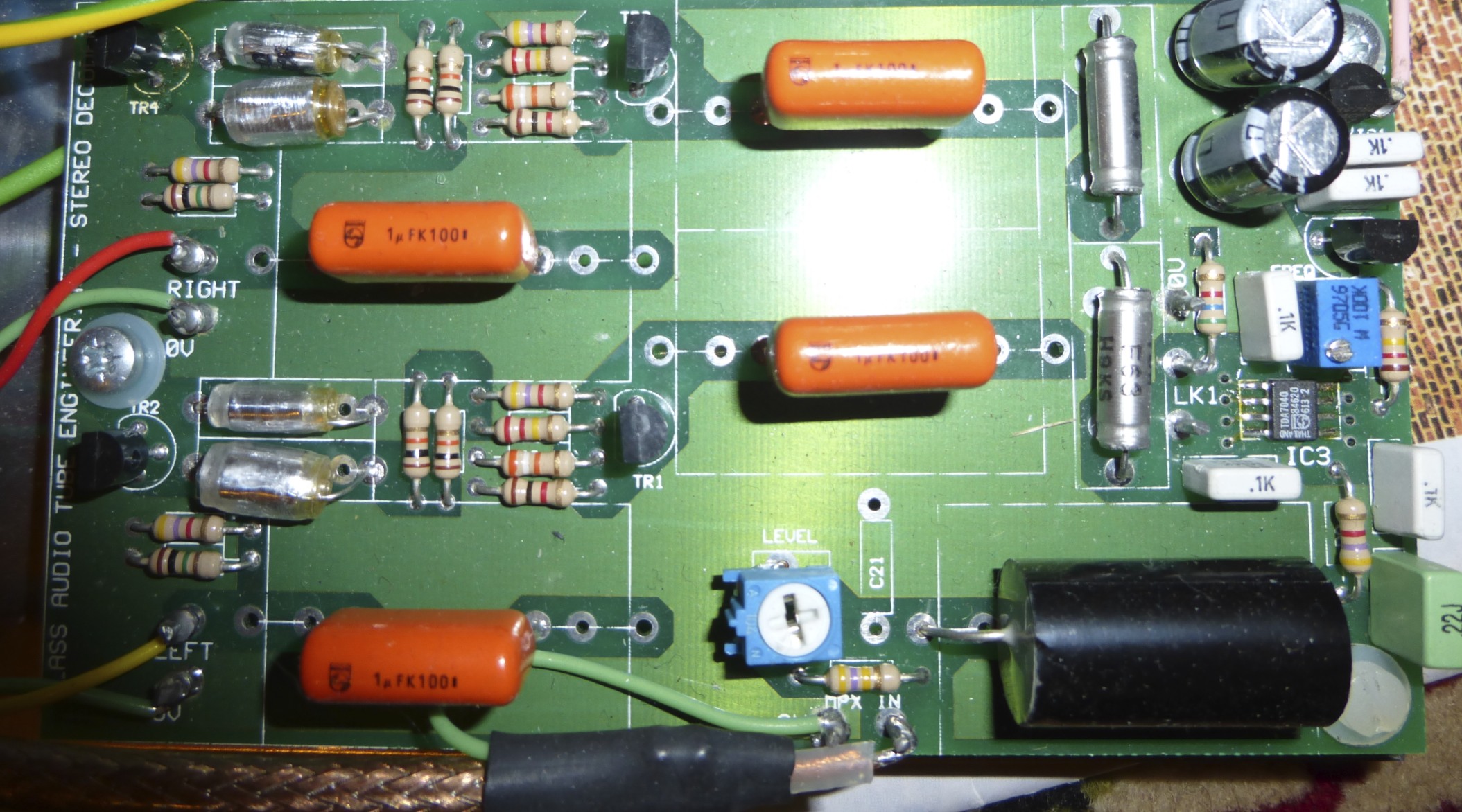

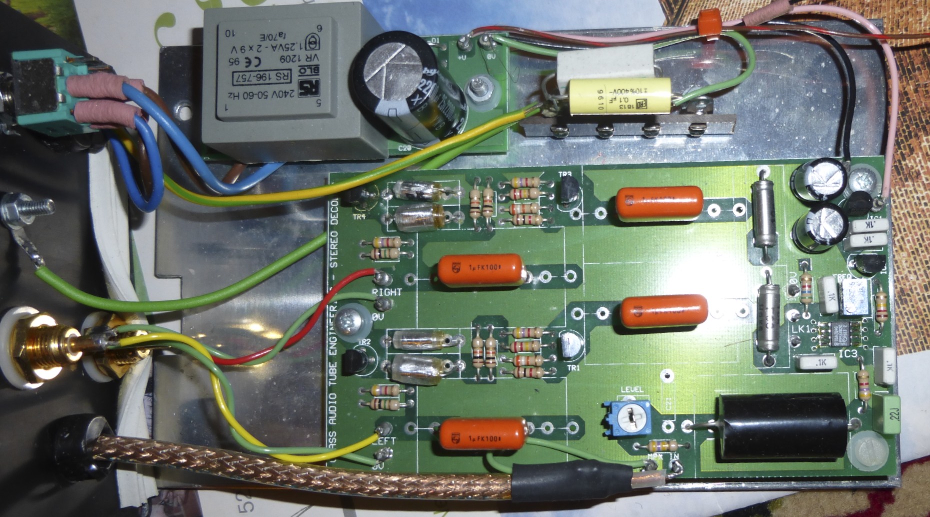

I'm looking at a Leak Trough Line 3 (mono) and a GATE (glass audio tube engineering) stereo decoder for a friend.
Basically one channel is twice the volume of the other.. there are two pots inside, one labeled LEVEL (volume) .. the other smaller FREQ (which I assumed was the separation pot but doesn't seem to make any difference to anything ?! I've returned it to its original position) any ideas??? ...
Is that one of the 'valve' decoders which actually uses an ordinary decoder chip to produce stereo, which then gets buffered (and possibly matrixed) by some valves?

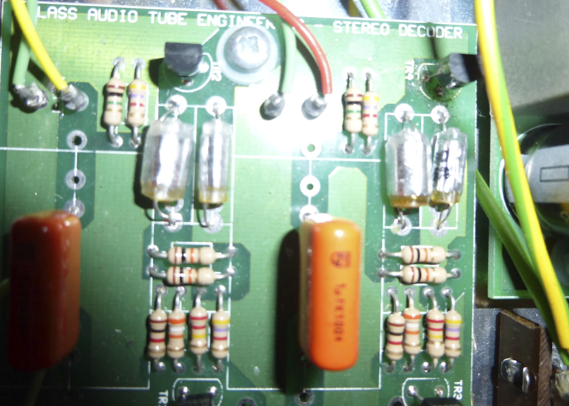

There are 4 caps/resistors/somethings (2 on each channel) which are plastic with an outer layer of foil (against interference?) which look almost custom (maybe just the foil).. when I measure resistance across them they have very different measurements: by a factor of 10!! but I could be measuring resistance of the rest of the circuit? and the difference shows a failed component somewhere else in the circuit???
these things are clear plastic with a thin layer of foil.. sausage roll style…. sound familiar to anyone?
They sound like Polystyrene capacitors. Very hard to beat for sound quality, but they are sensitive to heat (soldering iron). Replace with the same types.

Yes, the description sounds like polystyrene caps. Generally reliable, unless ruined by excess heat from poor soldering technique. Unlikely to be causing the symptom you have, but there is always a first time for everything.
You need a circuit diagram. If you can't obtain one then you will need to draw it out from the circuit. Alternatively, if you can identify the chip they used then it is a fairly safe bet that the circuit won't be much different from what is given in the chip datasheet.
By the way, the FREQ pot probably adjusts the free-running frequency of the oscillator in the PLL so that it is near a multiple of the 19kHz pilot tone. Probably 76kHz, but could be 38kHz.

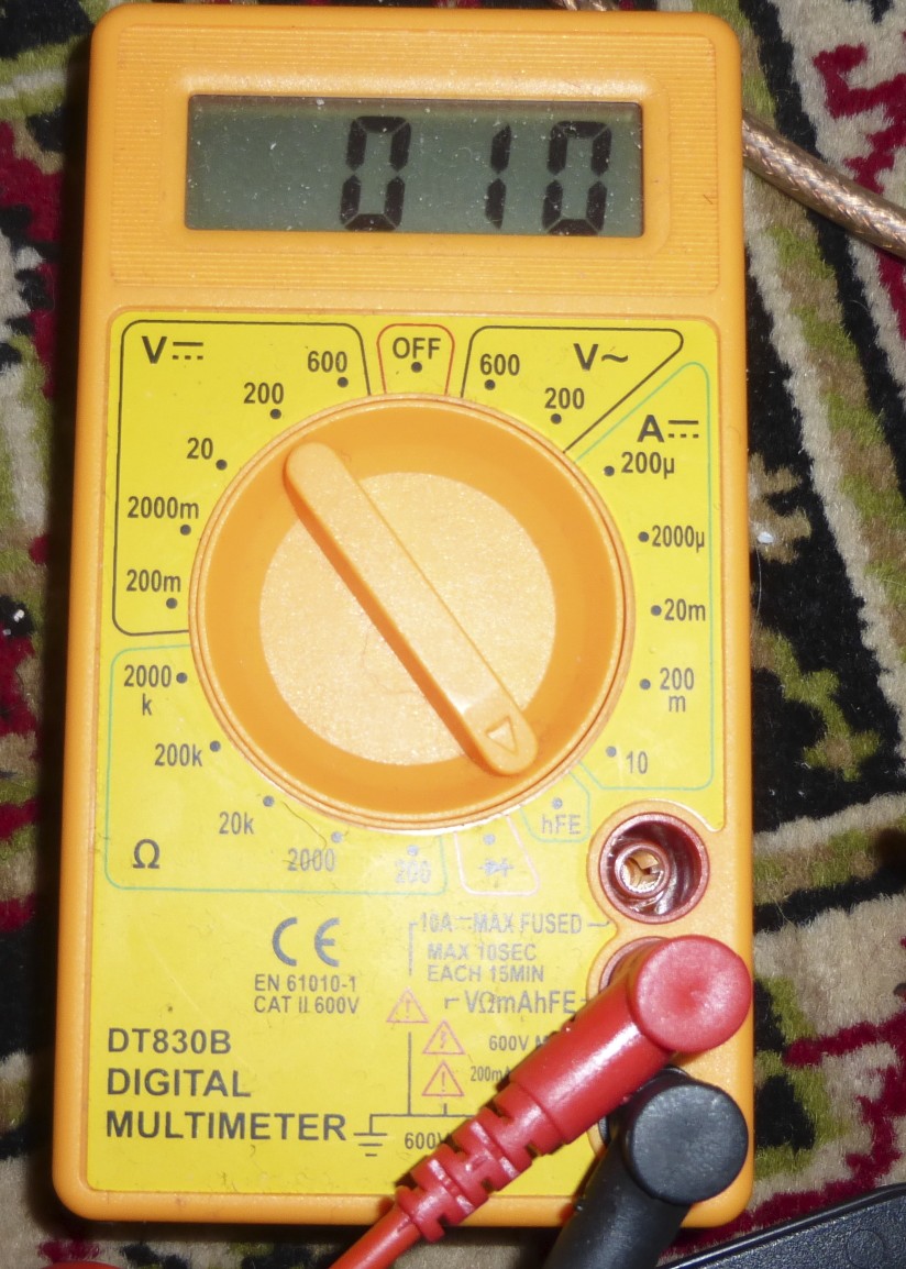

yes.. they look the same as the polystyrene caps on ebay … can I test them in situ? or would I need to demount them? I'm basically just comparing like for like in each channel ..
the smaller of the two polystyrene caps in each channel measure 010 and 063 respectively … the larger ones measure 038 and 042…
am I measuring anything worthwhile ? 😕

Hi koyaanisqatsi,
No, you aren't measuring anything useful. Those silver capacitors are polystyrene for certain. The orange ones could be polypropylene - maybe.
To get a good read on any component, it must be removed from the circuit. Tube circuits are a little different sometimes. When a tube isn't powered, it is a very small capacitor. No conductivity. So you just have to worry about other components in that direct circuit. With solid state, this assumption is no longer true.
To measure capacitance in any circuit, you want to at least lift one end to measure. That cuts down on the strays or any other funny behavior that could swamp out your results. Your meter does not appear to measure capacitance anyway. Not in any form I've seen with the DT-830 model. It appears to be set for hFE measurements.
Keep in mind that your type of meter is "approximate". It would be better if it were a needle type display to remind you that the readings are not that accurate. That's the trouble with digital meters, you tend to think they are a lot more accurate than they are in reality. I'll grant you that you're probably better than the standard 2% accuracy of a pointer type meter, but if you work out the accuracy for your reading, you might be depressed. Better meters = better readings.

I like the sound of a better MPX chip … the transformer in there is 2x9v so should be able to use one of those.
This GATE decoder got rave reviews from David Price/Hi-FiWorld magazine 25 years ago, with a cheap MPX chip and al'

Hi koyaanisqatsi,
It's a surface mount chip by the looks of it. You would very probably need a completely new board to use any other chip. The one other option would be to look at the entire lineup of stereo demodulator chips from that manufacturer. See if there is a higher performance one with the same pin-out. It's a long shot, but worth trying.
To say anything further on this I'd have to have a good look at the spec sheet. You are probably stuck with using a different IC. On the plus side, you have your pick of later, much better MPX chips. Some may even have complete plans for construction. You might also find a complete multiplex design using current parts on Ebay that you could buy, adjust the power supply, and install.
