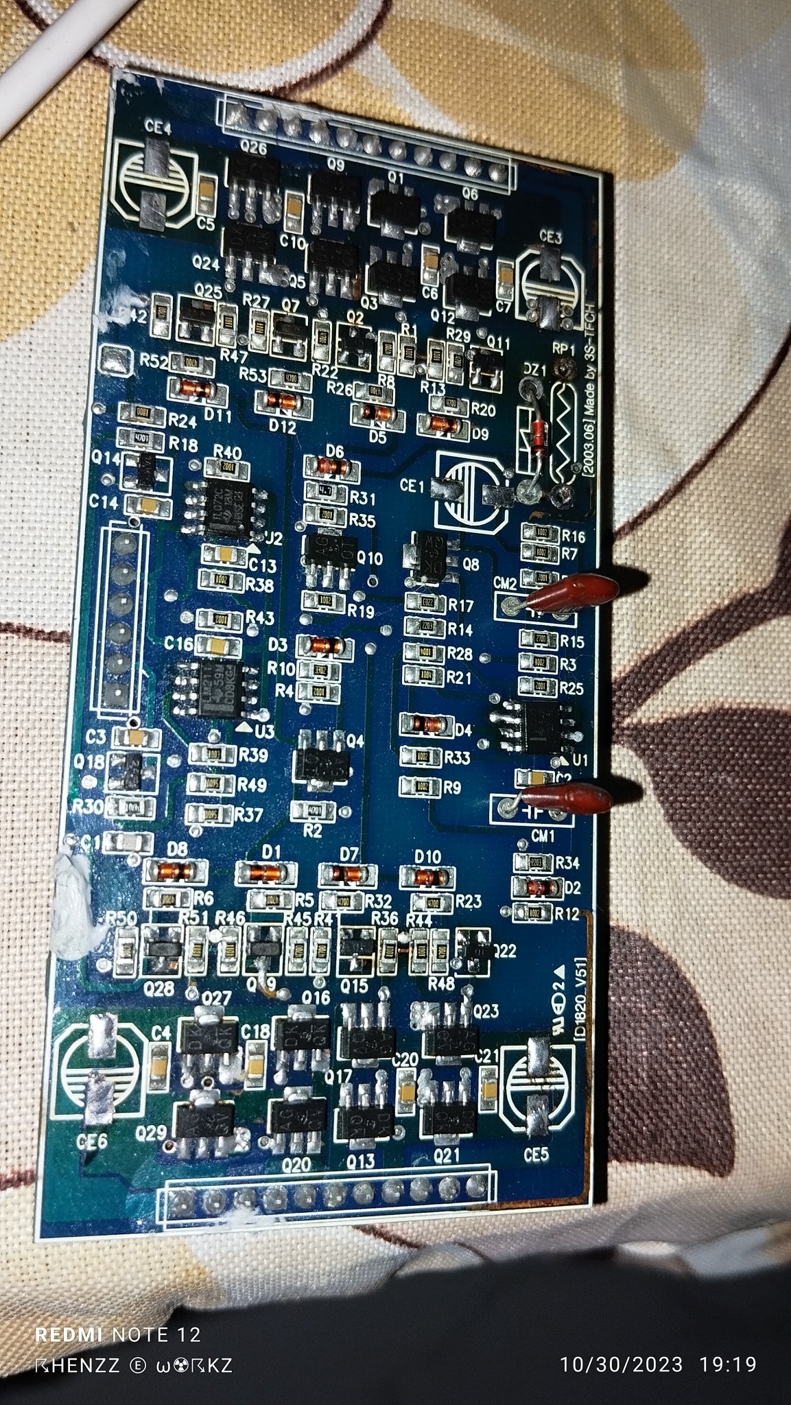

I'm not sure what you're trying to clarify in #19. Is it simply that it's a C suffix?
The LMx11 always goes in the location where pins 1 and 4 are directly connected.

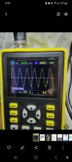

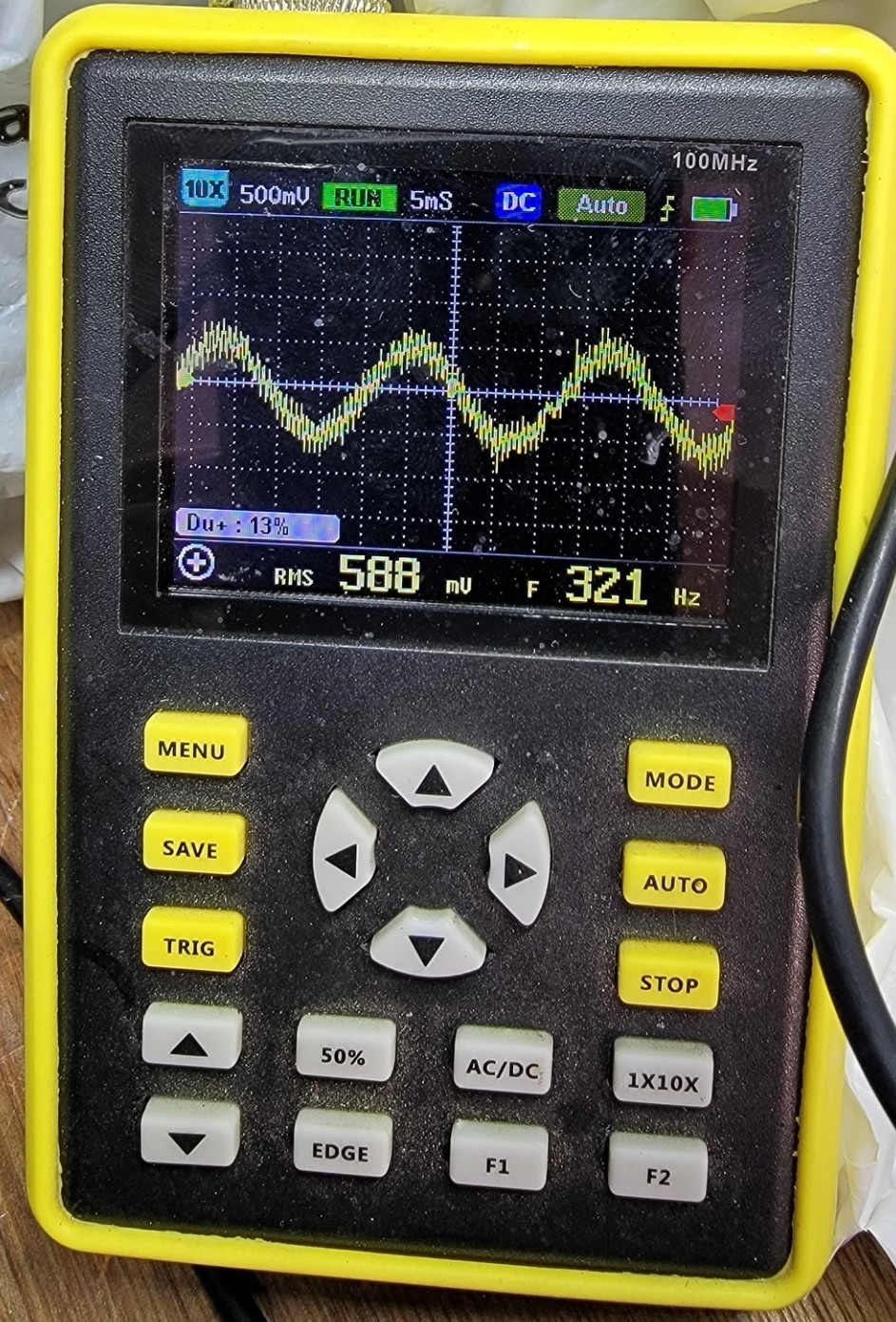

Pin 1 of the TL072 is the output but I'd expect it to swing more square. Have you already replaced it?
Is it distorted at a lower output level?
at least this is how it looks in the output terminals
