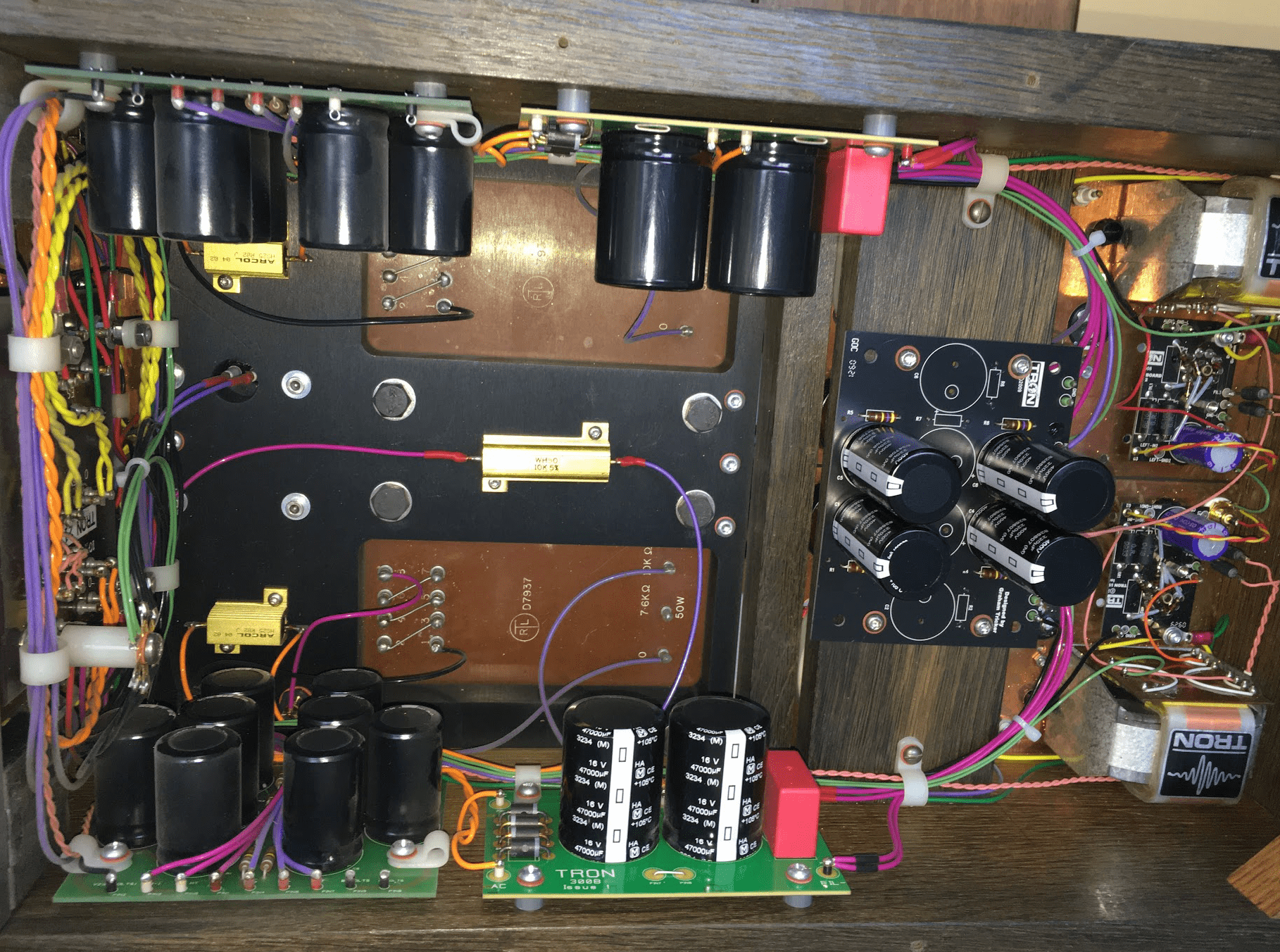

I have a HT supply to a pair (one in each channel) of 6c45 valves. I took some photos of the circuit that filters the B+ as I think the hum could be quieter, however I did not take any measurements as I thought I would be able to just work it out......but sadly my brain is not large enough to achieve this :-(
What I am very confused with is the large value of the resistors that seem to be used as part of the RC smoothing filter that I assumed was the configuration. The caps are 220uF and the resistors look like 470K?!?

I would guess, (no schematic) that the 470k resistors are bleeder resistors to drain the capacitors when power is turned off. They could also be equalizing resistors if the pairs of capacitors are in series.
Those are in parallel with the capacitors, not in series. They just drain a small amount of current.
The resistors at the base of each capacitor are across the capacitors. You can see this from the traces shown in your first picture. There is not enough detail to show whether these are simple bleeders or if the capacitors are stacked to handle higher voltage. A more complete schematic is required to assess the power supply filter function.

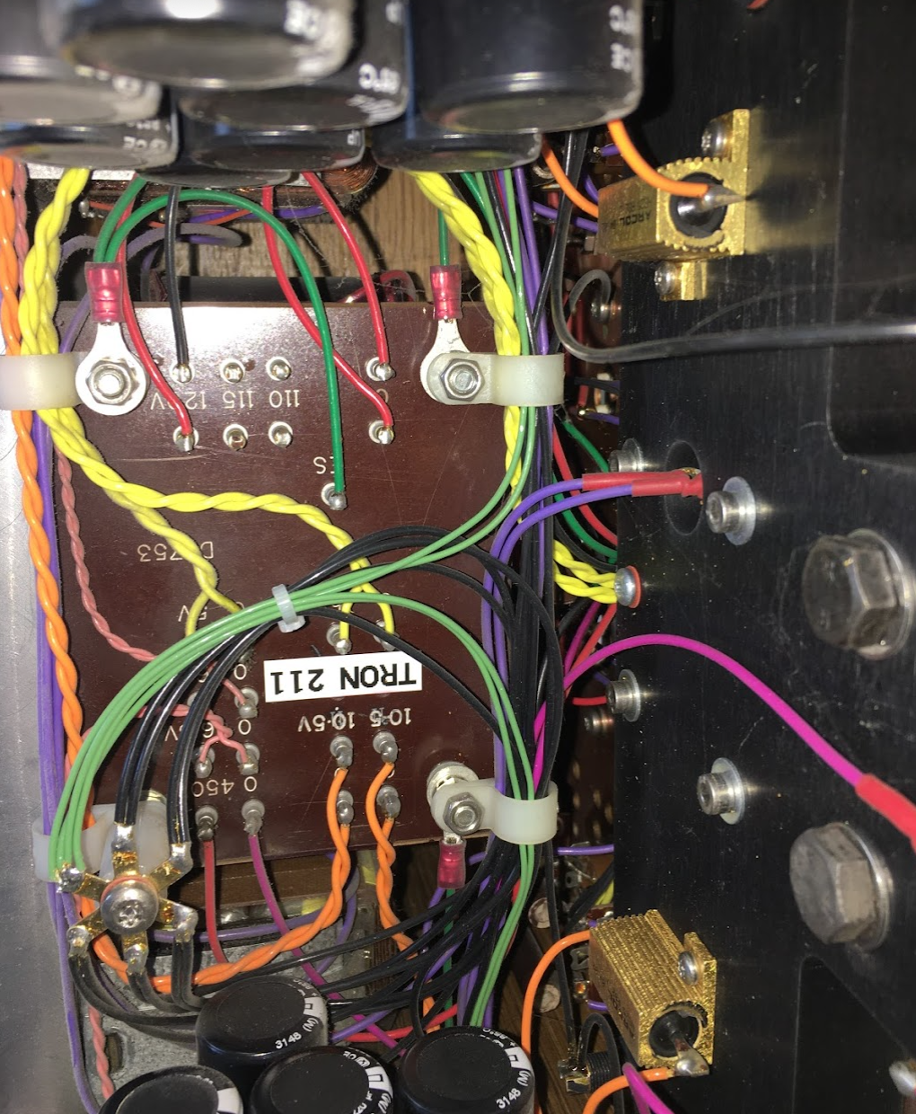

I THINK (by logic only) the supply comes from a valve rectified DC that supplies the 211 power valves at 1000V, through a voltage doubler. What's not clear to me is how this is stepped down and smoothed (although I am already a little clearer now thanks!) to provide the B+ at 138V on the 6c45 valves.
The 6c45 valves are interstate through Lundahl 1660 transformers into the 211.
I can't see any other taps from the PS transformer or diodes to supply this independently, only other diodes are for the DC heaters for the 211 valves.
See images attached. It looks like the 211 valve filtering is also via similar banks of 400V caps in series too, again probably with bleeder resistors at what looks like 910K
The first filtering comes from a Pi filter with Lundahl LL1673 10H chokes I can see hidden at the back of the PS transformer

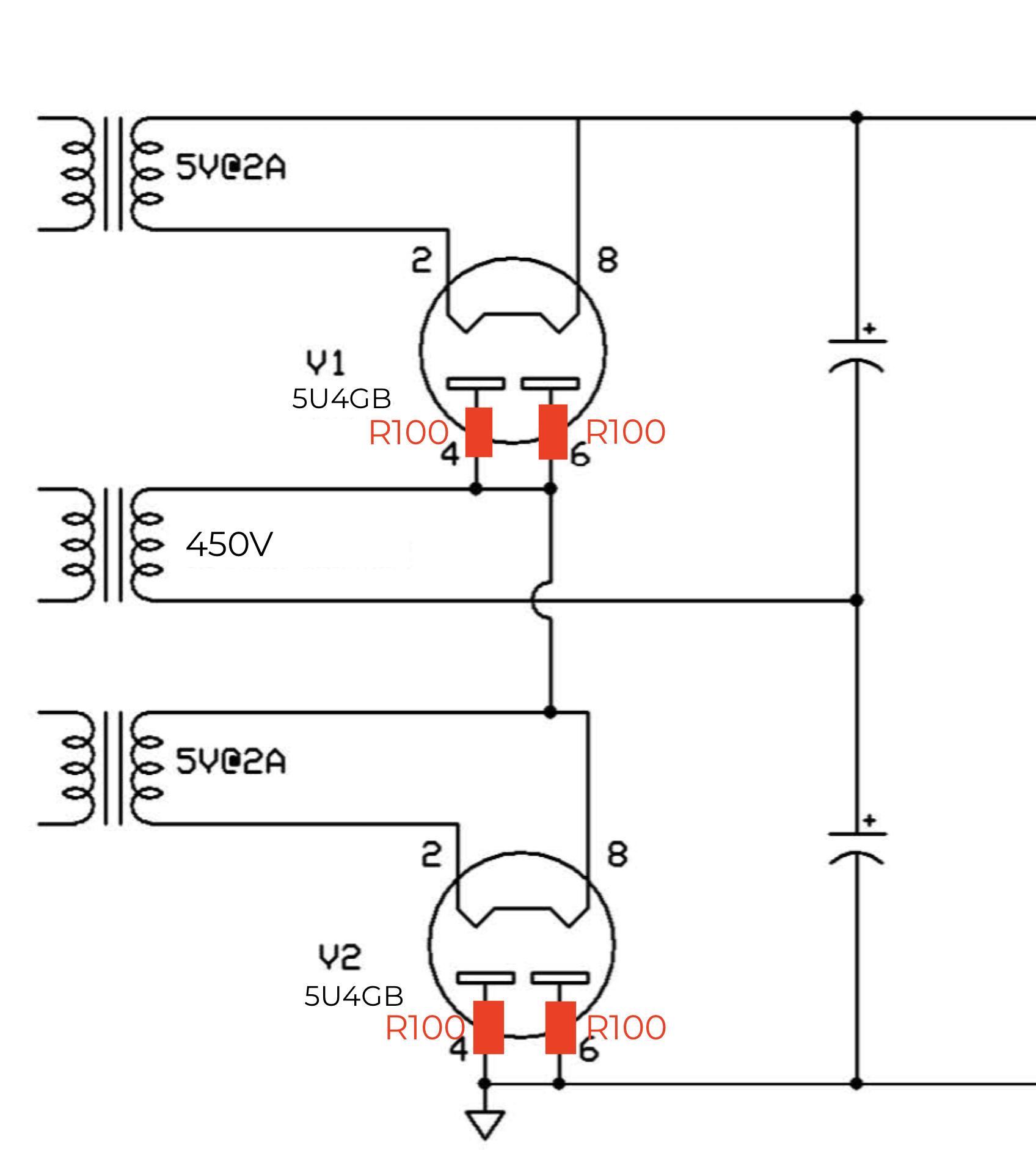

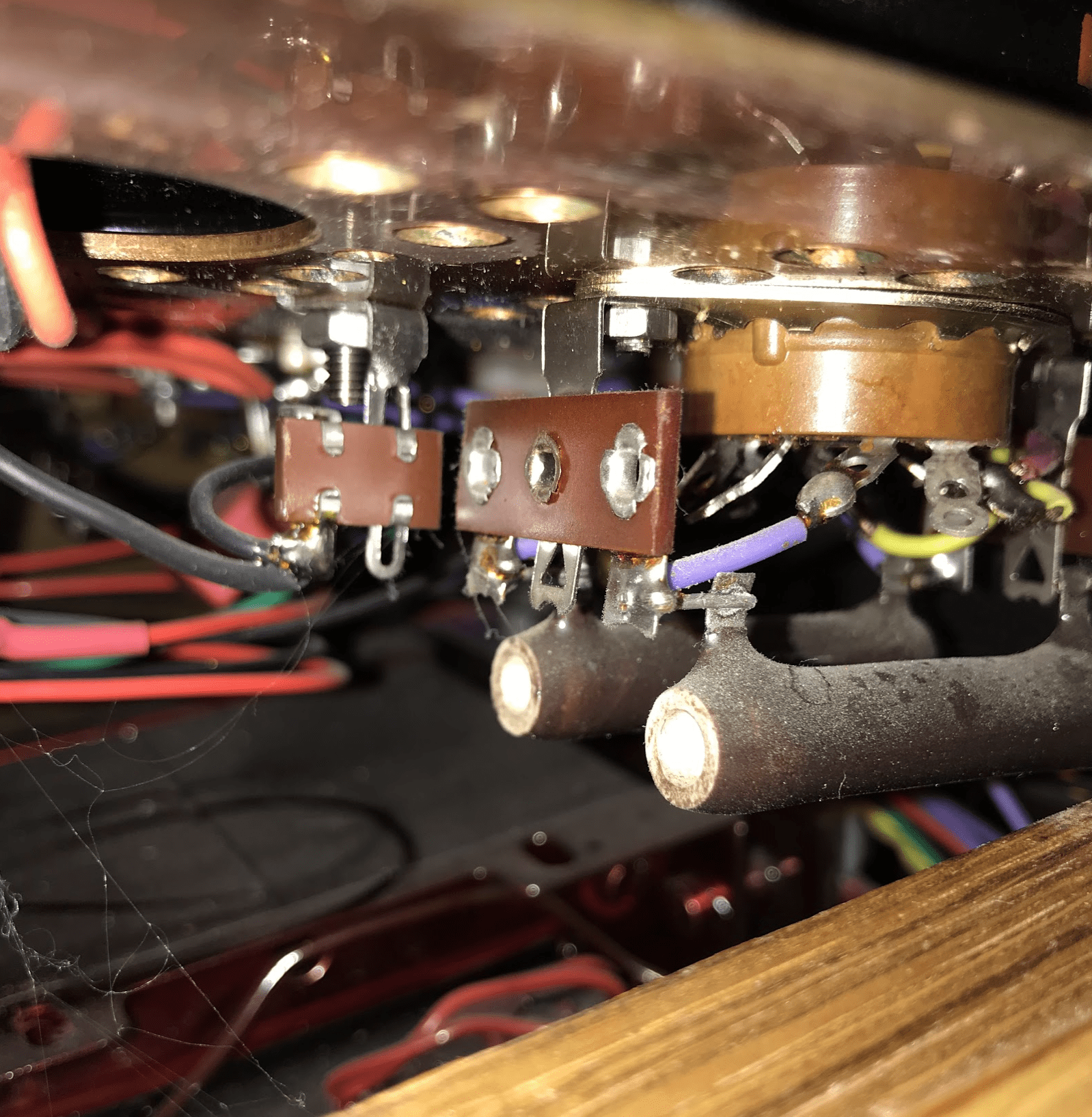

I have a voltage doubler from a 450V tap on my power supply transformer. I am tracing the circuit as much as I can, and it seems like there are four large 100R ohmite resistors as shown, any idea why? - I know there is a 100R earth lift on the amplifier, but not sure if this is part of that approach. any ideas? Thanks so much for the continued support
Simple answer:
Valve (tube) rectifiers have a specified 'anode (plate) supply resistance', if the HT secondary winding resistance is less than the spec, then it is normal to add resistors to each anode. Good practice anyway.
If the winding resistance is too low you will likely get the dreaded flashover as the rectifier warms and starts to pass current to 'empty' reservoir caps. The resistors help reduce the initial current until the caps are charged.
In your doubler configuration they also help load share the slight differences in anode current if there is a small mis-match in the 5U4.
