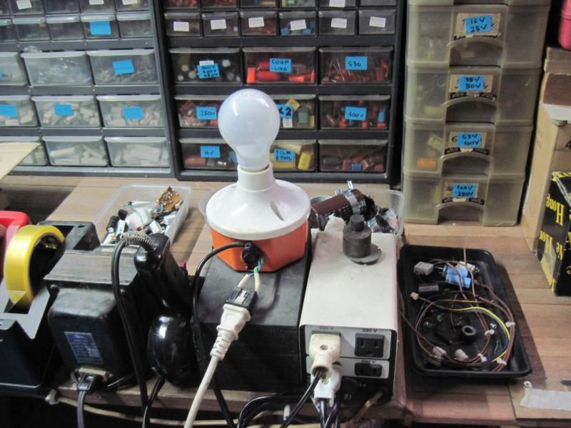

Now use the Bulb Tester to power ON and take measurements of voltage.
I agree.
That I will! I´ve been staying back from dealing with mains voltage, so I have to put one Bulb Tester together first. I had one lent to me before when I worked on a bias job for a tube amp. But now I´ll build one for myself as I go forward with the hobby.
Thanks for everyone´s input so far. I will be putting up measurements and probably some images/questions about the building of the bulb tester.
