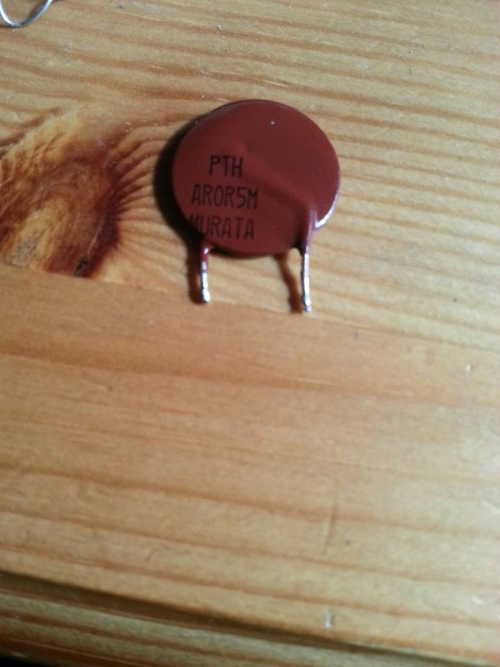

I believe this is a thermistor but I am unsure of its value, looking it up has not brought up much via google:
Writing on the component says:
PTH
AR0R5M
MURATA
Any help appreciated! :cheers:

I think it could be a "positor" which is used in place of a fuse. At currents within its operating range it has a very low resistance, when the current is exceeded the resistance rises dramatically and suddenly.
These devices have to be replaced with one of the correct characteristics for continued protection as they are chosen on voltage as well as current.
Are you sure its faulty ? Have you measured its resistance when cold.
Current Murata datasheet suggests the initial character string denotes case style, and AR means 120C. The 0R5 may be its resistance @ 25C. For specification another parameter is required linking power dissipation to temperature, I assume.
The datasheet, available for example from RS, may help selection of a suitable replacement. I don't know enough about PTC thermistors to make a suggestion.

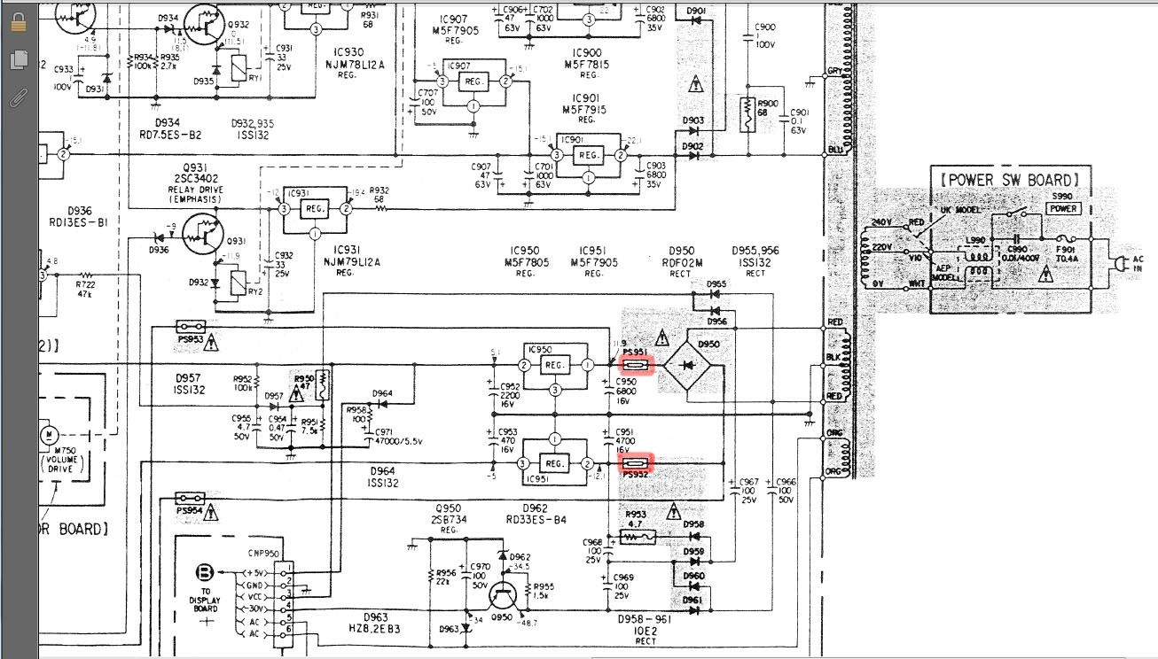

Thanks for your inputs, I cant be sure if its faulty or not but it certainly isn't letting any voltage pass through (highlighted is the two areas where these components sit) it any more than 0.3-0.5v.
The parts in the schematic are PS951 and PS952
I have attached a schematic of the area I am working on, if I am reading correctly there should be 11.9v with the power on between the feeder leg and leg 1 of IC950, currently there is no voltage.
At the Reds to Black (gnd) there is a fluctuation between 11-26 milivolts, should it be this low from a direct feed from the main traffo?
Starting to think now it might be a traffo issue, what's the best way to test?
Oranges both read 26.8v to GND.
That was where I was going wrong with the voltages lol was reading DC with the meter and not AC, I have 10.5v AC at the traffo at the red points now, 10.5v at the start of the bridge and 29.5v (00.2 reversed probes) from the in gate to the out gate , this is with the traffo still in place, is this a normal reading?
I have also noticed that component Q950 is very warm to the touch?

They are positors or polyswitches as they are sometimes called.
Remember the transformer is AC so set your meter correctly. Should be straightforward to determine the problem. If any of the other rails are present then the tranny is probably OK.
Its either an OC tranny or a short on a rail (which could include the bridge).
Administrator
Joined 2007
Posted together :)
Measure the output of those two regs. You should have +5 and - 5 volts. If you haven't then measure the voltage at the input to the regs. Should be at least + 12 and - 12. If that's low then measure the voltage at the other side of the positor. If thats high then you most likely have either a faulty regulator (they do fail) or a component within the unit drawing excess current and tripping the positor.
