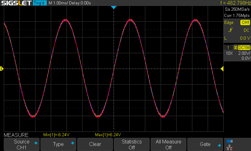

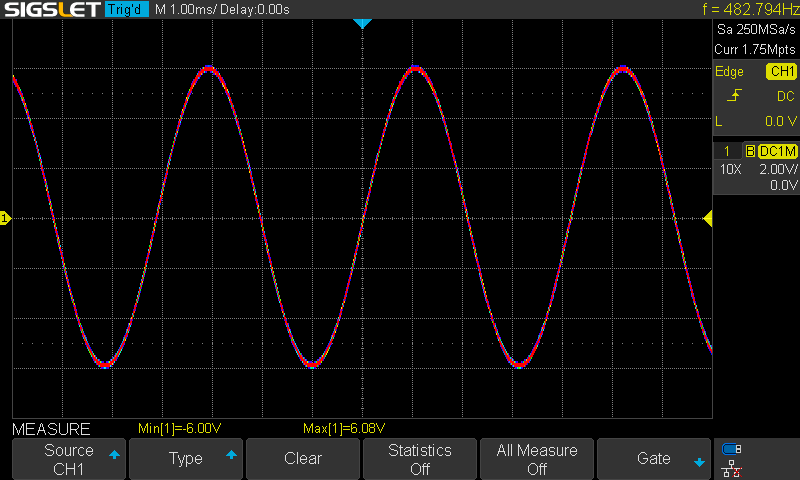

Got the courage to pluck this satan's amp out of its corner and give it another go. I used it to power the powerslab in my test jig at full voltage and as expected it will not go into protect even at clipping. So I put it back into the 909 using the silpads (the white goo is too yucky to even contemplate) I used with my test jig. Which worked very well. But all the same, just slightly over 1 W on both channels at engaging the speaker relays it conks out in 3 s:
in protect:
You can see the amplitude is slightly less in protect because of the resistance between the powerslab output and the feedback point to the AN7062 (R407). The DC offset is a minimal 28 mV, way too low to trigger the DC protect circuit. Why it gets triggered anyway as soon as I connect a load to the speaker terminals is a total mystery. I'm even thinking of kludging together a TA7318-based protection circuit and use that instead. I've run out of inspiration to try to find the cause of this satanic behavior. I scoped every pin on the powerslab and they all behave nominal. As far as can be gleaned from the minimal documentation. As in: non-existent. So, frustrating as it is I'm afraid I have to admit defeat and go with the protect kludge. I will refuse to take in any future Technics repair. I now hate the stuff with a vengeance...
in protect:

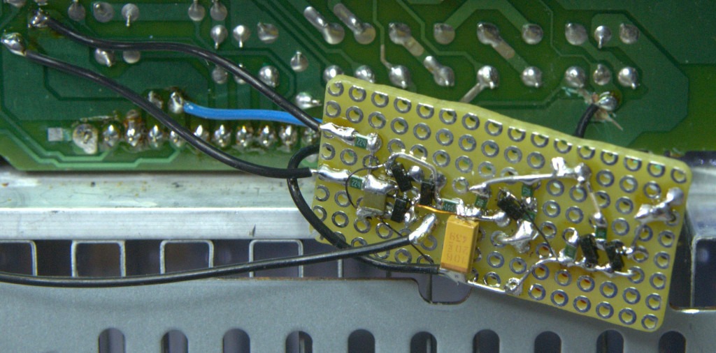

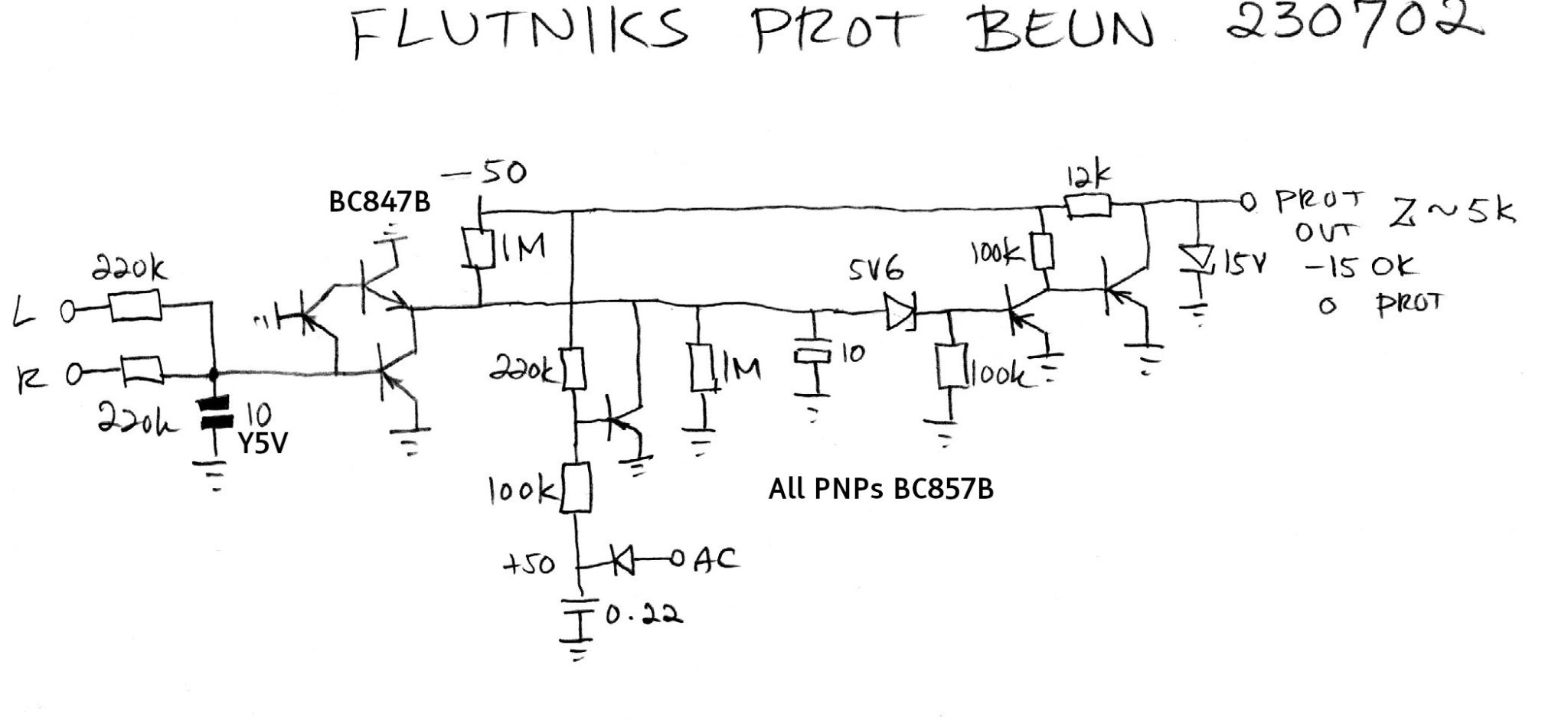

But I've solved it. I built the ugly kludge and it works like a charm. Poweron delay, poweroff immediately. DC detect at 2 V. The protect signal from the powerslab is ignored and is replaced by the output of the kludge:
I need a specially designed (LTSpice!) circuit because the protect circuitry runs off the negative rail. Fun fact: "beun" is Dutch for "kludge". "Flut" is something of low quality.
