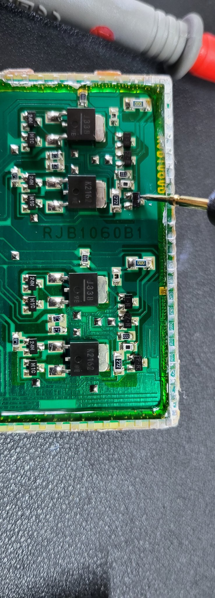

Got the courage to pluck this satan's amp out of its corner and give it another go. I used it to power the powerslab in my test jig at full voltage and as expected it will not go into protect even at clipping. So I put it back into the 909 using the silpads (the white goo is too yucky to even contemplate) I used with my test jig. Which worked very well. But all the same, just slightly over 1 W on both channels at engaging the speaker relays it conks out in 3 s:
in protect:
You can see the amplitude is slightly less in protect because of the resistance between the powerslab output and the feedback point to the AN7062 (R407). The DC offset is a minimal 28 mV, way too low to trigger the DC protect circuit. Why it gets triggered anyway as soon as I connect a load to the speaker terminals is a total mystery. I'm even thinking of kludging together a TA7318-based protection circuit and use that instead. I've run out of inspiration to try to find the cause of this satanic behavior. I scoped every pin on the powerslab and they all behave nominal. As far as can be gleaned from the minimal documentation. As in: non-existent. So, frustrating as it is I'm afraid I have to admit defeat and go with the protect kludge. I will refuse to take in any future Technics repair. I now hate the stuff with a vengeance...

That is correct. I did not try but I think I could go until clipping unless I load the output. It conks out at a little over 1 W. The protect circuit inside the powerslab behaves if I have it in my test jig but goes into protect if I run it in the SE-A909S. The only reason I can think of is some feature inside the ersatz powerslab that misbehaves with the awkward concept of the output stage. There is no indication whatsoever of protect activity on the outside of the powerslab on any of its pins.
But I've solved it. I built the ugly kludge and it works like a charm. Poweron delay, poweroff immediately. DC detect at 2 V. The protect signal from the powerslab is ignored and is replaced by the output of the kludge:
I need a specially designed (LTSpice!) circuit because the protect circuitry runs off the negative rail. Fun fact: "beun" is Dutch for "kludge". "Flut" is something of low quality.

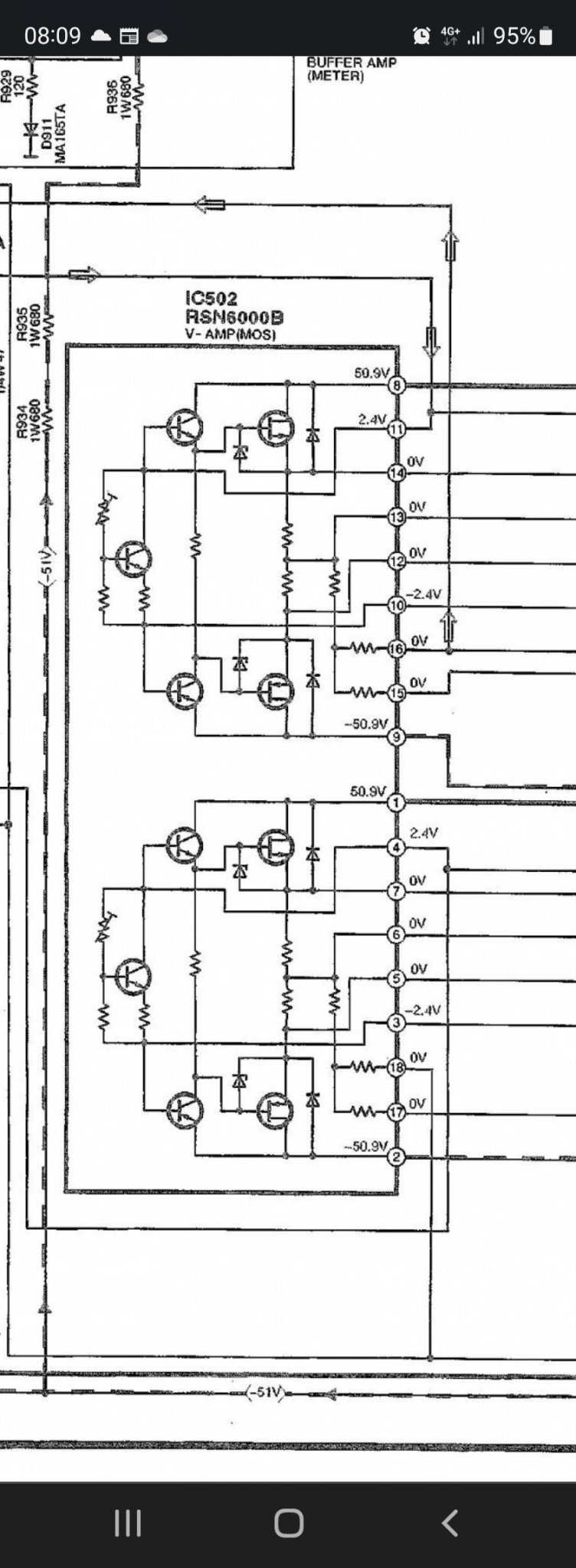

I found this thread when working on an issue with an SE-A900S (M2) which looks to be quite similar. When reading through it, I understand the RSN6000 was apparently fixed and worked, but the amp (A909, which is almost identical to the 900) went into protection mode at higher volume after some time (3s).
I was wondering if the amplifier at that time had a working fan connected. If not, that may explain why it kicked-off at higher volume (when it actually should start spinning - it's voltage controlled).

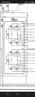

The RSN6000B I am working on seems at least to have a broken 2.2Ohm resistor. At least, one of them can't be measured from outside while 3 others are present (even if the drawing does not show a direct connection to the pins). Will remove the RSN and check it's value ..
@Regenpak and to all others who did follow or will find this thread, today I had a chance to replace the the 2.2Ohm SMD resistor on the RSN6000B module - the SE-900A M2 is back in live! I do not know what happend, I am not the owner, but my best guess is that the SVI module blew, and this had an impact on the RSN. The former owner may have replaced the SVI but gave up with the distorted sound.
