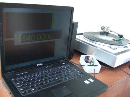

Have been very busy with tuning lately but need lots more time. I only concentrate on the deck at this moment. The arm is from later concern.
There have been lots of try and error and only a few were real improvements. I manage to get out a good controlled bass an mid but the rumble still is there.
The bearing puzzles me. Would like to see how the famous greasebearing from the Garrard 301 looks like. It is possible that some of the rumble is coming through (or from) the bearing 😕
Need much more time before I am ready to compare it with a Linn or other fine TT’s. But I still believe in the zero100s. The idler drive gives an amount of control that suprised me.
So be continued, first a month holiday, no audio no internet.

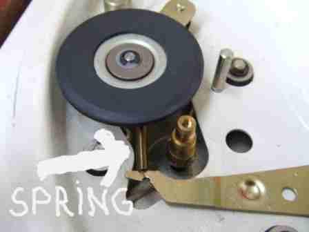

A lot off experimenting has been done. In the following reports the most successful results.
First the bass, I found the bass from the Zero 100S not as tight and controlled as I hoped for. An idler wheel construction must be able to give a fine and controlled base!!
I noticed that when starting the motor there was a vibration and it is visible on the strobe that it takes a while (30 seconds) to run the platter on speed and to stop the vibration. The same happened when cleaning the record with a cleaning brush while turning, the speed slows quickly and a vibration occurs.
My conclusion: there isn’t enough grip from the idler wheel with the platter. Cleaning the idler wheel and the platter didn’t give any improvement. It took a little while but I managed to buy I new idler wheel (rumble sale for 2,50 euro!). After replacing the wheel the problems didn’t disappear. So it must be something else. The only thing left was a lack of force from the tiny spring. I shortened it 3 windings.
The result was a firm grip from the idler wheel. And the sound…. a much more and tighter bass.

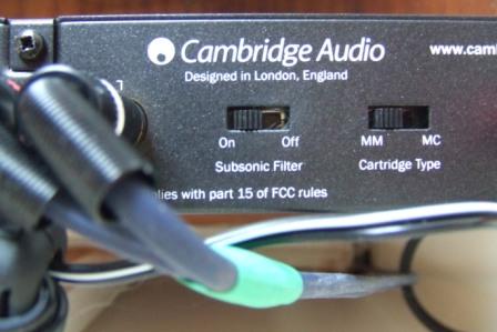

As I told before for the rumble I am going to cheat a little. I changed my phono amp from a Cambridge audio 540p to a 640P model. The Cambridge 640P is a more expensive but still affordable, the 640P offers mm and mc stage, both uses discrete transistors, single ended class A with perfect RIAA equalization.
But the 640P features a subsonic filter!.
This filter cuts out very low frequency rumble and does this without changing the low quality (at least almost not noticeable by me).

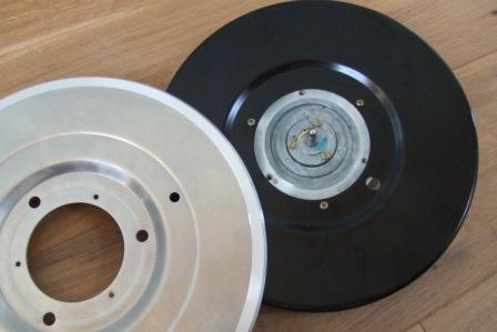

The rumble problem 3
Solution 2 is cheating but it works. But this one solves its problem almost at the source. The platter of the zero is build with two parts, the black inner platter from steel which is driven by the idler wheel and directly screwed on top of this platter a aluminum platter with rubber mat.
I isolated the two platters from each other with double sided foam tape. I use two kinds a black more firm rubber type (in a car store to stick side strips on a car) and a white foamy kind (just a plane double side tape.
And now you can adjust the aluminum platter exactly by turning the 3 screws. I isolated the screws also from vibration by using a thin piece of round foam.
Result a rumble reduction without quality loss of sound.
Sorry no picture of this solution. Coming soon I hope.
Conclusions after the changes in previous post.
1. After improving the spring force there is a much better base fundament. Now only a better cartridge can improve it. I think I am almost on the limit from the motor and idler construction. The cartridge is now the weakest link.
2. The cartridge holder is a weak construction. Clean it and be sure that it is firm in the arm holder. I think this is one of the reasons (or main reason) why the arm is so underappreciated.
3. The rumble is reduced a lot but still there is some. Only noticeable at silent music parts. Probable the platterbearing needs more attention.
To be continued.

The problem with idler drives is not the idler (you are lucky if it doesn't have a flat spot) so much as motor vibration coming up through the deck. Garrard used good motor mounts and they minimized the vibration, but these are AC motors. It takes an expensive balance job to calm them down. Do to the modulating field I don't think they can be made motionless like a DC motor. I do recall a Telefunken AC motor that was so smooth that I thought it was bad until I touched the shaft and found that it was turning.
Put a plastic coke top on the deck with the motor running, but in neutral (idler not touching the platter). Put the stylus on the coke top. This will show you how much vibration is coming through the deck.
